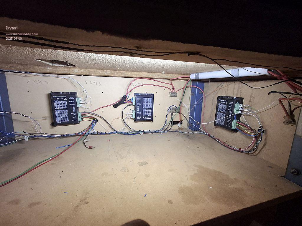

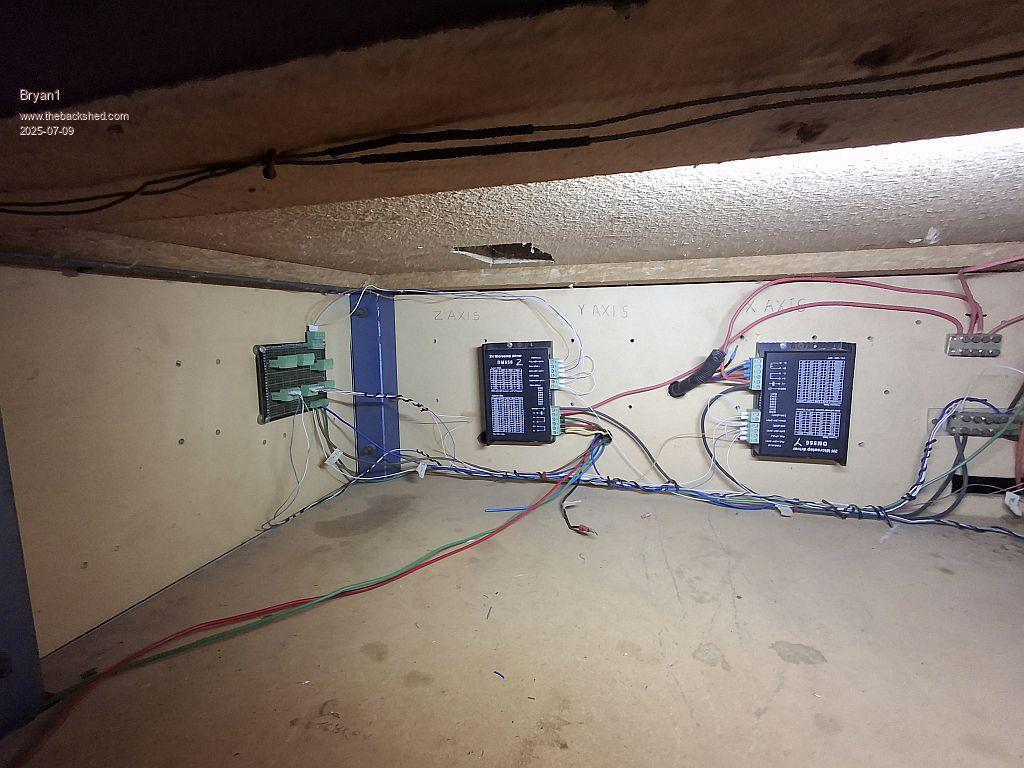

Posted: 06:58am 09 Jul 2025
Ok got it all wired up and all checked so the next step is setting up the 2040.
Now on the left picture one can see that green board thats where all the wires go and put separate green lugs for the output.
The red and green wires are for the spindle motor and the blue and black are 2 spare inputs from the motor connection so a trace can be later made and used.
I did have the right termination fittings for the cat6 wire and each DM556 has been pulled down to earth so a high signal will be needed. Did this before with the test so it shouldn't be a problem.

Now would be a good time to check your fire extinguisher
Bryan1
Joined: 22/02/2006
Posts: 2298
Posted: 08:08am 09 Jul 2025
  PhenixRising said  Now would be a good time to check your fire extinguisher
That wood bench has been on there since day 1 of my CNC mate   Now where the X-axis 556 is I did put in a new side for it.
