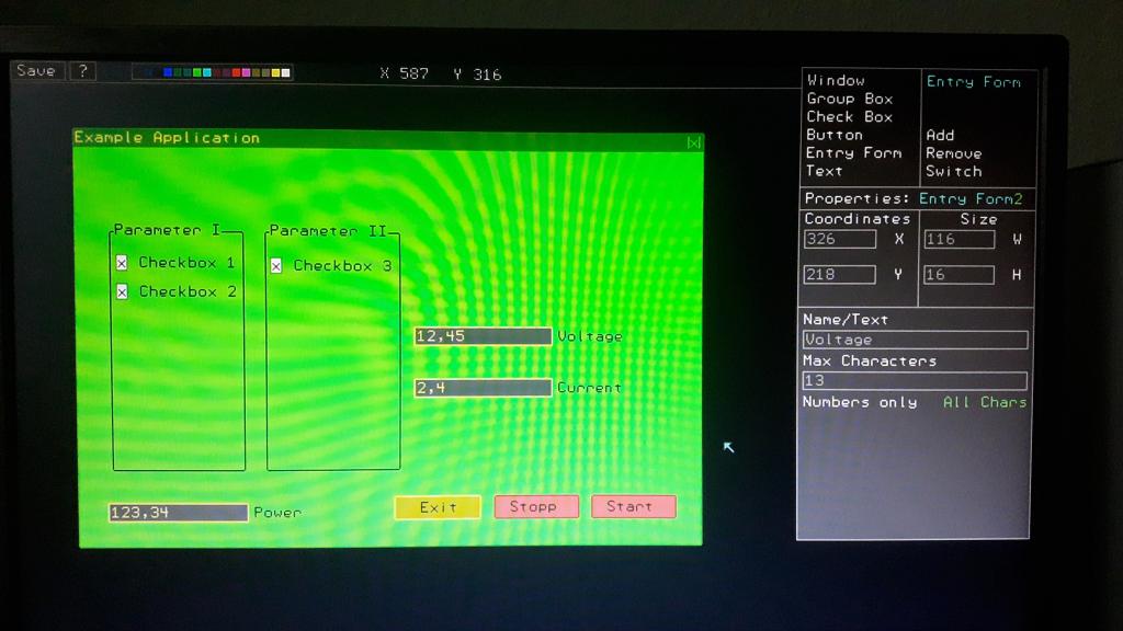

Update:
- Added selection between Numbers only / All Chars (Entry Form)
Now supports these resolutions so more users can test or play with, if they want:
- 848x480 (Widescreen)   <- as seen on the image below
- 720x400 (Widescreen)
- 800x600 4:3
- 640x480 4:3
- small bugfixes
File:
gui_editor_b22a.zip
Greetings
Daniel

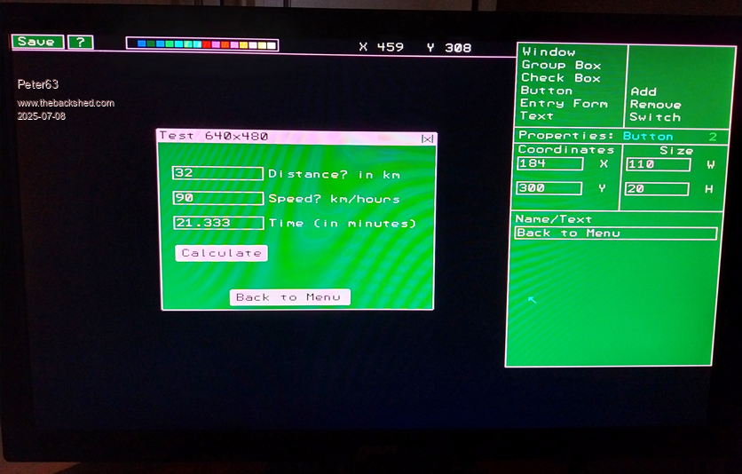

Peter63
Joined: 28/07/2017
Location: Sweden
Posts: 220
Posted: 03:52am 08 Jul 2025
Tested resolution 640x480:
/Peter63

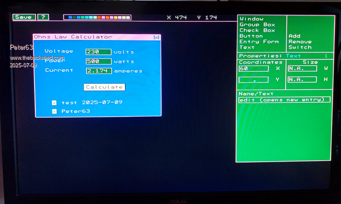

Peter63
Joined: 28/07/2017
Location: Sweden
Posts: 220
Posted: 03:53am 09 Jul 2025
/Peter63

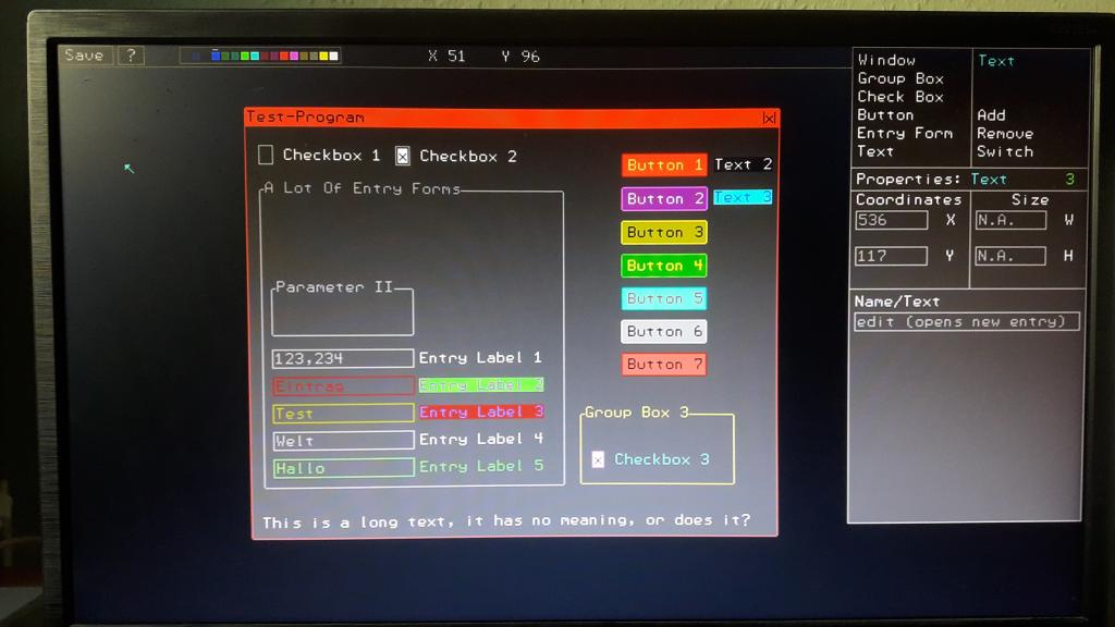

Update:
program size is getting bigger and bigger, so now Library usage is needed - but this is easier than I initially thought (first time for me using this feature).
Save routine is completly excluded in a sub which lives in the Library.
More buttons, more fun:
Gui Editor.zip
Greetings
Daniel

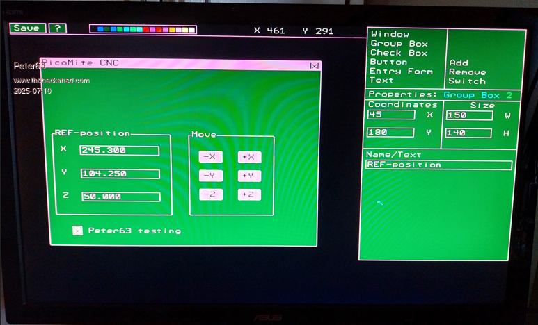

Peter63.
thank you a lot for the testing! It is funny I had the same in mind you are showing in your test with your buttons, but reached the out of memory error. Now this problems is solved with library and I will allow up to 12 buttons, this way you can integrate a complete Numblock 0,1,2,3,4,5,6,7,8,9 and for example ENTER etc.
Dropdown menu would be nice, too. I am trying my best to implement one.
