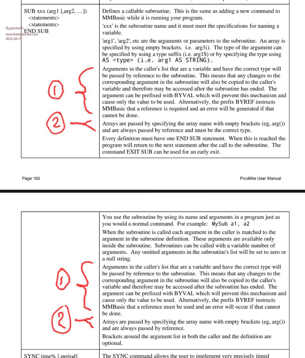

Subs, pages 160-161
1. Seems Duplicated paragrapgh.
2. Seems Duplicated but edited.
If duplications removed, TEMPR START would not be split across pages 161-162 as it is difficult to follow read.

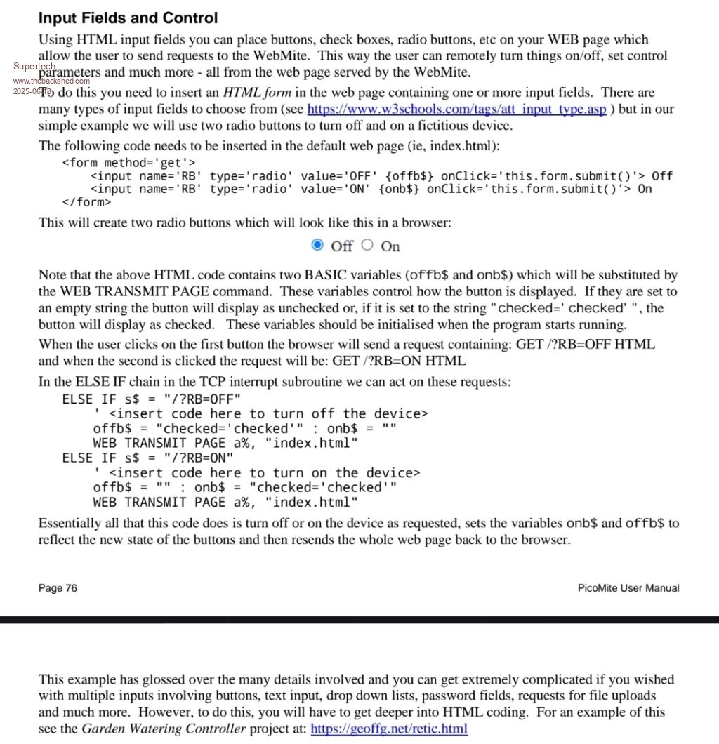

Page 76, as still in all Webmite manuals to date,
THEN this is still missing a couple of them.....hint, hint...

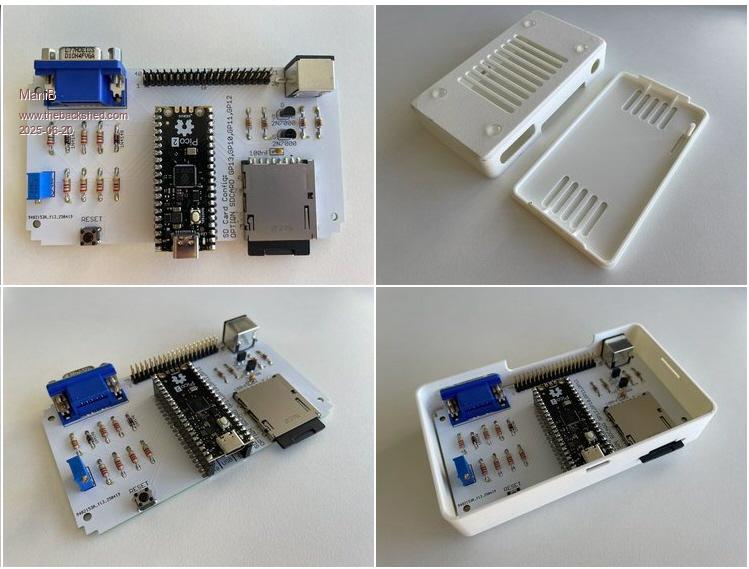

if you want something more solid than your breadboard solution, I recommend the PicoMiteVGA Construction Pack:
https://geoffg.net/Downloads/picomite/PicoMiteVGA_Construction_Pack.zip

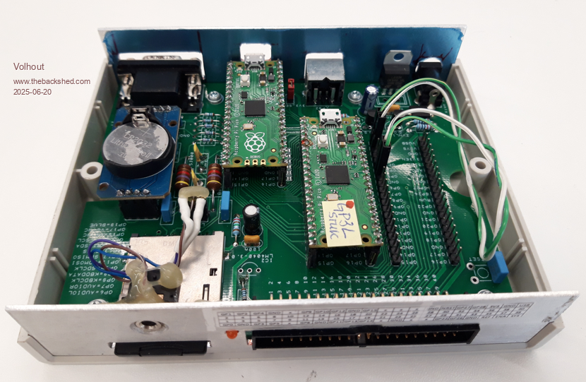

Hi ManiB,
Yes, that is the grand-dad of all the stand alone pico basic computers.
There is also a VGA design 2, where audio is added, and the optional RTC (and breadboarding footprints). I started, and still love, VGA design 2.
In this photo a breadboard footprint is used for a second pico, that runs a chess program. The main pico is for display of the chess board, and keyboard interface.
The "breadboard sockets" are very nice for playing with interfaces (like the SSTV interface, the MORSE interface, etc...).
Note that VGA design 2 is just an extended VGA design 1. Just RTC and Audio added (and the breadboard footprints).
If you desire to retro-fit audio and RTC in VGA design 1 added later on, Peter made a piggy-back board for that, I think the design files are on this forum.

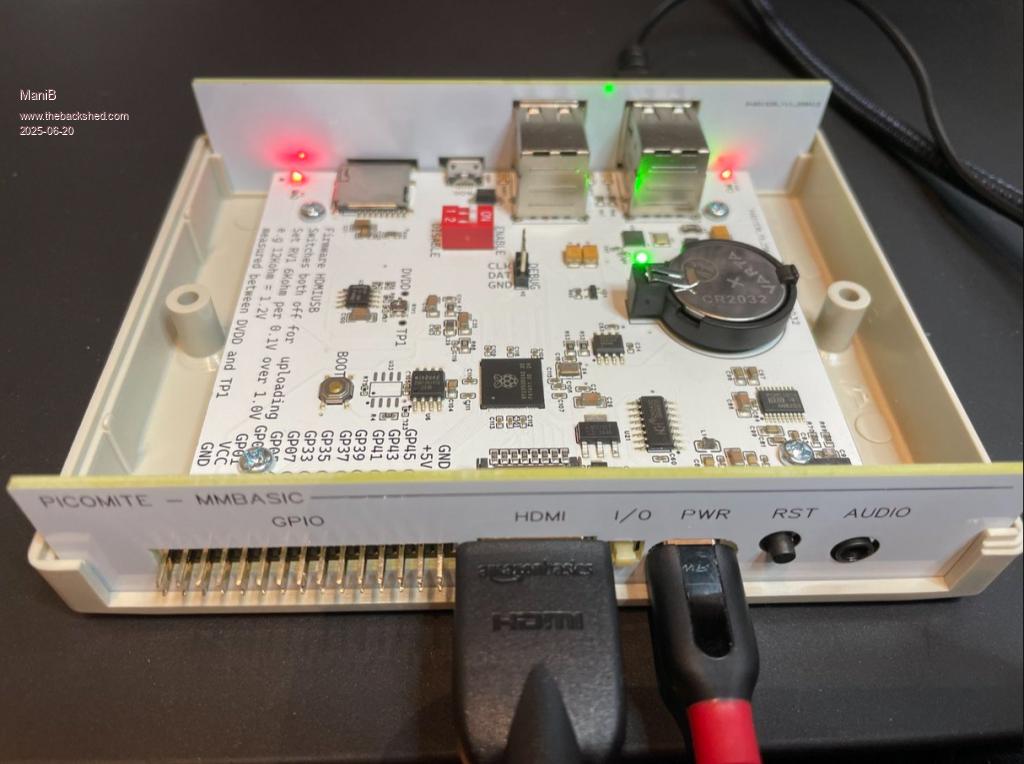

Yes Volhout, i know ;)
and this is the latest refernce board from Peter:

  ManiB said  Yes Volhout, i know ;)
Where are the details for this ?. I'd love something full featured that can fit in a small case with keyboard and touch screen plus lots of free i/o, space for several additional modules, holes for mounting a heatsink on the processor and dual 18650 batteries !
ManiB
Joined: 12/10/2019
Posts: 193
Posted: 08:07pm 21 Jun 2025
Here: https://www.thebackshed.com/forum/ViewTopic.php?TID=17301&P=11#236097
And here: https://geoffg.net/picomitevga.html
Edited 2025-06-22 06:16 by ManiB
