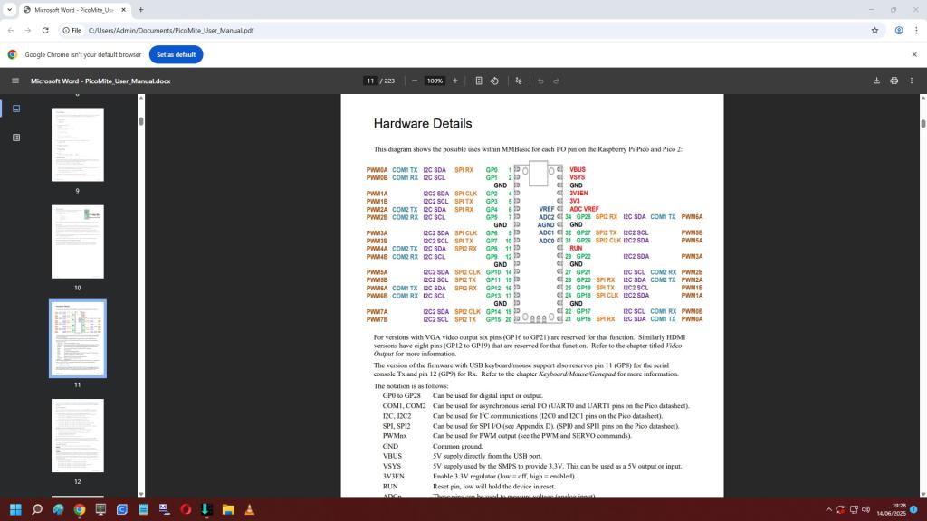

Here appendix A from Manual which exactly describes your problem:
And the following command for the second channel (referred to as COM2):
SETPIN rx, tx, COM2
Valid pins are
RX:
GP5, GP9 or GP21
TX:
GP4, GP8 or GP20
So in your case:
Option serial console gp21,gp20
for default 115200
Edited 2025-06-16 15:04 by dddns
