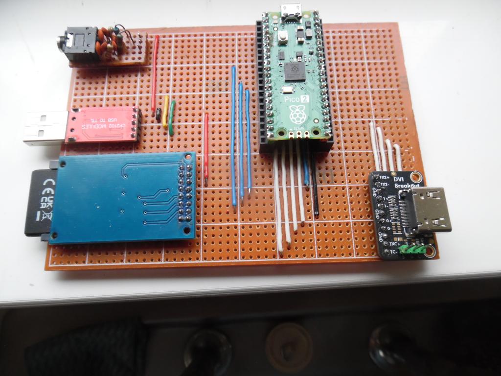

strange as I got another pico2 usb hdmi but on vero and defaults to 115200.
note it's v6,00.02b0 and I can't find the download.
it has OPTION CPUSPEED (KHz) 315000 but that's not allowed with hdmi now and the same graphic program seems slower on olimex

I'll order new usb to ttl boards... usb c ones
my hdmi usb and vga usb boards are powered from the usb to ttl adapter no probs.

Mick your right I guess but I'm as vero as you are pcb
as not used olimex I think I broke the usb to ttl by using it for powering olimex, forgot it needed own power

Mick the 3.3v and 5v are not to be used but I've used them no prob so dunno.
on vero I used a hdmi breakout with smd resistors. wiring vga not hard but hdmi. l8r
same hdmi breakout?
Edited 2025-05-26 04:19 by stanleyella
