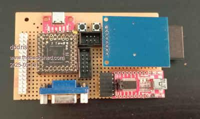

Hello g0730n,
if you want to use it for for programs doing graphical stuff I would consider using a RP2350 because of the larger amount of RAM. On a RP2040 a frame buffer with 16 colors is only possible in mode 2 . And for a RP2350 @800x600 in mode 3 only, if you have PSRAM as well.
If you would have a question on freecad, I'll try my best! Fusion is no solution for me as it only runs on windows, is commercial and urges to use its cloud.
@stan: many thanks! As soon as I can I will try one.

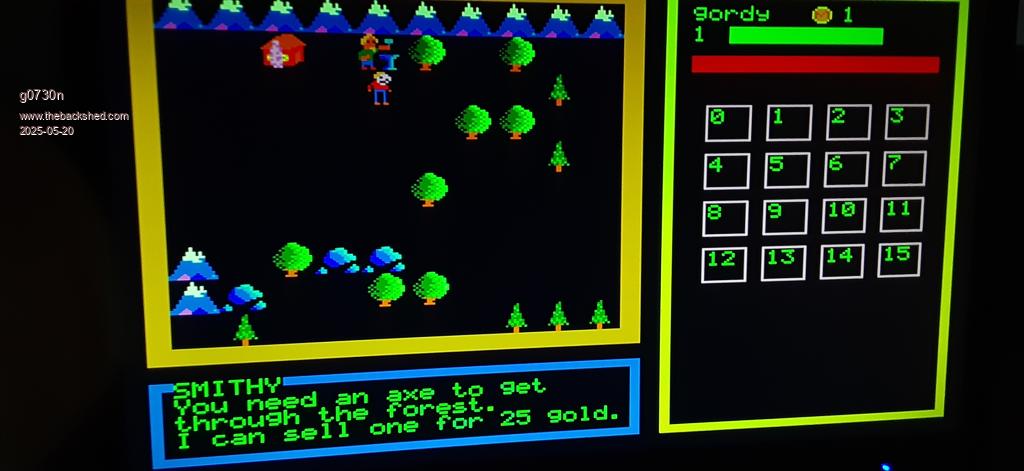

What is that game you are showing on the VGA monitor 1 page back. With the house, and coloured blocks.?

volhout, the case I printed has some venting, and I intentionally added some slits right next to sensor to allow air to flow over it. Seems to be about the same as without a case so I think its working  Also the game on first page was the beginning stages of the game I am working on now. In that photo thats about all there was just collision with blocks and move with keyboard. I will take a photo quick of what It's looking like now.
stanley: veecad looks pretty cool, I think I'll try it out next time I do something on a protoboard. Would probably help a lot! When I lay something out on a protoboard I usually arrange the large components for a while just sitting on the board to try to find the optimal spots, but if theres enough wires it just ends up getting crazy fast!
lizby thanks for the Maxicalc link, I was able to download the zip program and will test it next time I pull the SD card from pico.
dddns, yes I intend to get an RP2350 at some point. I think I held off when it first came out as I heard there was some hardware issues, which I am guessing have been sorted since then. But have been having so much fun playing with my picos I didn't revisit the idea of getting one haha. Are they PIN-PIN compatable with Rp2040 pico? if not I will probably modify my PCB for that. I built this one with regular pico as I have a handful of them in my stuff.
This game has a lot of influences from games I have played as well as various games I made in the past. It's basically a combination remake of 3 separate games I made years ago. It is turning out great. I am in a bad place in life right now so working on this stuff is saving my mind lol.

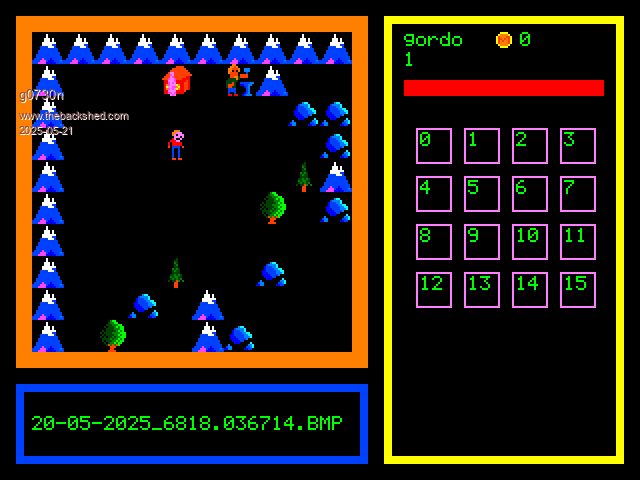

P.S. you can save your screen as a BMP with "SAVE IMAGE "name.bmp"" or "SAVE COMPRESSED IMAGE "name.bmp"" so you do not need to take photo's. During development I typically assign the <ESC> key to that function. To take a screenshot at any time in the game.

Have you seen these reference designs from Peter? If you are familiar ordering @jlcpbc I would suggest them as base.
PicoMiteHDMIUSB motherboard reference design
PicoMite RP2350B DIL Development board, 16Mb flash + 8 MB PSRAM
I have good experience with Pimoroni and they have an interesting products:
2350B with layout of Pico2:pico plus 2

I tried out that Screenshot trick, it worked pretty good. The forum here doesn't accept BMP so I converted to PNG and 2x scale so its easier to see. 320x240 not zoomed in is pretty small haha.
