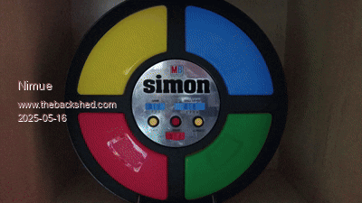

Not sure if an animated gif will work - but for completion of this project:
--edit, nope, animated Gif didnt work.
Online link - nothing special ;-)   << the camera makes it look brighter than it actually is.
* Used a Pico-Zero for the small size
* Use port and the bit shifting recommended
* The zero does not have a heartbeat LED so 1-2mA saved there.
* Running off a battery pack
With 1 of 4 leds flashing and the CPU at 48000 - draw less that 15mA (which fluctuates if the LED is on/off).
