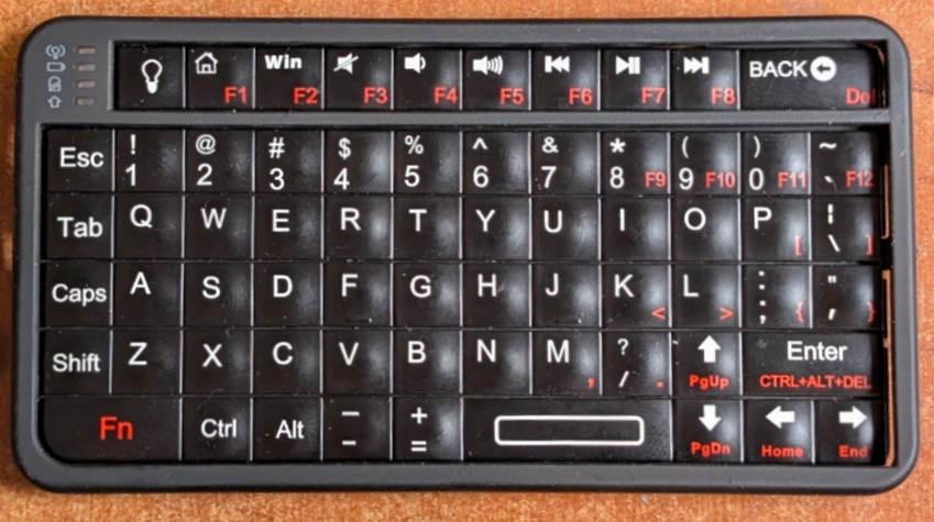

This is the minimum size I'd suggest.
They even bigger question is the display.

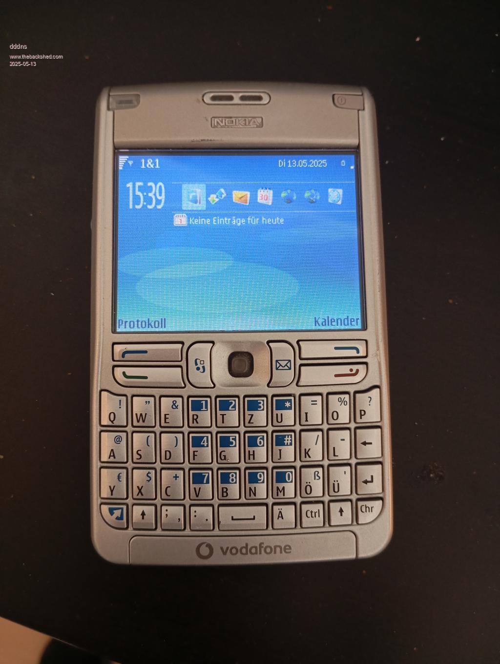

My E61 I own since 2005. So nice and so ugly to handle.

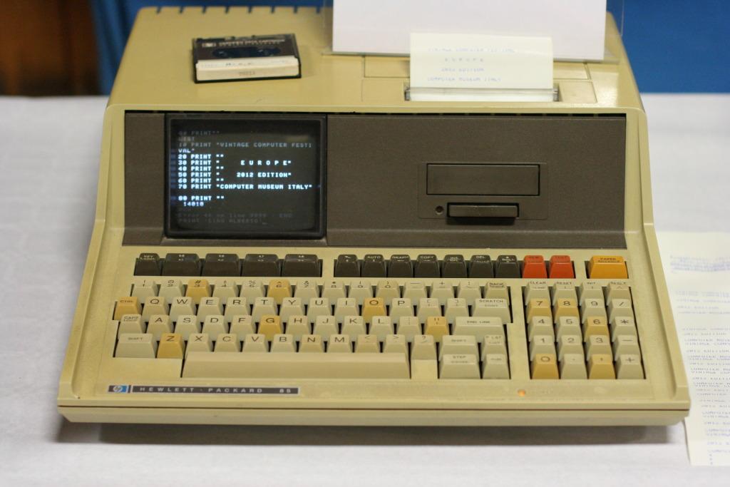

One of the many ideas I've been toying with (and failing to make time for) is a proper desktop "calculator", like the HP 85. I think that would be brilliant. These guys were used a lot for interfacing to instrumentation - so maybe a sort of HP85/PLC hybrid that people can use for full blown I/O.

Oh Pete, you made my day. It's a beauty! :*
Again and again impressive to see, how advanced we were already in the 80's.
The question how good a device is to handle is the main criteria beside functionality if it stays and is accepted. In the 80's they already paid enormous attention to this aspect resulting e.g. in all the Ti calculators with brilliant keybaords and then Casio simplifying it but keeping or enhancing the usability. This is with me since 1985 and bound me so many hours at that time as it was soo! nice to handle:
I really have to change the batteries and see if it still comes up :) ..but I think so :))
Frankly speaking I'd say, this is still _up_to_date_ !!!

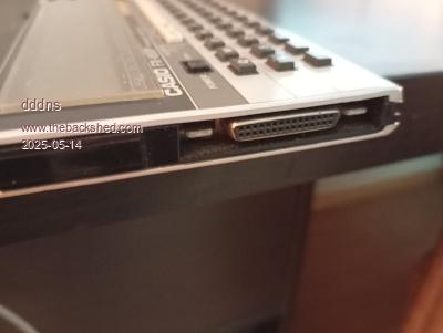

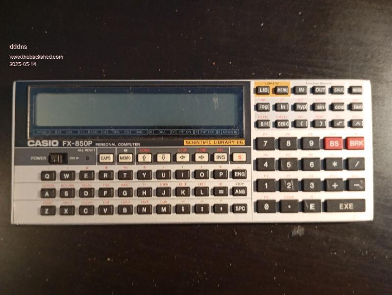

I have never seen  it but seems to be another example of done properly
And this is artwork and can't be reached these days
This has the size of a 2,5" hdd + some cm
And because its artwork it was never really sold en mass

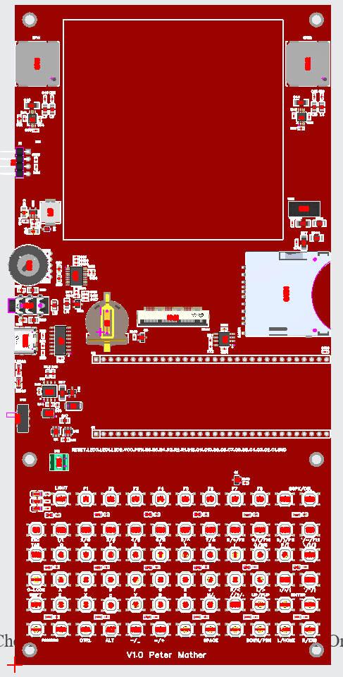

Just for fun I thought I'd wiffle up a quick design
638d583c-054c-4da4-8a17-665bf62057e0.pdf
This uses the 64pin DIL RP2350B module as the CPU and just adds known working bits and pieces from my various designs: Battery power and charging, RTC, I2S audio and stereo amplifier, On board ESP for wifi connectivity, SDcard. It uses a discrete keyboard and would be laid out to fit this overlay.
The screen is the one identified here

Posts: 740
Posted: 05:07pm 08 Jun 2025
  matherp said  Is there really a big market for this sort of thing?
If there is why not do it properly?
Single board that can be fully built by JLC using my standard component blocks from various boards
RP2350, 16Mb Flash, 8Mb PSRAM
Battery backed RTC
I2S Audio with amp, speakers + headphone jack
Battery with onboard charging and use when external power connected.
16-bit parallel display so fast
Custom keyboard with 10x8 matrix scanned direct from the RP2350 so no tacky I2C faults
Case design for resin print by JLC or home print
Properly supported by standard MMBasic
Everything open source and no profit
Someone take my money! If anyone starts a fund to support a startup, let me know.
I'm all for a standardized handheld unit that can use MMBasic right from the source with no mods. Although madcock has been fantastic at keeping up with changes required for the PicoCalc, he may tire of doing so and I don't like support being at anyone's whim. I have no hardware skill to speak of so it would have to be a comprehensive all-in-one design. I wouldn't mind a simple assembly process, however, having to put it together as I did with my PicoCalc.

  matherp said  Just for fun I thought I'd wiffle up a quick design
I would be interested to buy something like this. Just one question, is there any way to include an hdmdi display? I have now both a picocalc and a picomite and i truly enjoy the picocalc. But it would be amazing to have an hdmi screen so the mmbasic graphics capabilities could be used
Posts: 12176
Posted: 06:49pm 08 Jun 2025
Laid out but not routed. Board is 108x225mm
  Quote   Just one question, is there any way to include an hdmdi display?
That would be a completely different design - so no.
Cost about USD32 in 5-off quantities (cheaper in bigger numbers) + the cost of one of my 64-pin DIL modules which adds another USD20
For those new here: I don't sell anything, I just make the design files freely available.
Edited 2025-06-09 04:51 by matherp
