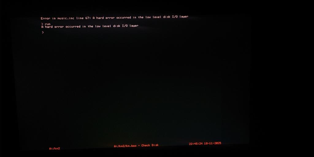

A second issue is that after a few minutes of play, the game Knightmare throws this error: ‘Error in Music.inc line 67: A hard error occurred in the low Level disk I/O layer’. The line number varies, regardless of the firmware version. LeoNicolas thinks it's not a problem with the programme, but rather a problem with the firmware?!?

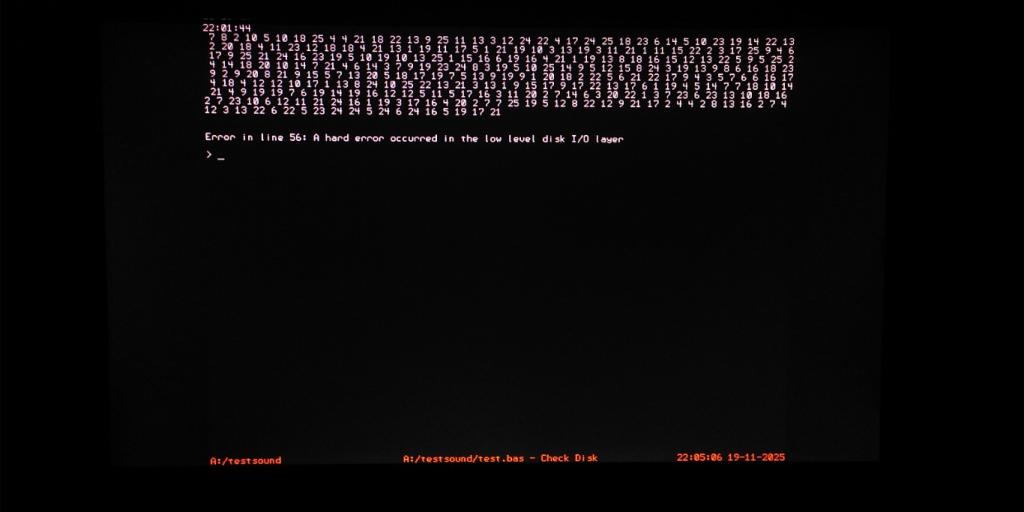

The only thing left is the crash with music effects (Could it be due to dynamic path assignment? Because Files goes haywire when you try to switch to a subfolder (just try it 2-3 times) ... you can see it in the status bar!). I actually wanted to use my graphics grabber for this, but it's currently bricked due to a firmware update. I'll try it with my mobile phone.
But just start the game, set the difficulty to Easy and Stage 1. I can't reach the final boss. The game crashes shortly before that with this screen. Restarting is not possible. The only thing that helps is resetting the CMM2.
The new b7 is really helpful for this, the keyboard is there immediately :-)

  matherp said  Try this version of b7. This is fully up-to-date with Gerry's changes and has my memory frig to re-optimise performance.
I did that. The keyboard also works immediately. No improvement when playing the game. After the crash, "files" can no longer be accessed; the only solution is to reset the device.
Posts: 12174
Posted: 05:39pm 19 Nov 2025
  Quote  After the crash, "files" can no longer be accessed; the only solution is to reset the device.
Sounds like an application issue assuming someone else can replicate. Nothing really Gerry or I can look at unless someone can re-create it with a simple test program.
homa
Joined: 05/11/2021
Posts: 755
Posted: 09:12pm 19 Nov 2025
As requested, here is a small test program. Run it for about 3–4 minutes and the bug will appear.
testsound.zip
Edited 2025-11-20 07:13 by homa
Posts: 12174
Posted: 10:59pm 19 Nov 2025
Running at the moment 15 minutes and no issues (my b7). Will leave it running overnight but I suspect the issue is in your environment SD card or PSU
