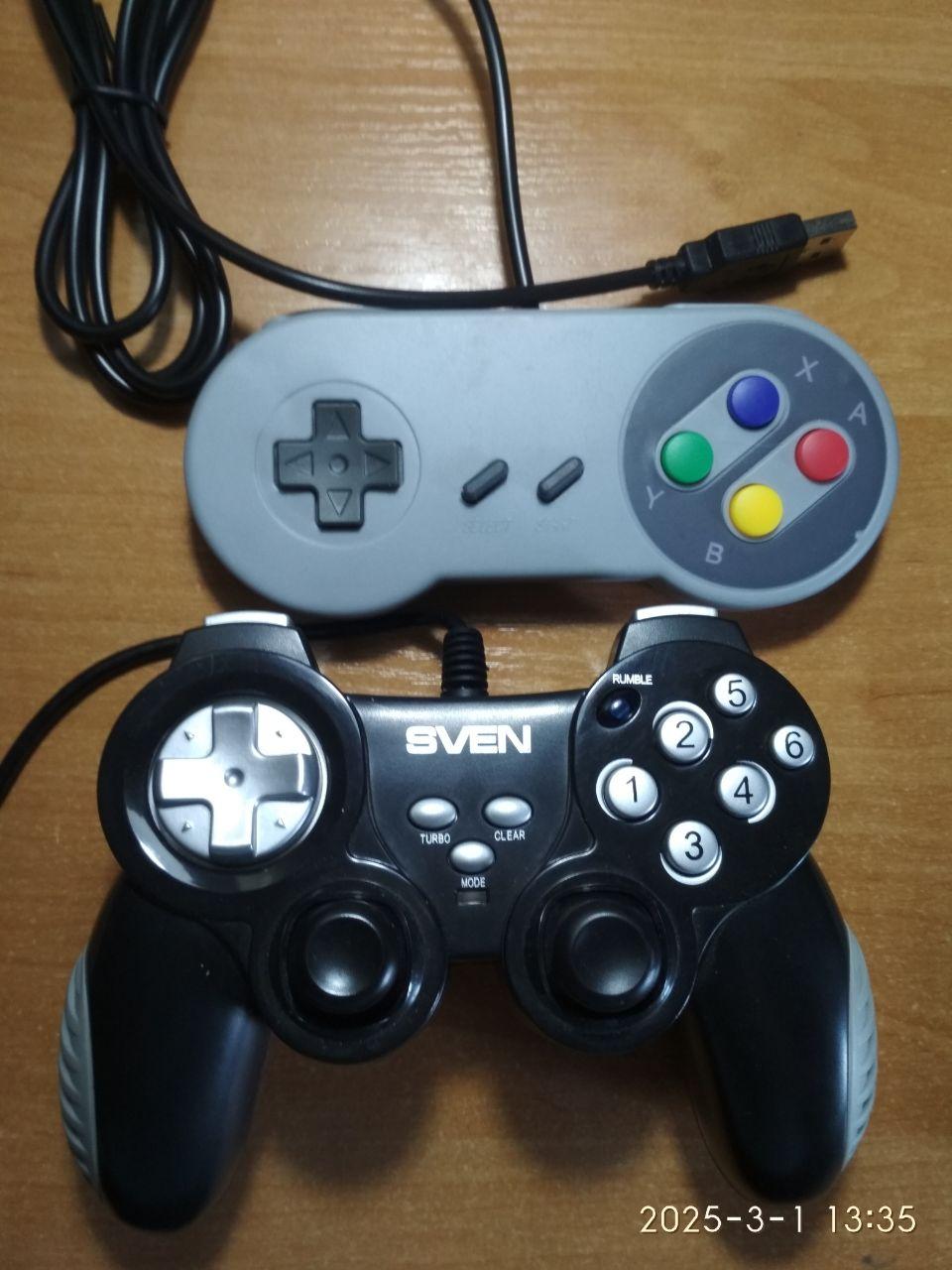

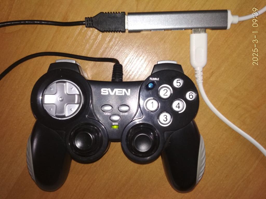

javavi
Joined: 01/10/2023
Location: Ukraine
Posts: 636
Posted: 08:05am 01 Mar 2025
   .vid=0x11FF,.pid=0x3331,
   .b_R1={6,3},
   .b_START={6,1},
   .b_HOME={6,6},
   .b_SELECT={6,0},
   .b_L1={6,2},
   .b_DOWN={1,192},
   .b_RIGHT={0,192},
   .b_UP={1,64},
   .b_LEFT={0,64},
   .b_R2={6,5},
   .b_X={5,4},
   .b_A={5,6},
   .b_Y={5,5},
   .b_B={5,7},
   .b_L2={6,4},
   .b_TOUCH={6,7}
gamepad configure &H11FF,&H3331,6,3,6,1,6,6,6,0,6,2,1,192,0,192,1,64,0,64,6,5,5,4,5,6,5,5,5,7,6,4,6,7
Posts: 12176
Posted: 08:36am 01 Mar 2025
javavi
If you post the diagnostics when also moving the analogue sticks we can probably get those working as well
javavi
Joined: 01/10/2023
Location: Ukraine
Posts: 636
Posted: 10:42am 01 Mar 2025
  matherp said  If you post the diagnostics when also moving the analogue sticks we can probably get those working as well
This gamepad is essentially an analog PC joystick. It has two modes: analog and discrete (in which only extreme values ​​for the directions of the analog sticks are set)
The D-Pad processes the extreme positions of the left analog stick.
| 7F | 7F | 7F | 7F | 7F | 0F | 00 | A0 |
 X1   Y1   Z1   X2   Y2  But1 But2 Stat
X1,Y1 - Left Analog Stick
X2,Y2 - Right Analog Stick
Left - X1=00
Rigt - X1=FF
Up   - Y1=00
Dn   - Y1=FF
But1 - B   A   Y   X . 1   1   1   1  (bits)
But2 - Rt  Lt  R2  L2  R1  L1  6   5  (bits)
Stat - A0 - Discret
      20 - Analog
Edited 2025-03-01 20:50 by javavi

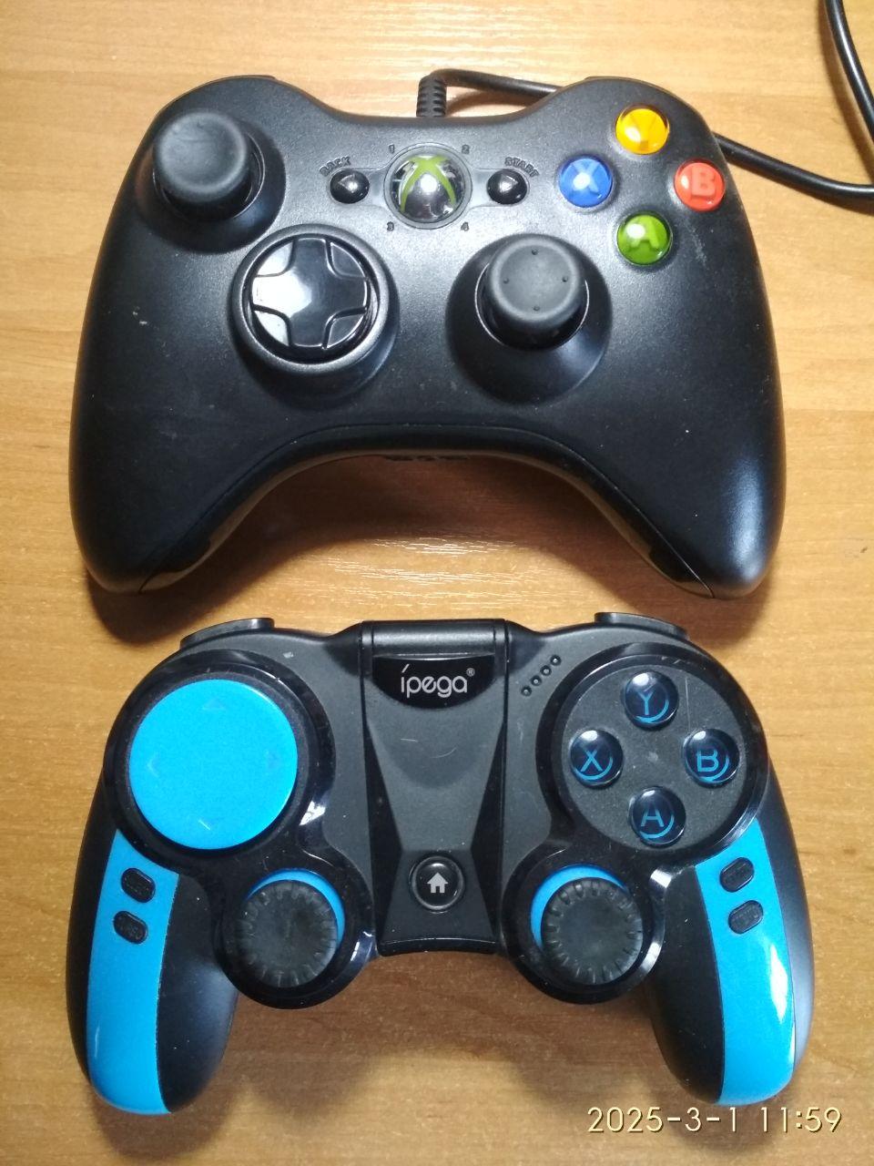

javavi
Joined: 01/10/2023
Location: Ukraine
Posts: 636
Posted: 11:10am 01 Mar 2025
I also have two joysticks for the XBox 360 system.
They are not recognized by the test program at all.
I wish they were also supported by the PicoMite system.
