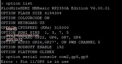

Hello everyone,
I received the Raspberry PI Pico 2 (RP2350) today and, as expected, successfully installed the PicoMiteHDMIV6.00.01.uf2 by typing "OPTION RESET OLIMEX" via PuTTY on the Pico's USB connector.
However, I tried for a long time because my EIZO monitor persistently did not display an image. Only after a lot of back and forth did I connect my Samsung monitor, and lo and behold, I could see something immediately. I had already connected the 5V solder bridge on the underside of the Olimex board yesterday.
But I can't get the PicoMiteHDMIUSBV6.00.01.uf2 to work.
After the installation I have to blindly type “OPTION RESET OLIMEX” with my USB keyboard. So I connected my Logitech USB keyboard to the Pico using a USB-C adapter cable and typed it in blindly - without success.
And the suggestion to connect to the Olimex board via USBtoSerialAdapter in order to make the entries via PuTTY also fails with the error message
> option serial console com2,gp8,gp9
Error : Pin 11/GP8 is in use
Now I'm really at a loss ;(

Confusingly, your screenshot shows you have the HDMI version of the firmware installed, not the USB HDMI version. My comments below assume you have the USB HDMI version installed (if you want the USB keyboard to work!)
With the USB variant of the firmware installed, the serial port is automatically set for you.
Simply connect your USB-to-Serial module to GP8 & GP9 (refer to manual for which is Tx and which is Rx) and provide the Pico with power too via the Vsys input (or Vbus - again, refer to manual).
You also need to set your terminal baud speed to 115,200.
This will hopefully get you going…..
(Sorry for editing this multiple times; I initially mis-read the info in your screen shot)
Edited 2025-02-12 10:18 by WhiteWizzard

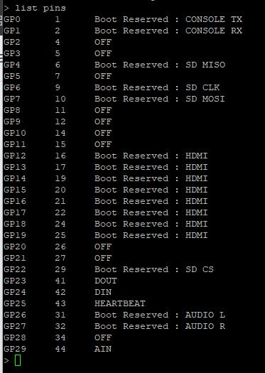

Type LIST PINS to see what all the pins do.

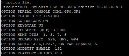

stanleyella
Joined: 25/06/2022
Posts: 2807
Posted: 03:54pm 12 Feb 2025
I thought option reset olimex was for a different board. is it the same as olimex 2040 breakout board.
I had to write the options with forum help but works with usb to ttl.

> option list
PicoMiteHDMI MMBasic USB RP2350A Edition V6.00.02b0
OPTION AUTORUN  ON
OPTION FLASH SIZE 4194304
OPTION COLOURCODE ON
OPTION KEYBOARD UK, 0, 0, 600, 150
OPTION CPUSPEED (KHz) 315000
OPTION HDMI PINS  1, 3, 7, 5
OPTION SDCARD GP22, GP6, GP7, GP4

  WhiteWizzard said  Confusingly, your screenshot shows you have the HDMI version of the firmware installed, not the USB HDMI version. My comments below assume you have the USB HDMI version installed (if you want the USB keyboard to work!)
Thanks WhiteWizzard, my screenshot is from when I installed PicoMiteHDMIV6.00.01.uf2.
Later after installing PicoMiteHDMIUSBV6.00.01.uf2 I could not take screenshots anymore because nothing is displayed and the console could not be connected.
Edited 2025-02-13 03:04 by ManiB

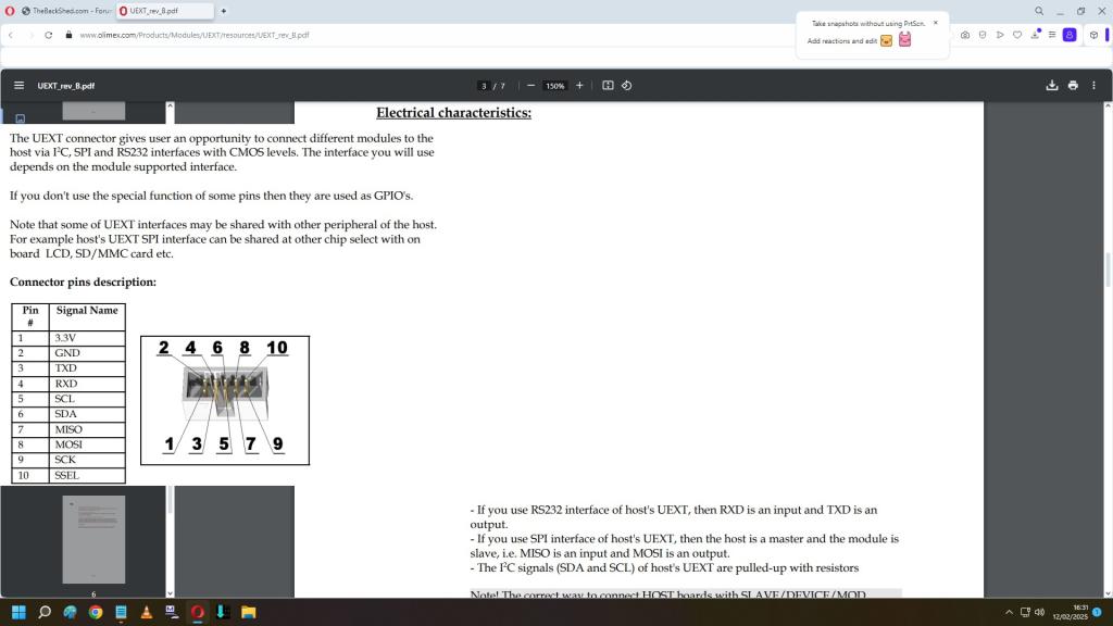

The Olimex board has a three pin header connected to GP0 and GP1 which can be used for a serial console (DBG1 in the schematic). If you use OPTION RESET HDMIUSB it will set the serial console on GP0,GP1 to use this header rather than GP8,GP9.
So, load the HDMIUSB firmware, connect a USB-UART to pins GP8,GP9 (easiest direct on the Pico2 before plugging it into the Olimex and on a computer console type:
OPTION RESET HDMI USB
Everything will then be correctly configured
Now plug the Pico2 into the Olimex board and connect the USB/UART to the three pin header, plug in the HDMI and you are good to go.

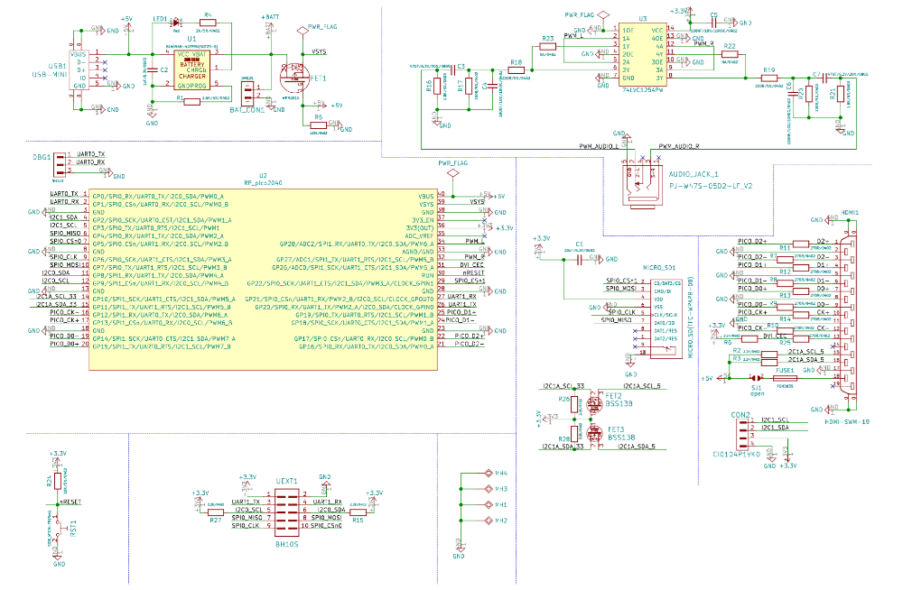

is it this board?

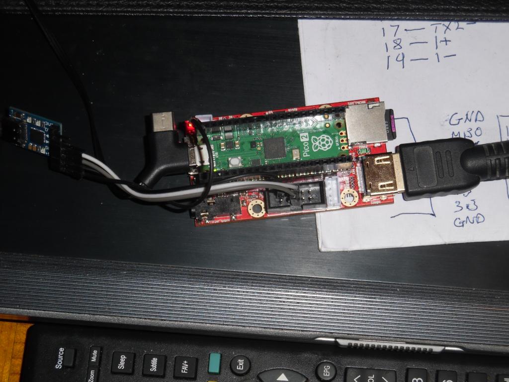

I connected usb to ttl to this socket.
Edited 2025-02-13 04:14 by stanleyella

if it's the same board I use the usb to ttl to program from mmedit and it supplies the vcc pin but the board has a mini usb to power the pico and the 5v from usb to ttl is not needed. both ways work ie power board from 5v or use the usb to ttl 5v . but that was frowned about
