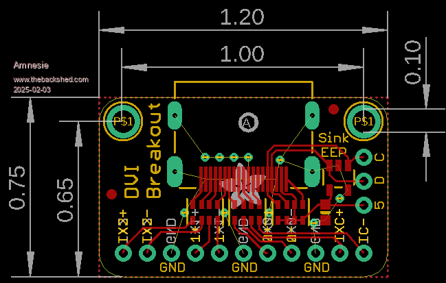

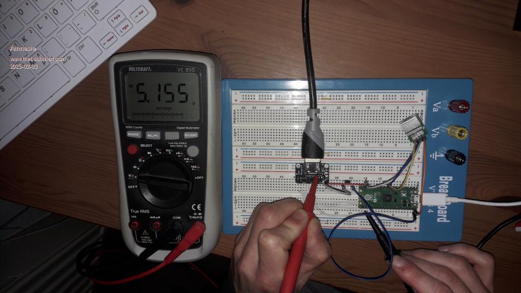

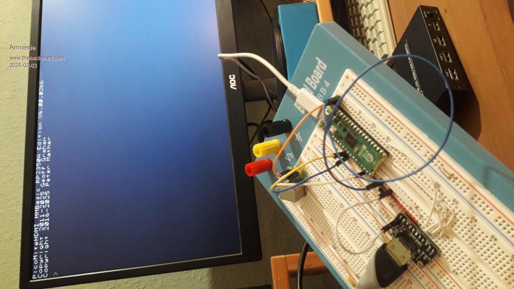

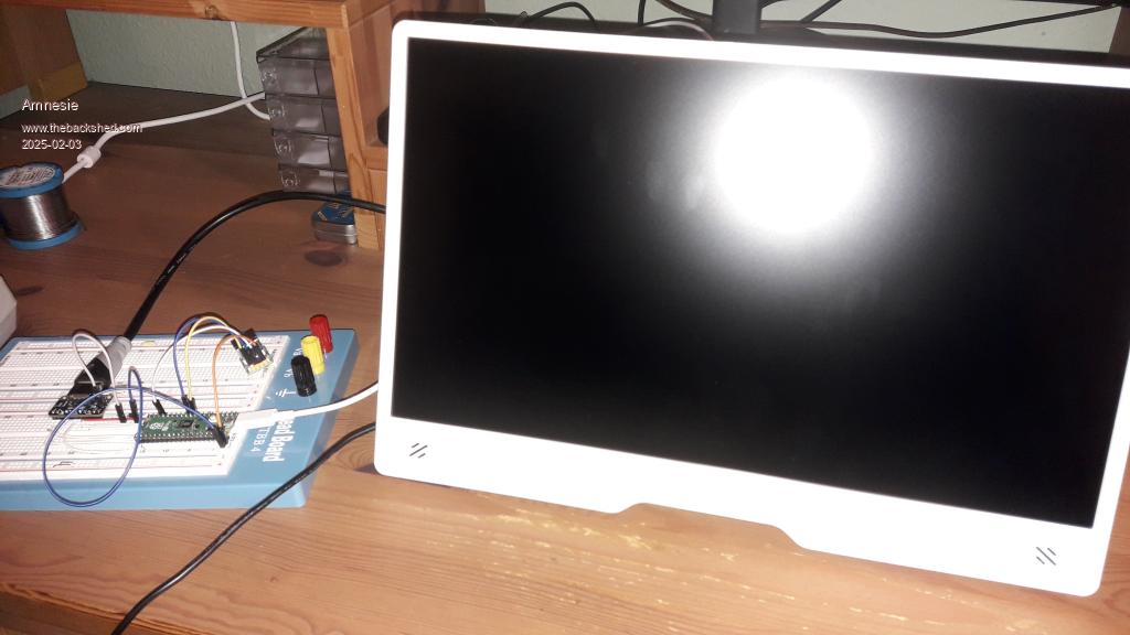

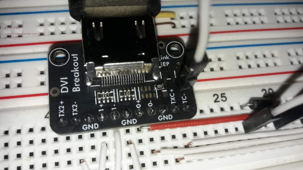

Hi all,
thank you very much for you help. I've attached some pictures.
@ Mixtel:
I did soldered the correct resistor value and it has contact. In fact I've soldered a second one to be sure and measured it.
According to the Adafruit schematic it is not neccesary (in this case) to solder the whole resistor network. So is soldered one 10k pullup (see picture) and the original Adafruit PCB layout. This way the 10k pullup goes to pin 19 of HDMI, too.
Layout:
My "hack":
Measurement between GND and Pin 19 HDMI, HDMI-breakout is supplied via Schottky:
Raspi Monitor not working:
My main work monitor is working:
Javi, the schematic is, as said, 100% the default wiring of the manual for the HDMI version, I just connected a PS/2 keyboard for testing...
Greetings
Daniel
Edited 2025-02-03 05:59 by Amnesie

Your solderless breadboard has to much capacitance, I had similar problems until I removed the HDMI breakout from the solderless breadboard and wired it with "flying leads".  With the HDMI breakout on the solderless breadboard, it would work with some monitors, not work on others, and be intermittent, limited resolution or other strange behavior on a few.  After I got the wiring sorted, it worked on every monitor and TV that I tested.
These HDMI signals are not the low frequency signals that we are accustomed to in the micro-controller world.  Even at low resolution these are high frequency digital signals.  What appears to be a simple HDMI cable is actually a set of impedance-matched transmission lines.
Edited 2025-02-03 06:29 by Sasquatch

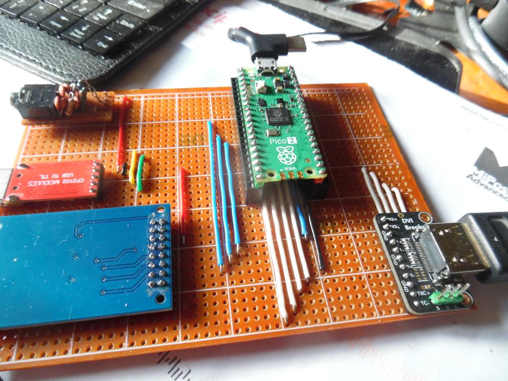

mine started on breadboard and worked and on stripboard ok
I not got others display probs

stanleyella
Joined: 25/06/2022
Posts: 2807
Posted: 08:46pm 02 Feb 2025
no capacitance errors. I found it's the adaptor is ok with bread/strip board.
got to be a reason it works on all tvs with hdmi for me. no 5V to hdmi breakout board.

  Sasquatch said  Your solderless breadboard has to much capacitance, I had similar problems until I removed the HDMI breakout from the solderless breadboard and wired it with "flying leads".  With the HDMI breakout on the solderless breadboard, it would work with some monitors, not work on others, and be intermittent, limited resolution or other strange behavior on a few.  After I got the wiring sorted, it worked on every monitor and TV that I tested.
I can not verify that. Tried direct soldering with short wire same length.
Same problem.
Greetings
Daniel
Edited 2025-02-03 18:55 by Amnesie

Hi thanks very much for you help. Sadly it doesn't work either.
I put this question up on the original Raspberry Pi Forum and one Engineer worte:
Re: Raspberry Pi Official 15,6 Monitor Problems with HDMI
Mon Feb 03, 2025 2:15 pm
My guess is your are outputting 800x600 which isn't a supported resolution.
But even the 720p doesn't work :D
Besides that, I am returning this product (since I bought it a few days ago), I am dissappointed because the approach should be to support even "legacy" resolutions like the cheapest chineese monitor does; either by scaling it to all corners or by shrinking it to a 4:3 ratio. There isn't even an menu...
Nahh I am done with this thing :) I Rather switch to other portable monitors which do this "trick" :)

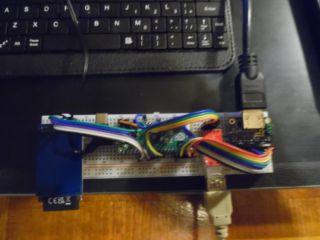

stanleyella
Joined: 25/06/2022
Posts: 2807
Posted: 06:55pm 03 Feb 2025
look up car reversing monitors
I got tv android boxes and rasperry pi's to test hdmi.
I got no trouble with pico 2 hdmi usb... you are using pico 2.
same monitor pico 2 vga usb plugged in. no probs switching via mode/source button.
using the same breakout board as you can't see your problem#
