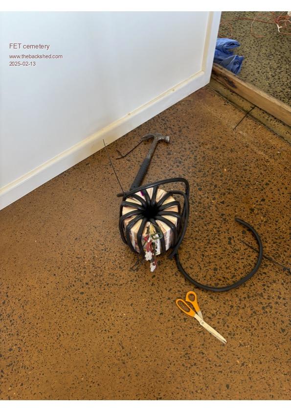

The (nearly) finished product:

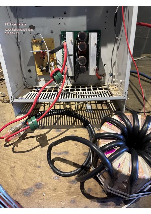

A bit of background, I've been off-grid for 20 years. Bought a powerjack inverter about a decade ago to run the kind of loads I didn't want to risk on the house inverter, eg welders, cutoff wheel, and the big one a 3.6kW pottery kiln.
It lasted 5 or 6 years, when it finally blew up I put together an egs002 driver board and did the Oztules mods to the Fet board. Got another identical blown inverter from a neighbour and basically ran 2 sets of powerjack transformers in parallel as one set was never really up to 3.6kW continuous. EV charging has recently been added to its duties.
Efficiency and output voltage stability was never great, but it was only ever switched on during the day for big loads. It would run fine for months or even more than a year sometimes, and then seemingly at random half the Fets would blow (see my username!).
This is basically the setup that is driving the new transformer until I build the Wiseguy boards.
Note the green rings that were the chokes on the powerjack inverters. Totally inadequate now, the new transformer is a completely different animal.

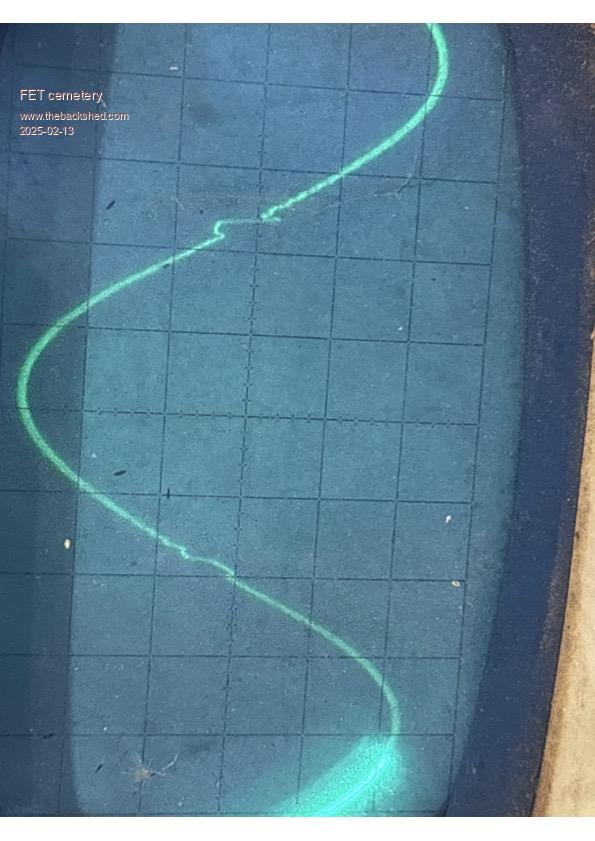

Waveform with the green rings and 4.7uF across the transformer output, 500W resistive load:

A bit late to post this, but I found using a heat-gun on low quickly warmed up the plastic convening on the cable where it needed to bend/form, one turn at a time, that allowed the cable to smoothly wrap around the toriod and also stay flat on the inner and outer surfaces of the toroid, holding it's new shape as the covering quickly cooled.
I noted you wound 12 turns, do you remember what AC voltage was requited across the 8 turns to produce 240Vac from the 3 series windings?

Hi Mike, a 12 turn primary gives about 28 - 28.5V in for 240V out. I used low heat , a rubber mallet and brute force on the windings, I think I could do a better job now.
Try not to laugh, this is the choke setup at the moment:
One leg has a single loop running through the remains of an old microwave transformer. The other is running through 2 smallish ferrite rings. (Any comments are welcome, I don't really know what I'm doing with chokes!)
The "microwave choke" runs warm enough to need a small fan running slowly at 4.3kW continuous. I'm well aware its not ideal, for starters its welded together so the laminations are shorted.
Interestingly, an old 1.5kW induction motor aircon makes the choke run even hotter, must be an ugly load for an inverter.
The ferrite rings run cold unless the inverter is running at less than say 200W, then they'll run up to 20C above ambient.
I have 9.4uF across the transformer output now, haven't checked the resonance it's just what gave a cleaner waveform under load. Since late December this setup has pushed over 600kWh into the car.
You can still see the zero crossing on the scope but it's much tidier now.
Voltage stability is excellent, efficiency is about 90% and standby power is about 55W. Good enough that I don't have to rush assembling the Wiseguy boards.

The 9.4uf capacitor is a bit much, around 4uf is all you should need, much higher will start to cause other loss issues.
Don't worry about resonance, it's not relevant.

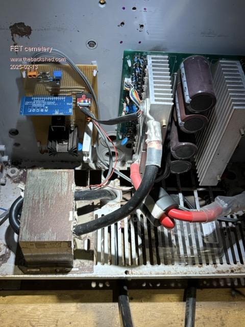

@FET cemetery,  The steel box your inverter is sitting in, looks like an Ericsson Rectifier, 48v battery charger?    they had a good transformer in them, I used it in one of my inverter builds,  thanks for sharing a few build pictures.

Well spotted Aaron! I felt guilty dismantling it, but it had a failure on the '80s pcb that I couldn't work out and probably wouldn't have been able to find parts for anyway. I used it for years to charge batteries with a generator.
I use the original power switch and the old analogue Amp and Voltmeter. Just because I can!

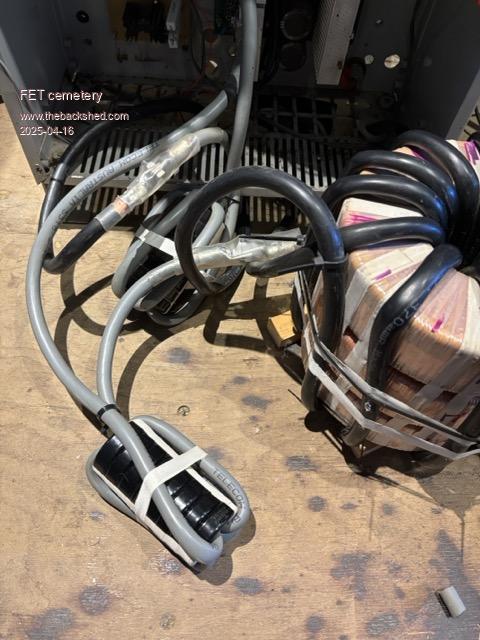

I now have 2 chokes, 8 Sendust rings with 4 turns each. Couldn't fit 4 turns of the 64mm wire so had to use 40mm ("fuse wire") instead.
Standby power is now 38W, spectacular for such a cobbled-together machine in my opinion. Efficiency is 92 to 93% depending on the load and how much the clamp meter is to be trusted. Chokes run almost cold.
It's a bit of a rat's nest at the moment:
I'm leaning towards having the transformer and chokes in a separate enclosure to the electronics once the WG boards are done, still thinking about it.

Look Great
My toriods and chokes are mounted quite a distance from the Controller in the bottom of the Inverter cabinet, there is really not a lot of RF coming from the toriods and chokes, it's more from the leads running to the chokes, if you can keep the cables short and 100mm to 150mm or more from any other cabling they won't cause a problem.
Same for the cables from the DC Input connections on the Inverter, lots of Solar REG RF noise and Inverter current noise on the DC cables, I keep any cables from the Input Bus to the controller and Front panel switches in a separate wire loom spaced away from the general interconnect wiring.
