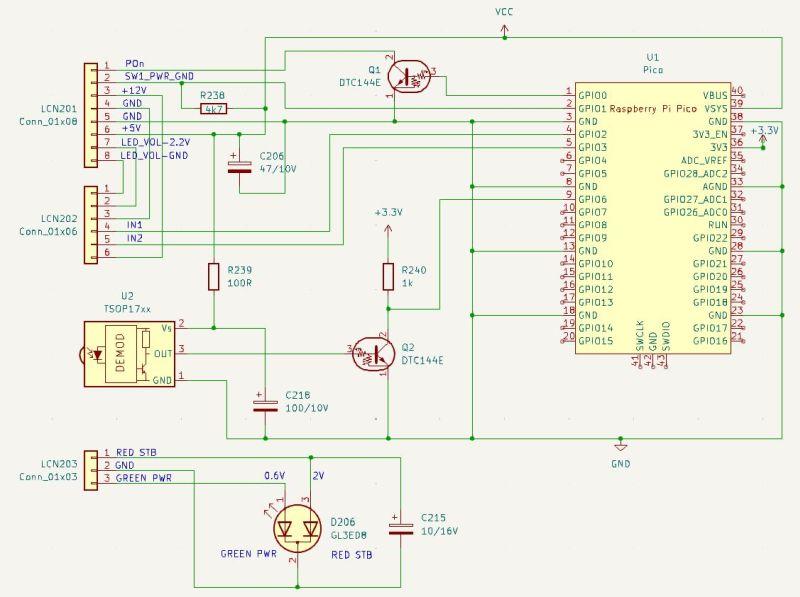

I've not been able to find a data sheet on that IR  receiver. It's probably a good idea to change it for a more modern one. Just make sure your remote works with it first though or you'll be sad. :)
Looks like you could do that with a RP2040-Zero. There's not a lot of IO. A bit of a pain to surface mount though.
A TSOP28328 IR receiver would run from 3V3 and you could lose a transistor. It does the 38kHz decoding too.

By the way, using a transistor between the IR receiver and the Pico is inverting the signal. That's fine if you can handle it in the Pico's software but if you can't then it may not work.

Part of the issue of the old Sony IR receivers poor performance is their maximum sensitivity is at 40kHz, not the more common 38kHz. (Philips use 36kHz).
Regarding level shifting a 5V sensor, they usually have an open collector output with an internal pullup (40kΩ is common) so all that is needed is a suitable pulldown resistor.
Finding the value of the pulldown is easy as the output is idle high.
1) Before connecting to the Pico simply put a 82k from the output to ground and measure the voltage. If it is a bit high or low change the resistor to get it in the range 2.5 - 3.3V.
2) Or just add a Schottky diode from the output to 3.3V.

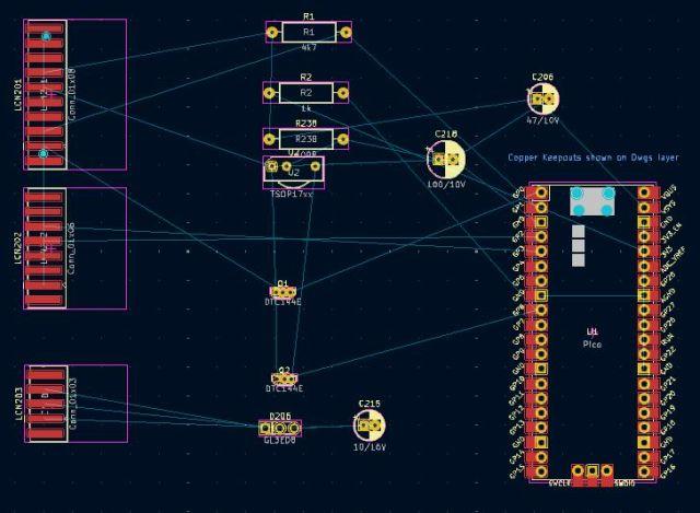

Woooha, I had my KiCad swearing moment when assigning a footprint of the RP Pico. But I did it. The next step is to find out where I can specify the dimensions, for the time being I was going around in circles.
@Mixtel90: I did indeed find an RP2040 Zero for €5.00. As you already indicated, there is enough space on the PCB to place an RP Pico. Fortunately, I have not had to make any new objects yet. I am just having a little trouble finding the right component in the endless list with the right dimensions.
So far I can keep the PCB within 100mm x 100mm. The wiring with the connector is long enough to be placed on the new location on the PCB.
Yes, the signal is inverted because of the transistor, but strangely enough it works. I still have to check whether the transmit codes are also correct in the normal or inverted situation. phil99 also suggested to just use a pull down resistor on the output of the remote sensor or a Schottky diode to 3.3V.
@phil99: thanks for the input, I'll test it.

Next step is to change the KiCad circuitry again and create a footprint for the sensor lying on it's back and looking to the frontside. Still need to find the board dimensions

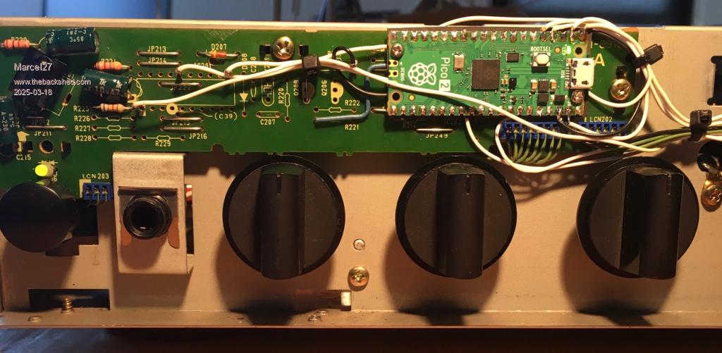

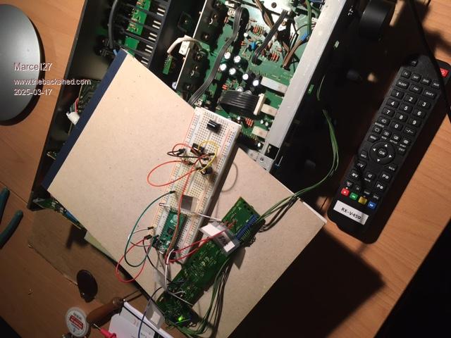

I would have liked to do the wire wrapping but decided against it because the pins were too long.
Neatly built in. For me, good is good enough. I mounted the IR sensor on the original board, pin compatible, added the 180 kOhm to the senor output and ground to adjust the input voltage for the Pico 2. Added a diode in series with the +5V line to the VSYS input in case you connect an USB cable and added some jumpers to get signals at the right places.
I discovered that when the amplifier is switched off there is still 5V on the Pico. So that thing is always thumping.

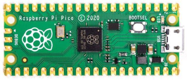

I hate to throw oil on the fire, but the pico2 has a GPIO problem. If I where you I would (just to be sure) add a pullup to +5V value 4.7k from the IR sensor output, and a pulldown of 10k from that same output to GND. That also gives 3.3V high, but has a lower output impedance.
Just to prevent the pico2 input getting into latch-up, and reaching logic high correctly.

I checked it and you are right, I have to lower the voltage/impedance. The IR-sensor has an internal 30 kOhm pull-up resistor, so adding a 10 kOhm from the sensor output to ground should suffice.

The Pico 2 has 5V rated inputs providing it has a 3V3 power supply (which it will have if the built in switcher is being used). The continuous 5V is an advantage here (providing the Heartbeat LED is switched off!).
The IR receiver is active low with a pullup resistor. The problem with the Pico 2 GPIO inputs is with the internal pull down resistors, i.e. it has problems with active high inputs but the pull up side is ok so active low inputs are fine.
