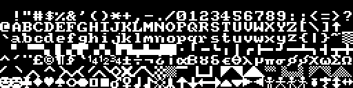

PET Style Fontset
' font_ PET Style Martin Herhaus
' Font type    : Full (160 Characters)
' Font size    : 8x8 pixels
' Memory usage : 1280

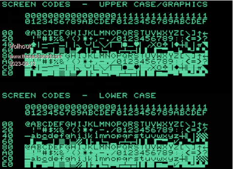

Hi Martin...
Nice... You have mapped the characters on the ASCII related numbers, not the PET screen codes. (in the PET the @ABCD... are mapped to codes 0...32) But that is not important since 6502 code won't run on MMBasic anyway, so using these characters is a new MMBasic program anyway.
As far as I can see you implemented the lower case character set, and added 32 missing graphics characters from the graphics/full set at the end.
If you want to use this for "PETCII ROBOTS" you also need the inverted graphics characters, and some inverted text characters.... David used almost every character in the set on his PET version (fixed upper/graphics characterset).

on the PET, you don't have the option to choose the foreground and background color,
as is possible on the *Mites.
So If we need a inverted graphics character, we can simply swap fore- and background.
You can occupy the remaining 64 chrs (higher than 191) with a selection of the required inverted characters. This would have the advantage that you could store it in a string and output it without interrupting the output.
Like they ve done with the  Apple II Font Port of PETSCII ROBOTS
Another option would be to store the entire character set inverted again as another font.
AFAIK, David uses a special Character Rom for PETSCII ROBOTS

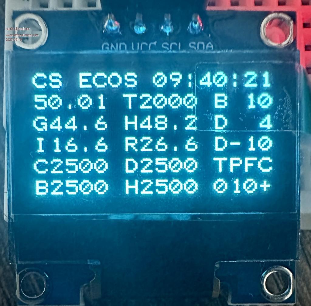

Thanks Martin, your Carton font has found its way into my project.
It displays nicely on a SSD1306 0.96" OLED I2C display, but I have tweaked the line separation to give more space between the lines at the expense of 1 row of characters.
The protective film is still on so that is impacting the image quality.
Cheers Carl

  Volhout said  Hi Martin...

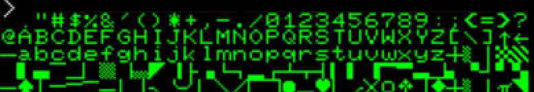

I was thinking about how to Display a 256 character font on the Pico, because it can only display characters starting from 32. The good old GUI BITMAP seems to be a clever solution.
dim gfxfont$(255) length 8
open "gfxfont.bin" for Input as #1
for f=0 to 255:gfxfont$(f)=input$(8,#1):next
SW%=256 'Screen
close #1
cls:ox=0
'test output
for f=0 to 255 step 32
 for n=f to f+31:tn$=tn$+chr$(n):next:GText 0,ox,tn$:tn$=""
 inc ox,8
next
print @(0,128),
'output of this font
sub GText tx%,ty%,text$
local integer c,tl
for c=1 to len(Text$): tl=asc(mid$(text$,c,1))
GUI BITMAP tx%,ty%,gfxfont$(tl),8,8,1,rgb(white)
inc tx%,8:if tx%>=SW% then TX%=0:Inc TY%,8
next
end sub
Font Rom File:
gfxfont.zip

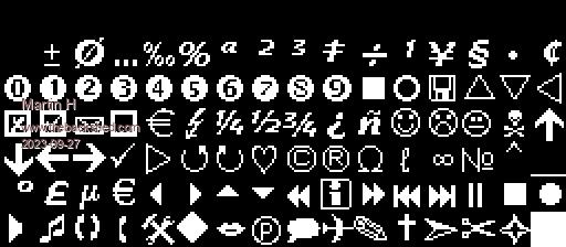

Various_symbols
Font type: Full font (95 chars)
Font size: 16x16 pixels
based on several symbol type PC fonts with normal font weight.
Very usefull for creating buttons on touch screens.
' various_symbols
' Font type    : Full (96 Characters)
' Font size    : 16x16 pixels
' Memory usage : 3072
' Source       : http://www.rinkydinkelectronics.com/r_fonts.php
