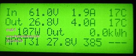

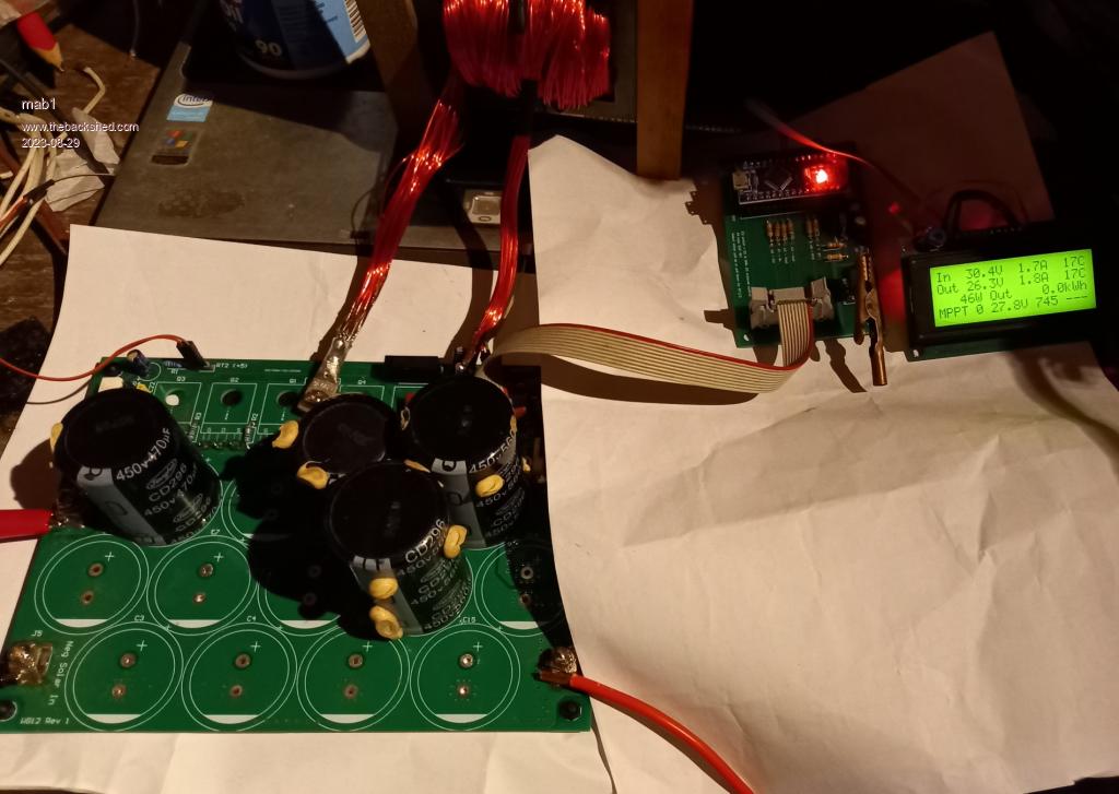

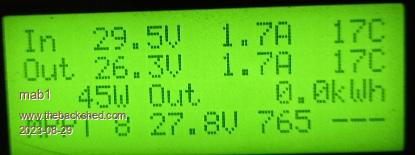

1st benchtop run of the whole mppt(except for the 12v supply/regulator - as the input voltage is planned as about 129V, i thought I'd use a small mains type).
The inductor's wound with about 20 in hand of .71mm dia wire (i found a 5000g roll in the accumulated junk pile). Not sure now how many turns - i was aiming for 24, and a gap of 5.6mm. saturation just above 59A, calculated 88uH.
Connected to the 24v battery, and one 30v 2A bench supply on the input.
It's ALIVE!!

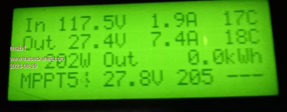

Two 30v supplies:
And (oo-err!) Four 30v supplies:
Not bad - running without a heatsink and nothing's getting warm   . I think one of the bench supplies responds slowly on overcurrent which confuses the mppt into running at a slightly lower voltage (mppt should be with all of them maxxed out:129V ish).
And back down again.

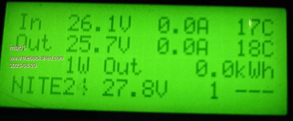

I think there's a cal error on Vout - should be 26.2v, and i seem to be getting 1W in night mode. But i need to go back into cal anyway as I'm still running 20kHz and want to follow recommendations and run it at 40kHz.
Brilliant piece of kit Poida!   thanks. I just need to get it finished.

don't worry about the 1W during NITE mode.
I do all calculations in floating point so small offsets
from the current sensors will give us not-quite-zero results
when we expect zero.
I "could" work a bit of code in there to show zero when we expect zero
but it's better to have correct values, not nice values.

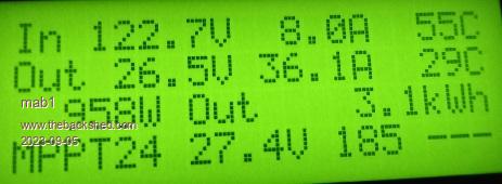

Connected up to the 'east' array this afternoon   : first thing was that the display went blank as soon as it started working - could only get it to keep working if i dangle it outside the box at the mo' so need to add noise suppression. Also noticed the radio reception was affected - i guess common mode suppression on the pv wires needed.
Once i could read the display:
as the sun was headed west, i didn't get past 12A out, and was mostly <10A, but did notice the mppt seemed to be erring on the too-low voltage side c.f. what i would see from the gridtie inverter, sometimes way too low(Voc 154v, expected Vmp ~120 - 130, maybe 115 as light fades. Actually getting 109V at 10A out, dropping to 88v, but the odd 50v!).
The Iin zero had drifted to -0.2A so I'm wondering if that could throw off the MPP calculation at low power levels? Or could it be that i'm running higher voltage that the code was originally designed for? and i need to tweak something? Any ideas?

This mornings experiment at 20kHz instead of 40 shows it finding the expected MPP just fine:
Although my inductor is heating up (top temp), i think that's resistive rather than frequency.
I was contemplating halving di to compensate for 416 steps vs 833 at 20kHz, but if changing dlay is better I'll try that 1st, but don't want to change too much at once as it just confuses things.

let's look at power IN and power OUT, both should be the same
with power out a bit less.
Pin = 122.7 * 8.0 = 982 W
Pout = 26.5 x 36.1 = 957 W
the power loss from voltage conversion is 982 - 957 = 25W
conversion efficiency is the ratio and is 0.97
This is a good result.
25W loss when converting 1kW
Maybe most of the 25W is consumed within the choke?
It's always worth the time to check Vin, Vout, Iin and Iout
when it's running at this power level.
This gives you a lot of confidence in the displayed results.

Yes I'm quite impressed with the efficiency    - particularly as I'm running 5:1 in:out ratio, so the schottkys are conducting for a high proportion of the time.
The calibration is fairly close now: vout is right, vin is actually reading a tad high, so the 122v is nearer 120v, and the Izeros are set so they drop back to 0.0 after seeing +30 - 40a (i did see 40A today - just   ).
I set the throttle back to a higher temp for the inductor: it got up to 67°C (throttle back at 75°c) at 40A; i might put a fan on it. The heatsink is huge 10" x 10" x 2.5" fins. That got to 35° but the ambient in the shed is 28°.
It seems fine at 20kHz: I'll try 40kHz tomorrow. but i did change the mppt settings slightly for both frequencies so i want to see how they compare from full sun (morning) to shadow (pm).

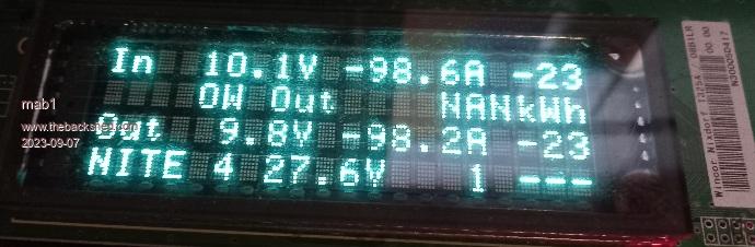

I do have a completely unrelated question:- when you send characters to the lcd,  you wait until baudc > 50. Am i right in thinking that raising this number will slow the data rate to the lcd but have no effects on the mppt?
The reason i ask is that i scored a job lot of 2nd hand vfd displays (shop till /point of sale units), mostly big 20x2 and one 20x4. They take serial ttl, 9600 baud, inverted logic, but the position commands are different, and using two instances of software serial on a nano to transfer the data struggles to keep up with the data flow.

VFD displays.. cool
yes, increase baudc and that will slow down the rate at which a 8 bit character will be sent. baudc is a wait counter, in baudrate.
so the 50 = 50 clocks of 9600 baud.
// send one char out pin A4. First, get a character and put it in "blcd" and init state machine.
if (go_lcd == 0 && baudc > 50)    // not send as soon as possible, let the LCD digest the data with a delay here
baudc = 50 is equivalent to 5 millisecond wait between characters.
baudc is an "int" so it's 16 bit signed integer and that means
it can only go up to 32,767 before overflow.
