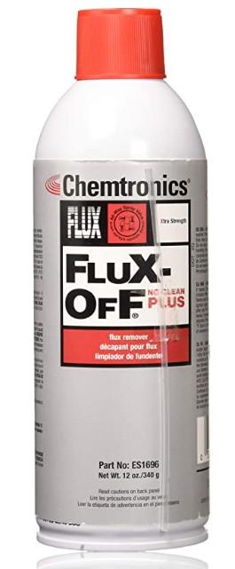

Hi Lads,
I use chemtools flux remover spray can Link
Which works well with an old tooth brush.  The result can be tacky but this dries away after an hour or so, but IPA will remove the tackiness if you need it cleaned quicker.
