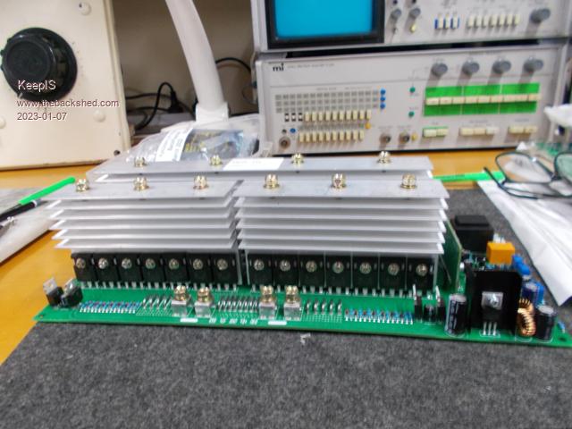

Following on from a question I asked on Page 1 of this post, it was about converting a 24v inverter to 48v. I traced out the circuit of the 12v main switching regulator. It appears to be able to run with no change from 6v to 60v.
That would make sense, it makes it easy for the supplier to make one board to cover  12v to 48v or more, and change a link for 50/60hz option, it appears that all they do when you select a voltage option is adjust the Low voltage and Over voltage cutout pots to suite that voltage.
I ran it up to 60v (no transformer and the control the board stays turned off) and everything was fine. Regulated 12v was perfect and the switching regulator was happy, no change in Reg PWM wave shape. The Reg uses an IRF540N and a tiny control board has an 8 pin surface mount chip and a few passive components, could actually be a 555.
The newer inverters that auto detect input voltage (12v to 60v) use the exact same 12v switching regulator, they auto set over voltage and low voltage cutouts (no adjustments) and you only select the frequency (50/60) and the battery type for the unit you purchase.
BTW ALL caps are rated at 100v where they need to be.
As a refresher, the pictures of my 24v unit in question.
So this should give me something extra to play with at 48v.
Edited 2023-01-07 18:15 by KeepIS

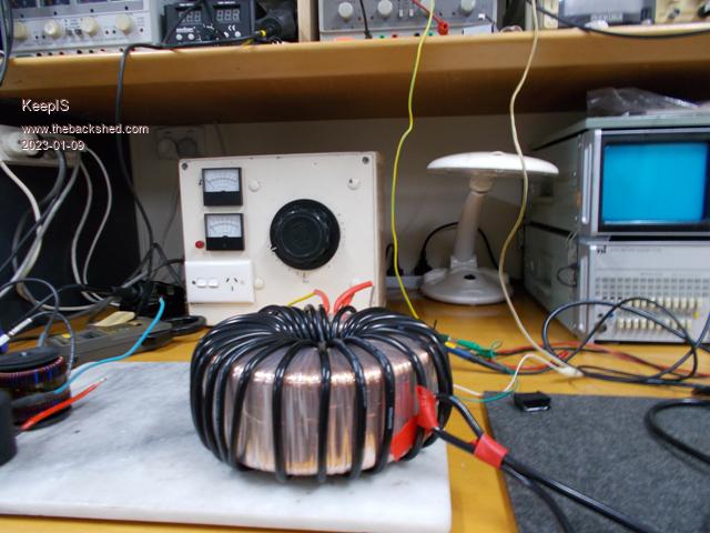

Playing around with the Toriod from the Aerosharp. This will be my test Toriod during the build. The outer winding removed leaving a 230V winding and a screen, might remove the screen and add a few turns to bring it up to 250 or 260v if needed.
Wound a single primary of 8awg 7.5mm2 (56A rated) Core is 0.98v per turn and I wound 27 turns, using my big old VARIAC I got 26.4vac @ 220V, could wind a second but one winding is enough for testing and also for the lower power 230Vac winding. Just wondering if I should drop that to 25V? Although my LiFePO4 battery bank will likely never go below 50V.
Quick test for about 30 seconds pulling 50A @ 25.3v into big dual 300mm x 70mm power resistor load (toaster element on steroids), obviously not enough to heat anything but the load.
There was a Cap supplied with the China inverter, using that, I have a very noticeable resonance peak at 76Hz with the 4uf Cap, close enough for me.

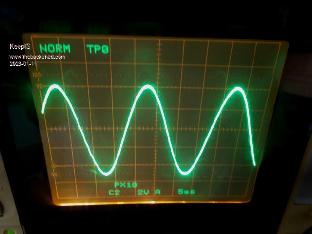

  Quote  Also the inverter waveform was very bumpy on the leading and trailing slopes with no load on the Variac.
You have a photo of it?
If you want to see the sine wave wobble, try a variable speed drill or a soft start grinder, works ok at full speed.Actually I Didn't get the same wobble on the HF inverter, will have to check LF inverter again and see.

I can post a small photo, but looks like the wobble is caused by the choke interaction with the Toriod, I changed turns until I got low Idle and then adjusted for best waveform, and now it's almost textbook sine wave. I'll post one later as I'm now trying to measure the saturation and playing with the gap to increase current before saturation. Of course will have to do it all over again when I make a new toriod. but at least I'll be used to setting it up.
Yes, I plan on gluing it together if they don't ask for it back, but the replacement may be just the one core though.

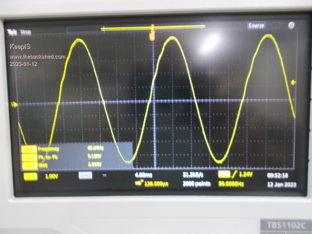

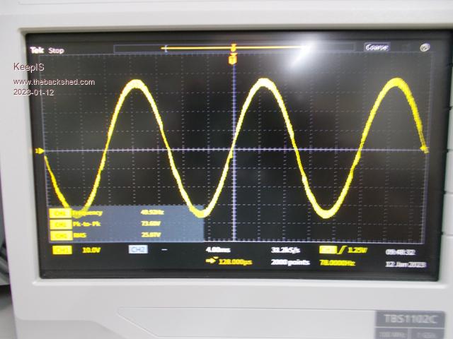

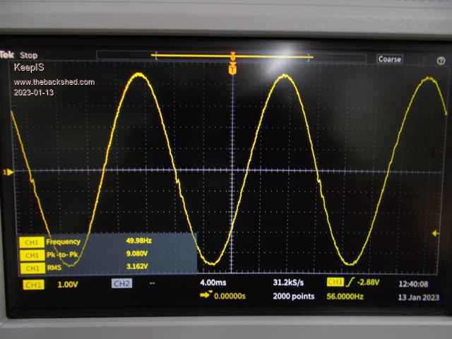

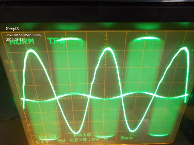

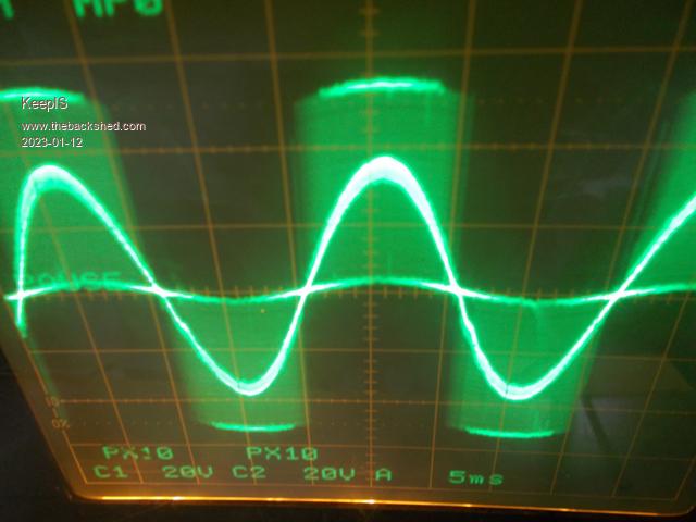

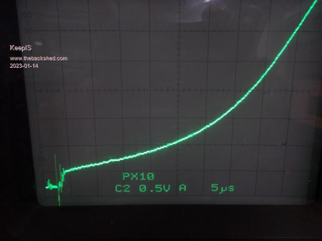

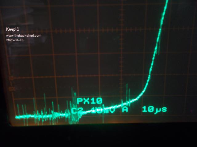

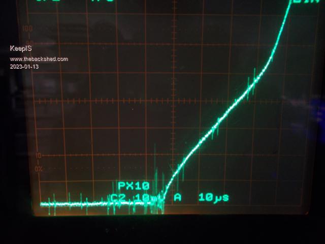

I wondered if a small cap at the output of the choke might help roll off signals > 20kHz, but once a value was high enough to make a change, it was for the worse, more noise on the waveform at the output from the choke - values from .002 to .1 tried.
Looking at the output from the Choke, I adjusted the inductance of the choke for the lowest noise, it only raised the idle current by 30ma and required an extra two turns, but really cleaned it up some.
I find that a second choke in the Lo bridge to toriod lead, while making the waveform slightly smoother, resulted in an occasional spike on output waveform (240V out) when the load was witched on or off, but not all the time, it does not happen with just one Choke, I even tried reducing the inductance of each choke in case I was seeing an inductive spike, but made no difference.
Just out of interest, when the single choke is moved to the Lo side, the AC output has that very noticeable familiar ripple, I thought it would be a lot worse, and still runs fine, but again only tested with a light load, I'm limited to a few hundred watts at the moment. Yes, I put choke back on the correct High side.
Before the choke.
After the Choke (primary of toriod).
AC output.
Apology for bury images.
Edited 2023-01-12 12:17 by KeepIS

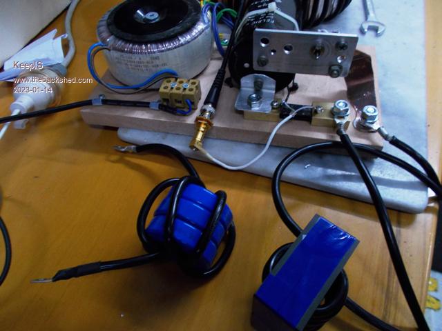

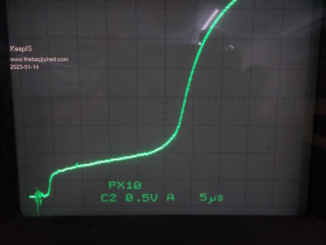

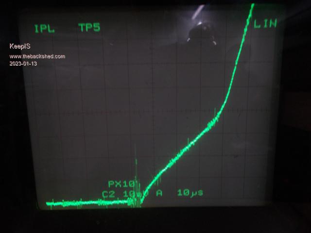

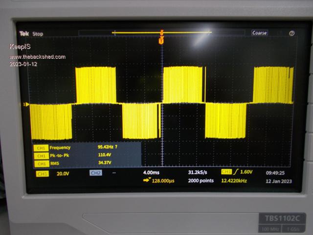

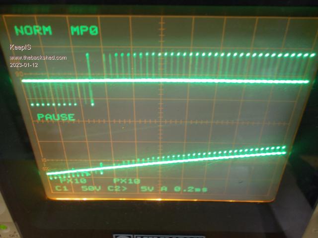

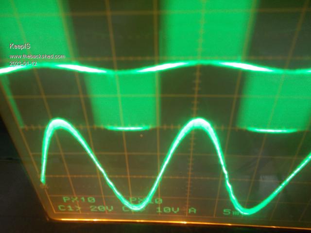

I have 2 Ferite core chokes, one very slightly smaller than the other. I put a 2.5mm air gap in one and tested the saturation, it appears to now reach 150A before the knee, however the inductance is obviously smaller, no haven't measured it yet.
In use, it caused the idle current to raise about 60mA, AC out is still good, but the choke output has a lot of HF noise. I unwound 2 turns from the first ferite choke and then put them in series, the choke output was now acceptable, not as good as before but this is a first test.
There was that slight kink in the leading slope of the AC out, I had also noticed previously some glitches near the HI side transition in or close to the dead zone,    so I took opportunity to grab as few CRO pictures of the waveform zoomed into the choke output and choke input and this is what I found. The dead zone glitch / spike is the thing that makes the kinks that I see on the side of the sine wave.
I was concerned that the Digital capture was introducing some strange spikes. I have two CROs, one a straight digital, the other an Analogue with a digital memory, I can switch between analogue or digital with the press of a button on one CRO, both CROs and the Analogue display showed the glitch spike.
Choke input and output.
Slope of Sinewave and Choke drive zoomed in.
Choke IN and Out overlayed.
AC out overlayed.
Edited 2023-01-12 18:19 by KeepIS
poida
Joined: 02/02/2017
Posts: 1507
Posted: 10:31am 12 Jan 2023
is about as good as it gets.
The nature of the PWM modulation means at zero crossing, there MUST be a short pulse
at some time just before or shortly after zero crossing.
And this excites 1kHz or so oscillations and we see this as wobbles in the waveform.
We could attempt to dampen them with an RC filter or something but no point really.
The above waveform would be about 0.2% distortion and this is like 10 or 20x better
than commercial inverter or generator advertising specs.
But experiment and observe and do it again and again!
This is why we do this. To learn and to make an inverter to run the house.

Posted: 12:32am 13 Jan 2023
  poida said  Hi there,
It's good to see someone new building an inverter
Maybe you can use some of what follows, maybe not..
re: primary winding LC tank behavior
1. resonance above about 45 Hz and
2. not saturating at peak power levels
The choke used in the (3 year so far) working inverter uses 2 of the large E cores,
with a 1mm air gap in the middle pole. They need about 7 turns to get 40uH
and they are wired in series. Testing showed little saturation at 80 Amps and moderate at 90 Amps. The 50V supply x 90 Amps means about 4.5kW peak power
I blew it a couple of times when I had a resonant freq of about 10 or 15 Hz.
Once enough choke is built, I had to choose a small enough cap to give me something more than 45 Hz. Once that was done, the inverter survives.
The cap I use is 1uF or maybe .68uF, I can't recall
Hi, first and apology:
Somehow I missed your earlier post - don't know how?????
This is my play/test setup to get ready for testing my own build based on Wiseguys design with his latest revised EG8010 driver. I'm trying not to destroy the test unit but, whatever, so blowing out the cobwebs from ancient memory, and having fun.
I had already resonated the toriod secondary to 75Hz.
Question:
You mentioned re adjusting the resonance after fitting the choke. Wondering how did you did that, I initially used a precision generator and CRO to set the secondary CAP value. I doubt having the choke connected would make that static test for resonance change that much?
Current value of Cap is 4uf for 76Hz
I was just about to post my test on an E70 N97 core, I will still do that, but it made me wonder about getting a second set to double up and get the inductance higher, shame the postage on them is as much as the dam cores

Posted: 12:38am 13 Jan 2023
As noted above, I missed an earlier post by Poida with some valuable info.
Choke Current and Inductance:
Cores are E70 N87 Ferrite with 6 turns:
I used a wider gap to see how much difference the gap makes to both values.
        GAP:    0               2.8mm
Inductance:   160uH     10.2uH
Saturation:    20A         220A

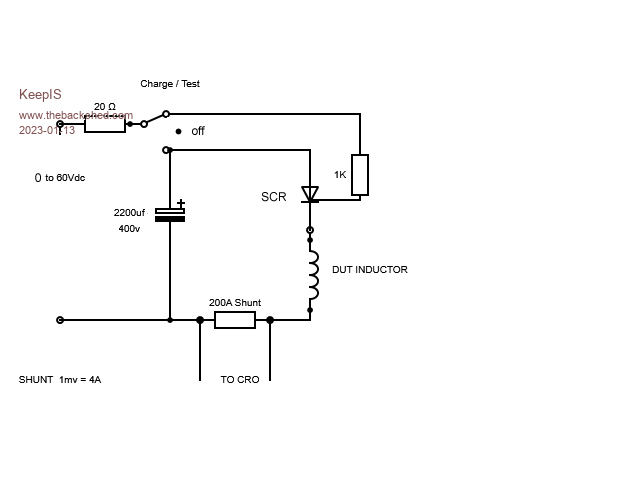

As I posted yesterday, the Choke at 10.2uh still bought the idle current down from 1.5A to 320ma [16 watts] but obviously more noise on the choke output.
Simple Saturation Tester 50mv = 200A:
No core Gap:
2.8mm core gap:
1.3mm core gap:
Interestingly halving the gap to 1.3mm made the inductance go up slightly from 10.2uH to 13uH and the saturation drop from 220A to 160A, 80A less.
Edited 2023-01-13 11:26 by KeepIS
KeepIS
Joined: 13/10/2014
Posts: 2287
Posted: 04:38am 13 Jan 2023
Well, I checked the transformer again, it was now 47Hz with the cap supplied with the inverter board, it was previously 76Hz.
I'm aware of the remanence in the transformer raised by wiseguy, I did what he did with the generator and series resistor to reset it just in case.
And I too needed only 1uf now to resonate it at 75hz, not 4uf which previously resonated it at 76Hz. I'm trying to remember if I checked the resonance BEFORE I had wound the test secondary, that might explain the difference?
So with just the 15uH choke, was 13uH in last post but I managed to fit one more turn, so 15uH choke gave me a perfect wave shape but with a tiny amount of HF switching noise, like a tiny staircase effect, idle current was 300ma.
With the other 40uH choke added in series, extremely clean waveform with only that slight flickering on the TRAILING slope just after the crossover.
However the idle current is now down to only 200ma, 11 watts?
EDIT: With the smaller CAP the big variac no longer makes any noise when running loaded or unloaded, but the choke and transformer now make a very faint hum
Edited 2023-01-13 16:15 by KeepIS
KeepIS
Joined: 13/10/2014
Posts: 2287
Posted: 04:42am 14 Jan 2023
I have two 3 stack blue toriod formers removed from some old solar inverter.
The number is MS-226060-2 some reference to "Super MSS" ? Ferrite toriod.
I wound 6 turns of heavy cable through the 3 cores and the measured inductance was 20uH, when I measured the saturation I initially thought the Test rig was causing noise and glitches to show up.
Rebuilt the inductance test with no cables except for the choke under test. The induction into the Scope coax lead was still causing the waveform to be modified, but most of the noise had gone, using a quality thick coax lead and adapter soldered straight to the current shunt reference pickup points fixed that.
The saturation curve is strange in its slope, like no knee just a gentle curve, in both cases of the E-Core V this blue thing, the E-Core gets to around 180A and then changes quickly, the Blue Cores get to 200A and then seem to saturate very slowly after that?
The picture below is 200A per division, the CAP was charged to 90 volts.
It's almost as big as the E-Core and it weighs more.
Thoughts? Am I seeing things.
NOTE : The E-Core has a 1.3mm air gap, without that it saturates at around 60A on this Jig.
Blue toriod choke 200A per division.
The E-Core on same settings.
Test Jig:
Edited 2023-01-14 14:43 by KeepIS
Solar Mike
Joined: 08/02/2015
Posts: 1255
Posted: 08:22am 14 Jan 2023
Those powdered iron cores make excellent chokes, they are not that expensive, the saturation curve is gradual unlike ferrite, having a large center hole also allows more turns of thick wire.
AliExpress Supplier , last item in the list.
