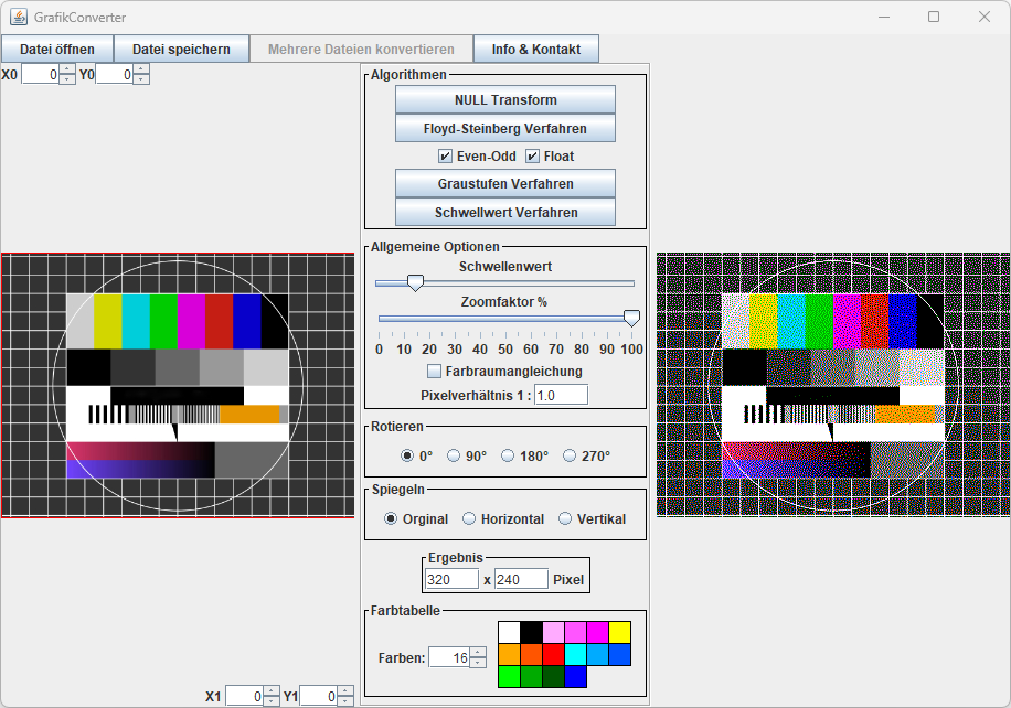

homa
Joined: 05/11/2021
Posts: 755
Posted: 08:52pm 30 Dec 2022
Hello,
I have found the following tool: http://christoph.laeubrich.de/files/uploads/19/grafikkonverterv1_4.zip
Detail here: https://www.mikrocontroller.net/topic/92623   or also here https://github.com/laeubi/grafikkonverter-tool
Unfortunately you have to enter the 16 colors once as a palette at the beginning, this can also not be saved :-(
Maybe someone can do something with the sources ...
Results see attached.
London extracted from the input post. The bird and a test picture of me ...

Nice,
Unfortunately I don't know enough about Java to find the part, where you could store or load the palette.
The results are really great.

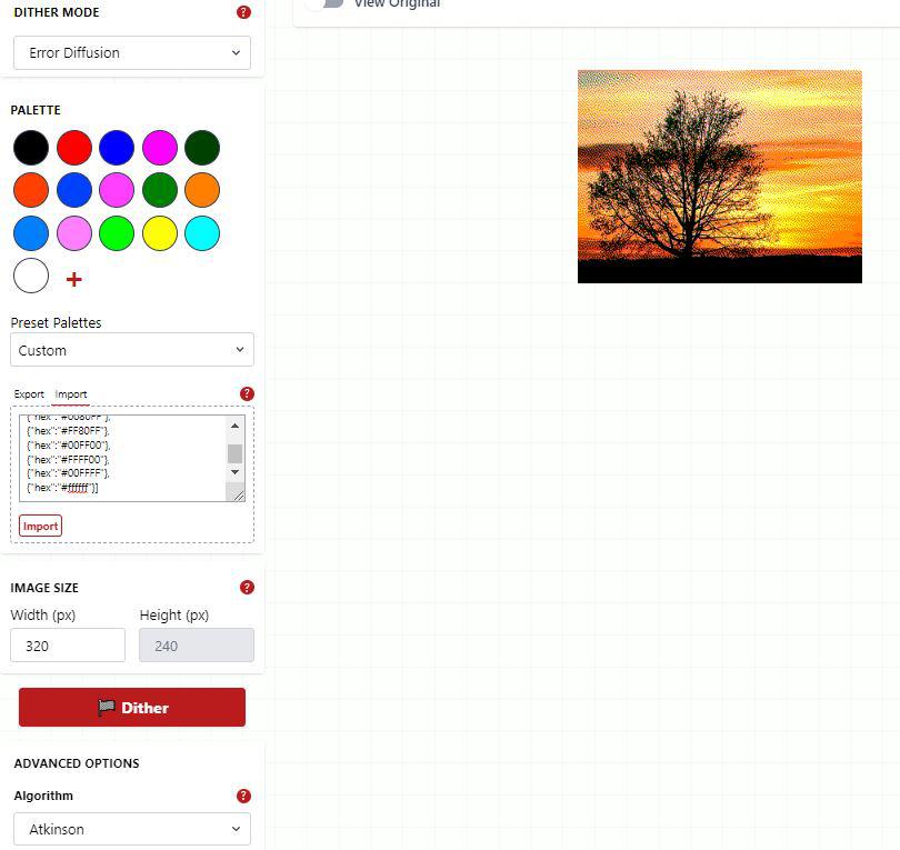

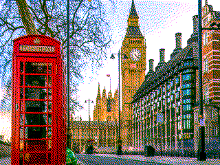

Joined: 04/06/2022
Posts: 1579
Posted: 03:05pm 02 Jan 2023
  homa said   _

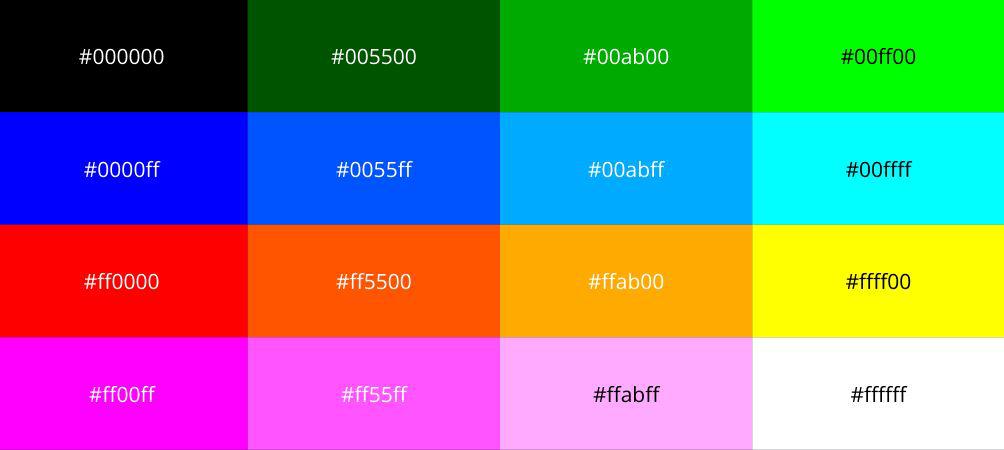

I Think I've found the(by now) best solution.
Here is an Online Ditherer, where you can save (copy and Past) a Custom Color Palette and it dithers in many different ways:
https://ditherit.com/
the Custom Palette for the Pico to past in looks like this:
[{"hex":"#000000"},
{"hex":"#FF0000"},
{"hex":"#0000FF"},
{"hex":"#FF00FF"},
{"hex":"#004000"},
{"hex":"#FF4000"},
{"hex":"#0040FF"},
{"hex":"#FF40FF"},
{"hex":"#008000"},
{"hex":"#FF8000"},
{"hex":"#0080FF"},
{"hex":"#FF80FF"},
{"hex":"#00FF00"},
{"hex":"#FFFF00"},
{"hex":"#00FFFF"},
{"hex":"#FFFFFF"}]

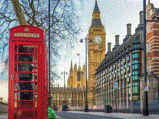

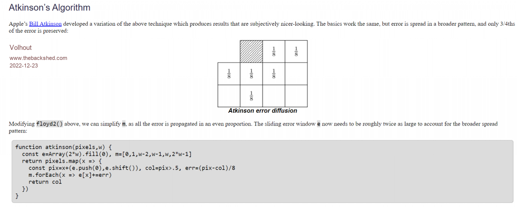

Here the london png with Atkinson dithering looks like this
Mart!n
Edited 2023-01-03 01:25 by Martin H.

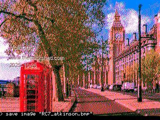

Joined: 04/06/2022
Posts: 1579

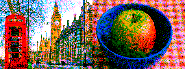

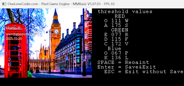

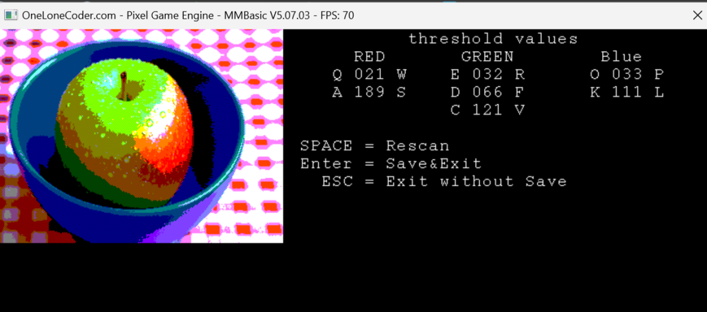

Posted: 08:46pm 13 Oct 2025
Working on the illustration for Colossal Cave Adventures has resulted in significant changes to my MMB 4 Windows tool.
The program now determines the color thresholds itself.
First, the statistical mean for each color (RGB) is calculated for 8x8 pixel blocks, then the median of this list is determined from all the values.
These values are used as the threshold values.
These values can be changed later using buttons.
becomes
'MMB4W Modes etc. Loads a source PNG and translatet it to 121 RGB BMP
'Enter Source Filename here
FN$="testapple"
Mode 1
dim w, h as integer
open FN$ + ".png" for input as #1
s$ = INPUT$(24, #1) ' Erste 24 Bytes holen (bis Ende IHDR-Header)
' Breite aus Byte 17-20 (Index 16–19 in MMBasic, da 0-basiert)
w = ASC(MID$(s$,17,1))*16777216 + ASC(MID$(s$,18,1))*65536 + ASC(MID$(s$,19,1))*256 + ASC(MID$(s$,20,1))
' Höhe aus Byte 21–24 (Index 20–23)
h = ASC(MID$(s$,21,1))*16777216 + ASC(MID$(s$,22,1))*65536 + ASC(MID$(s$,23,1))*256 + ASC(MID$(s$,24,1))
close #1
BL%=(h*w)/64
Dim integer listR(BL%)
Dim integer listG(BL%)
Dim integer listB(BL%)
cls
load png FN$+".png"
Prescan
Scan
ui
save image FN$+".bmp",0,0,w,h
end

sub ui
Font 2
px=w+6
do
Print@(px,0);"           threshold values"
Print@(px,20);"      RED       GREEN        Blue"
Print@(px,40);"    Q ";make$(LR);" W    E ";make$(LG);
PRINT " R      O ";make$(LB);" P"
Print@(px,60);"    A ";make$(UR);" S    D ";make$(MG);
PRINT " F      K ";make$(UB);" L"
Print@(px,80);"               C ";make$(UG);" V"
Print@(px,100);
Print@(PX,120);" SPACE = Repaint"
Print@(PX,140);" Enter = Save&Exit"
Print@(PX,160);"   ESC = Exit without Save"
do :k$=inkey$:Loop while k$=""
k$=Ucase$(k$)
select case k$
case "Q"
if LR>0 then inc LR, -1
case "W"
if LR<UR then inc LR
case "E"
if LG>0 then inc LG, -1
case "R"
if LG<MG then inc LG
case "O"
if LB>0 then inc LB, -1
case "P"
if LB<UB then inc LB
case "A"
if UR>LR then inc UR, -1
 case "S"
 if UR<255 then inc UR
  case "K"
if UB>LB then inc UB, -1
 case "L"
 if UB<255 then inc UB
   case "C"
if UG>MG then inc UG, -1
 case "V"
 if UG<255 then inc UG
     case "D"
if MG>LG then inc MG, -1
 case "F"
 if MG<UG then inc MG
 case " "
 load png FN$+".png"
  Scan
case chr$(13) ,chr$(10)
  Exit SUB
 case chr$(27)
  End
end select
loop
end sub

LR=listR(BL%/3)      'Lower threshold Red
UR=listR(2*(BL%/3))  'Upper threshold
LG=listG(BL%/4)'Lower threshold Green
MG=ListG(2*(BL%/4)) 'Mid threshold
UG=ListG(3*(BL%/4)) 'Upper threshold
LB=listB(BL%/3)      'Lower threshold Blue
UB=listB(2*(BL%/3))  'Upper threshold
end sub
Maybe I'll give Atkinson a try after all.

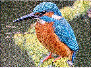

dddns
Joined: 20/09/2024
Posts: 925
Posted: 10:15pm 13 Oct 2025

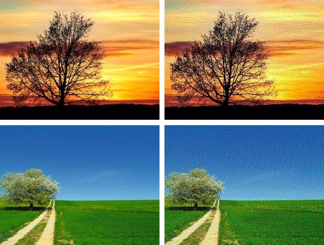

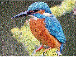

Fantastic thread, thank you all! I'm new to grafics and didn't have an idea how to get into that.
Special thanks @scruss:
  scruss said  A couple of other ways to make pre-dithered images using the venerable (okay, maybe just old) Netpbm toolkit:
1.) Ordered dither
djpeg london.jpg | ppmdither -red=2 -green=4 -blue=2 | ppmtobmp > london_ordered.bmp
Result:
Under Linux all there is to do:
apt install libjpeg-progs
djpeg bird_orig.jpg | pnmremap -floyd -mapfile=<(echo P3 16 1 3 0 0 0 0 2 0 0 2 3 3 3 3 0 3 3 3 0 3 3 0 0 3 1 0 3 2 3 3 2 0 3 1 3 0 3 0 3 3 0 0 1 3 0 0 3 0 1 0) | ppmtobmp > bird_orig_FS.bmp

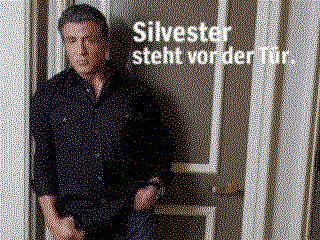

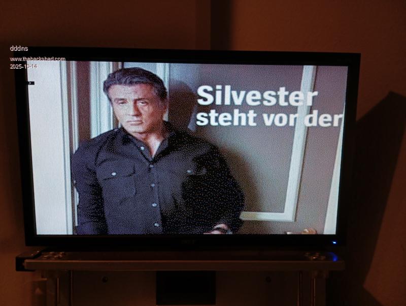

to have that wonderful result and that is exactly how it look on my unmodified VGA:
load image "b:bird_orig_fs.bmp" :  save image "pico_org.bmp"
Thanks a lot!!
Edit:
Weils soo schön ist:
Mode 3 @800x600
Edited 2025-10-14 08:47 by dddns

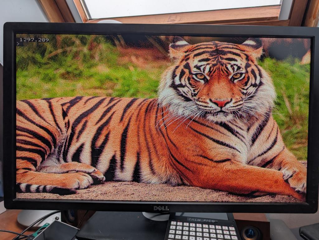

Posts: 12176
Posted: 11:11am 14 Oct 2025
Please don't take this the wrong way....
Here is an image on PICOMITE VGA RP2350 Mode 3 so 640x480 RGB121 standard palette
using the new command
timer=0:load dithered "b:/tiger640":?timer
As you can see it took 1.3 seconds to load and draw.
Here is the genesis of the command using CLAUDE
  Quote  write a function to read a bmp file. Assume the file fnbr is already open and you can read it using the function int IMG_FREAD(int fnbr, void *buff, int count, unsigned int *read)
buffer no more than 5 lines at a time. The maximum filesize is 1920x1080.
Write the file to the display using a dithering algorithm to optimise the visual effect. Accept as an input to the function a parameter that specifies whether the display is RGB121 or RGB332. Assume the bmp file uses standard non-compressed RGB888
  Quote  You can use the function DrawPixel(x,y,c) to write to the screen. No start or end frame calls are needed. The display size is HRes *VRes. Add parameters to indicate the x and y coordinates of the image that should map to 0,0 of the display. Ignore pixels in the image that would fall outside of the display.
DrawPixel takes an RGB888 colour so the RGB121 or RGB332 pixels should be expanded to RGB888 in order to call it.

Atkinson Dithering
During the mid-1980’s, dithering became increasingly popular as computer hardware advanced to support more powerful video drivers and displays. One of the best dithering algorithms from this era was developed by Bill Atkinson, a Apple employee who worked on everything from MacPaint (which he wrote from scratch for the original Macintosh) to HyperCard and QuickDraw.
Atkinson’s formula is a bit different from others, because it only propagates a fraction of the error instead of the full amount. This technique is sometimes offered by modern graphics applications as a “reduced color bleed” option. By only propagating part of the error, speckling is reduced, but contiguous dark or bright sections of an image may become washed out.
https://tannerhelland.com/2012/12/28/dithering-eleven-algorithms-source-code.html

in case anyone's interested
Further improved version, green is now also dithered in 7 steps
g≤LG    Fixed color 0    Level 1: Black
LG<g≤LG_MID    Dither between 0 and G1    Level 2: Very dark green
LG_MID<g≤MG    Fixed color G1    Level 3: Dark green
MG<g≤MG_MID Dither between G1 and G2    Level 4: Medium green-dark
MG_MID<g≤UG    Fixed color G2    Level 5: Medium green
UG<g≤UG_MID    Dither between G2 and G3    Level 6: Light green
g>UG_MID    Fixed color G3    Level 7: Full green
' V2.1
FN$="london"
Mode 1
dim w, h as integer
s$ = INPUT$(24, #1) 'Get first 24 bytes (until end of IHDR header)
' Width from bytes 17-20
'Height from bytes 21–24
close #1
BL%=(h*w)/64
cls
load png FN$+".png"
Prescan
Scan
ui
end
sub Scan
' Constants for the fixed green values
G1 = &H4000 ' Dark green (equivalent to LG)
G2 = &H8000 ' Medium green (equivalent to MG)
G3 = &HFF00 'Full green (corresponds to UG)
' Define thresholds for dithering zones (midpoints between thresholds)
LG_MID = (LG + MG) / 2
MG_MID = (MG + UG) / 2
UG_MID = (UG + 255) / 2
for y=0 to h-1
  for x=0 to w-1
      cl%=0
      n=Pixel(x,y)AND &HFFFFFF
      ' --> Red channel
      r=n AND &HFF
      if r>LR and r<UR then
       ' Dithering A: (0,0)=255, (0,1)=0, (1,0)=0, (1,1)=255
       if (y mod 2)then:R=255*not (x mod 2):else:R=255*(x mod 2):end if
       inc cl%,R
      else
       inc cl%,255*(r>UR)
      end if
      n=int(n/256) '  Prepare the next color
      ' -->Green channel (7-STEP LOGIC)
      g=n AND &HFF
       ' Determine the dithering pattern for the green channel (complementary to red)
' If y is odd , the pattern is 0, 1, 0, 1...
       ' If y is even, the pattern is 1, 0, 1, 0...
       IF (y mod 2) THEN
           DITHER_BIT = (x mod 2)      ' 0 oder 1
       ELSE
           DITHER_BIT = NOT (x mod 2)  ' 1 oder 0
       END IF
      select case g
       ' Stage 7: Full green (G3)
      case >UG_MID
       inc cl%, G3
       ' Stage 6: Dither G3 with G2
      case >UG
       inc cl%, G2 * DITHER_BIT + G3 * (1-DITHER_BIT)
       ' Stage 5: Mittelgrün (G2)
      case >MG_MID
       inc cl%, G2
       ' Stage 4: Dither G2 with G1
      case >MG
       inc cl%, G1 * DITHER_BIT + G2 * (1-DITHER_BIT)
       ' Stage 3: Darkgreen  (G1)
      case >LG_MID
       inc cl%, G1
       ' Stage 2: Dither G1 with 0
      case >LG
       inc cl%, 0 * DITHER_BIT + G1 * (1-DITHER_BIT)
        ' Stage 1: Black (0)
      case else
       inc cl%, 0
      end select
      ' --> Blue channel
      n=int(n/256)
      b=n AND &HFF
      if b>LB and b<UB then
       ' Dithering B: Inverted to red (pattern A)
       if (y mod 2)then:B=255*(x mod 2):else:B=255*not (x mod 2):end if
       inc cl%,B*65536
      else
       inc cl%,&Hff0000*(b>UB)
      end if
      pixel x,y,cl%
  next
next
End sub
sub ui
Font 2
px=w+6
do
Print@(px,0);  " threshold values"
Print@(px,16); "      RED"
Print@(px,32); "   Q ";make$(LR);" W"
Print@(px,48); "   A ";make$(UR);" S"
Print@(px,64); "     GREEN"
Print@(px,80); "   E ";make$(LG);" R "
Print@(px,96); "   D ";make$(MG);" F"
Print@(px,112);"   C ";make$(UG);" V"
Print@(px,128); "    Blue"
PRINT@(px,144);"   O ";make$(LB);" P"
Print@(px,160);"   K ";make$(UB);" L"
Print@(PX,176);" SPACE = Repaint"
Print@(PX,192);" Enter = Save&Exit"
Print@(PX,208);"   ESC = Exit without Save"
k$=Ucase$(k$)
select case k$
case "Q"
case "W"
case "E"
case "R"
case "O"
case "P"
case "A"
case "S"
 case "K"
case "L"
  case "C"
case "V"
    case "D"
case "F"
case " "
load png FN$+".png"
 Scan
 Exit SUB
case chr$(27)
 End
end select
loop
end sub

Hi Martin,
That last picture you posted looks "darker" than earlier dithering examples.
Any reason why ?

@Martin,
I have a problem when transfering the pictures back to the PC when saved with PicoMiteVGA (colors/brightness change, maybe similar to your above darker picture).
But I will try to put them here anyway. However you should try it yourself on 6.01.00RC7
LOAD DITHERED "london.bmp",,,2
london_bmp.zip
The result (again, try on picomite + monitor, it looks much better that this).
Atkinson gives better result on smaller screens than Floyd. On a larger screen Floyd may be better.
Edited 2025-10-26 20:23 by Volhout

Posts: 1579
Posted: 10:58am 26 Oct 2025
Hi Volhout
  Volhout said  I have a problem when transfering the pictures back to the PC when saved with PicoMiteVGA (colors/brightness change, maybe similar to your above darker picture).
The prescan sub attempts to determine the average value for red, green, and blue. First, it adds the values from 8x8 pixel squares, then sorts the determined values and uses them to determine the threshold values. In other words, it uses the median.
If the result appears too dark, too light, or the wrong color, you can use the keys to adjust the threshold values.TIf i Like to avoid dithering, I set both values directly next to each other, i.e., the upper and lower thresholds to the same value.
However, it always depends on the source material which you work on.
For photos, I would prefer Atkinson, but for other images, such as graphics, I would prefer direct conversion with possible dithering, as with the conversion of PetsciRobots tiles and sprites.
Martin
Edited 2025-10-26 21:03 by Martin H.
'no comment

I just mentioned the option, so you could technically provide all graphics for cca in raw (24 bit bmp) format. And let the pico do the dithering. Advantage is that HDMI 2350 platforms can enjoy the graphics in 8bit (mode 3 RGB332) format and VGA users in RGB121 format. Without you having to do all the hard work twice (RGB332) when you feel to it.
How is cca progressing by the way ?
P.S. you would have guessed : I used a different "london" picture. With individual leaves on the trees, so you could see how that works out.

Posts: 12176
Posted: 01:07pm 26 Oct 2025
Volhout - see the rc thread for a test VGA version dithering jpg direct to screen
