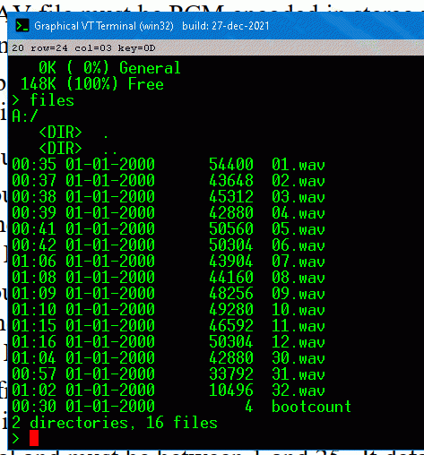

Posted: 02:06am 24 Dec 2022
  Frank N. Furter said  Hello to all,
is there actually a possibility to transfer several files at once?
I would like to realise a speech output via several phoneme files (approx. 60 pieces!!!).
To transfer all these files individually would be a convict's work.
Frank
Further to this, I can confirm it is easy - albeit slow - to transfer multipule files via MMCC.  Just highlight the files you want and click >>>> rather then just one at a time, and MMCC will move them all for you.
Be prepared to wait a while while that happens, if you have a few files.
Also, for sound files, be careful about the WAV file format.  See the manual, page 109 under PLAY WAV.  Your phoneme speech files have to be PCM 8-bit stereo.  The more standard 16-bit WAV does not work.  I copied a 16-bit file without thinking to try it out, and it would not play, so I was scratching my head for a minute, then I read in the manual that WAV files have to be 8-bit, so best to do what the manual says.
However, if not pointed out, I expect it is a gotcha for many other people!
I got all my test speech files converted to PCM 8-bit stereo, using 16kHz sample rate.  That is enough for speech files, and keeps them small enough that I can fit 15 or so WAV files even on the small 700k flash drive on the standard 2MB Pico module or equivalent.
16kHz sampled voice sounds nice and crisp.  Anything less then that such as 8kHz starts to muffle the crispness of the voice at the expense of file-size.
I used Goldwave Audio Editor to do my conversions, but I fully expect that Audacity can also re-encode in the same way somehow.
If you need about 60 voice files, you WILL need a PM with a bigger then 2MB flash chip on it.
EDIT: @ Peter - "bootcount" never changes from 4 - for me, anyway.  Is that something you are working on in the background, or just an artefact of the FS?
Edited 2022-12-24 12:12 by Grogster
Posts: 3430
Posted: 05:09am 24 Dec 2022
I imagine that is the size of the bootcount file, not the count of boots.

Posts: 12185
Posted: 07:52am 24 Dec 2022
Thanks Jim. I've fixed it and updated the download
Grogster: Use ?mm.info(boot count) to get the number of restarts
Edited 2022-12-24 18:27 by matherp
