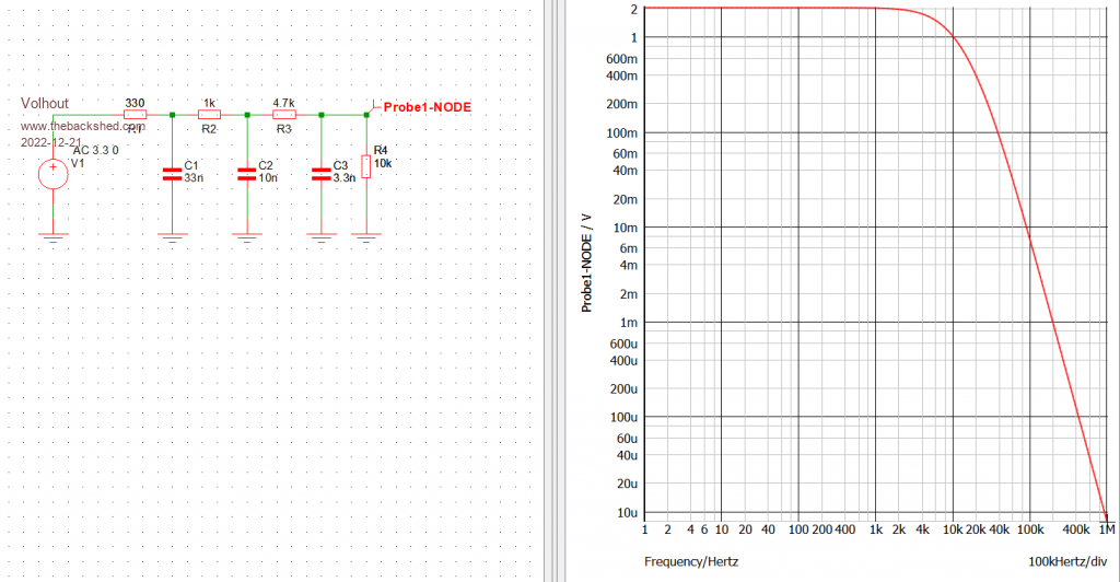

  Volhout said  I'll see what I can do for the filter/amplifier. Do you envision one of this digital amplifiers, and need a simple filter between pico and the digital amplifier ? Or do you want the whole circuit designed (including the amplifier).?

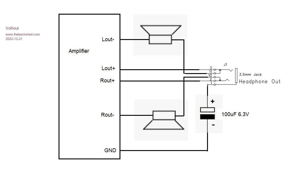

I've been having a look at fitting it into the Hammond 1593 box and I'm pretty sure it's possible even using modules and not much SMD. I had to use smaller buttons (the tops are 9mm dia) and I've still not sorted anything out for Select and Start. The buttons are the KS01 type. which I've used before and don't seem too bad. You can't get the display right to the back wall of the box because of internal pillars, which is what limits the button area.The buttons are on a daughter board, raised up from the main board. This gives some space underneath it for other bits and gets the buttons up to the top.
Stereo headphones won't work with any of the bridged output modules as there's no common, i.e. probably any that will give 80mW upwards from 3.3V I'm considering using a PAM module and fitting a headphone jack though, but it would only be on one channel (which does seem possible). I've hit a snag though in that I've not found a way to automatically detect when headphones are plugged in so that the PicoMite can be told to change its output from stereo to mono and mute the other channel.

To use headphones on a bridge amplifier connect ground to ground and output L+ to headphone L via a 47uF cap. (+ to L+) same for right. You won't get the maximum volume as only one side of the bridge is being used, but in headphones it will still be enough.

@Phill,
This is what used to be in the walkmans. One or 2 tiny speakers and a stereo headset output.
As for the input filter for up to 4 a 5 kHz, you will get decent performance using this (connect 330 ohm to PWM, R4 (10k) will be the volume potmeter. The maximum output voltage is 2Vpp.

  Volhout said  As for the input filter for up to 4 a 5 kHz, you will get decent performance using this (connect 330 ohm to PWM, R4 (10k) will be the volume potmeter. The maximum output voltage is 2Vpp.
Thanks @Volhout, but is this before the amp, or after the amp ... I assume before, in which case where does this "330 ohm to PWM" connect ?

Posts: 6254
Posted: 05:13pm 21 Dec 2022
In case you have 47nf, 15nf and 4.7nf...that will also work....

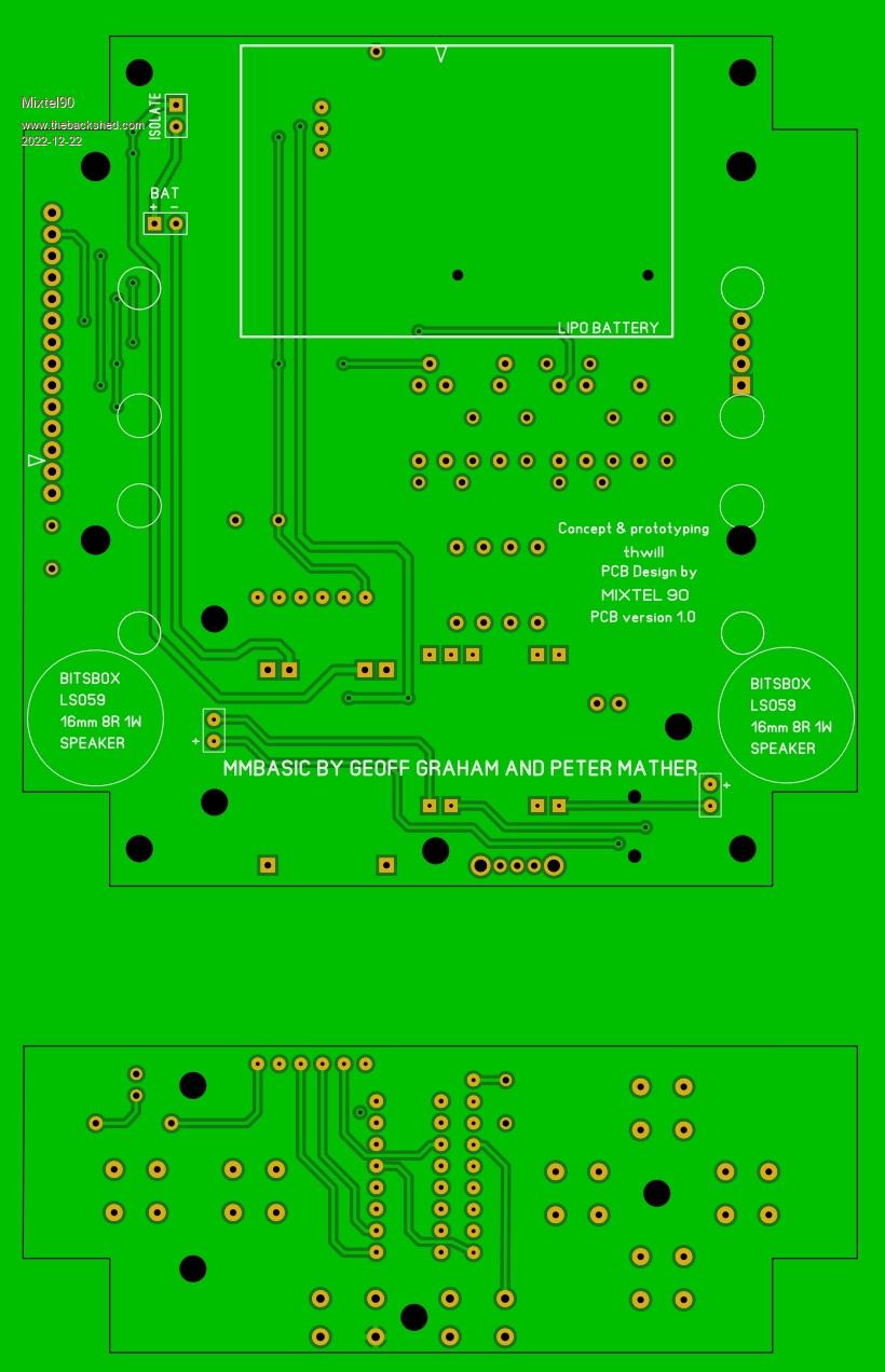

Posts: 2984
Posted: 04:05am 22 Dec 2022
Hi Tom,
If you want I can help you by looking at doing a PCB for you but I will do it in DEX (AutoTraxDEX).
If you want to go down that path I will need the following:
Schematic.
Physical size of the PCB including any cutouts or holes.
Layout and spacing plus location for the switches.
Physical size of the major components i.e screen (don't worry about the Pico)
Part numbers for the various switches would help me with sizes and pad layout etc.
I, of course wont take any responsibility for any errors and I will send you the board layout in JPEG/PNG/PDF for your perusal first then when you are happy I will generate the Gerbers and send them to you.
The board will remain yours to sell, distribute or whatever you want but I would like one for myself.

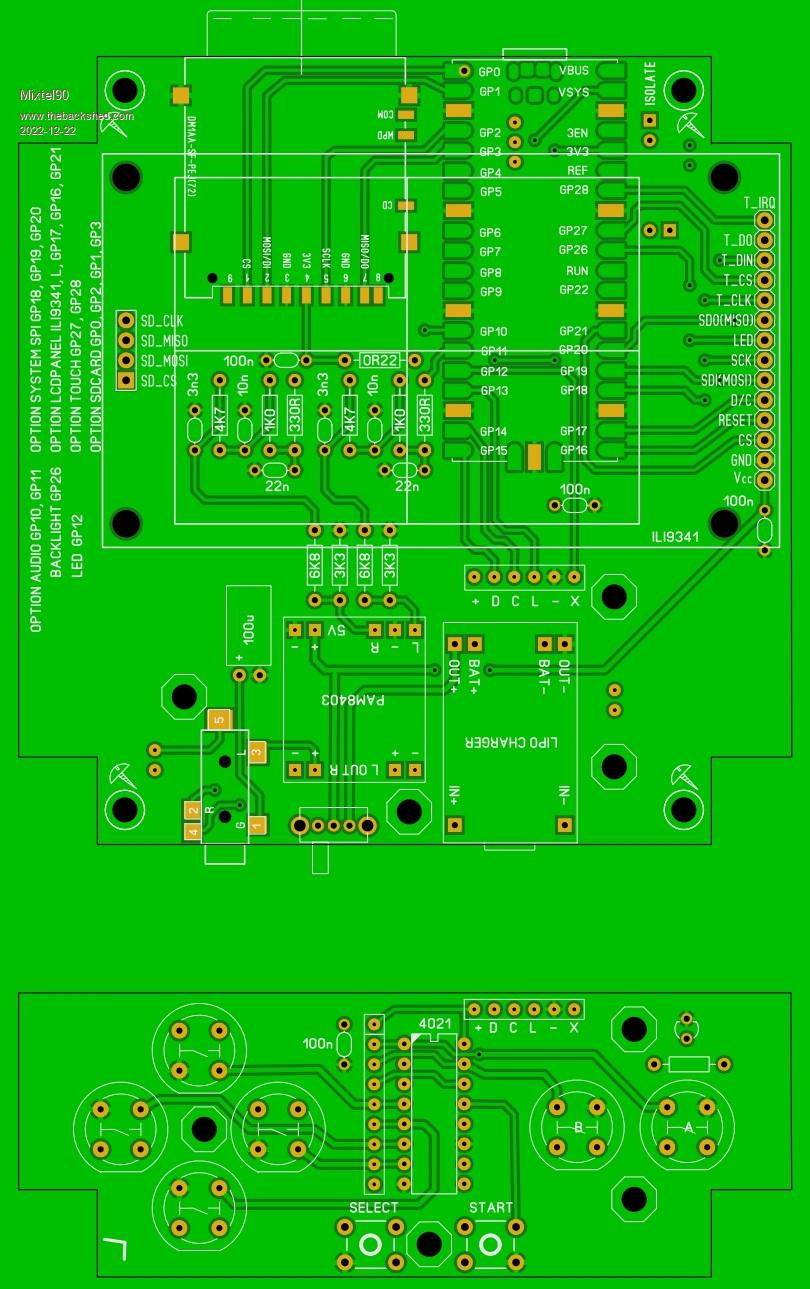

Posts: 9329
Posted: 09:13am 22 Dec 2022
This needs quite a bit of tidying up. It's pretty much still work in progress, but now I'm happy that the bits will fit in the box. I'm not sure that going all SMD would gain much physically, although it would probably reduce assembly cost if several were being manufactured. I made the PicoMite surface mount anyway to save on height.
There's no Reset button and the Boot button isn't accessible with the display fitted.
The main PCB sits on additional 5mm spacers, giving a fraction over 10mm beneath it. That's sufficient to fit a 1500mAh LIPO battery in (8mm thick IIRC). There are no through-hole connections over it to cause damage.
On top of the main PCB, the display is on 11mm spacers. These allow for the usual plug-in connectors. Also on top is the buttons daughter board on 6mm spacers. This would probably have to be hard wired as I'm not aware of a plug-in connector to fit this space off-hand (although something may be possible). I've still not sorted out button tops for Select & Start.
If anyone would like to have a play with this I can supply the SL6 file if Tom is happy for me to do so - it's his project, not mine.
