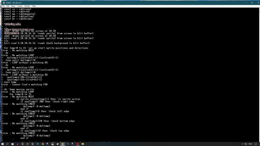

halted the code and turned off autorun and now Teraterm is working as "normal".. I try not to use a terminal. So happy days and sorry for wasting your time.
I thought option autorun was a terminal command when it was a permanent command.
odd it stops teraterm though??
ctrl-c works after a few seconds, gives several >
Trying again after repower and ctrl-c does nothing?

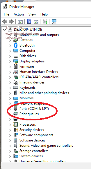

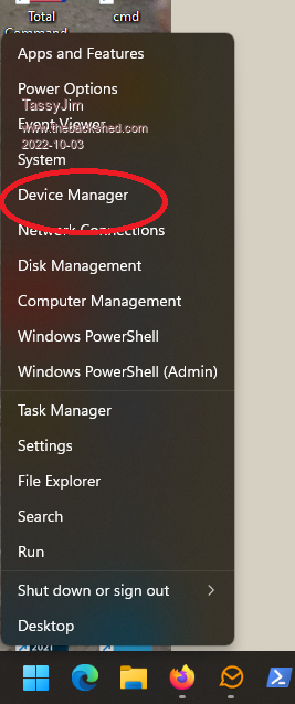

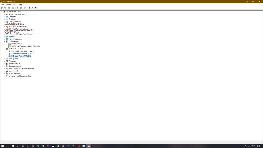

Try the 'normal' way:
Right click on the windows menu button (bottom left on your screen)
click on 'Device Manager'
expand the 'ports' line
Your Picomites will appear as USB Serial Device(COM9) where COM9 etc is the port number. Here I have 2 picomites connected on  COM4 and COM9
TeraTerm and MMEdit5 only list connected devices but the device might not be a picomite etc but a modem or Bluetooth etc.
In Putty, you have to enter the port number yourself.
