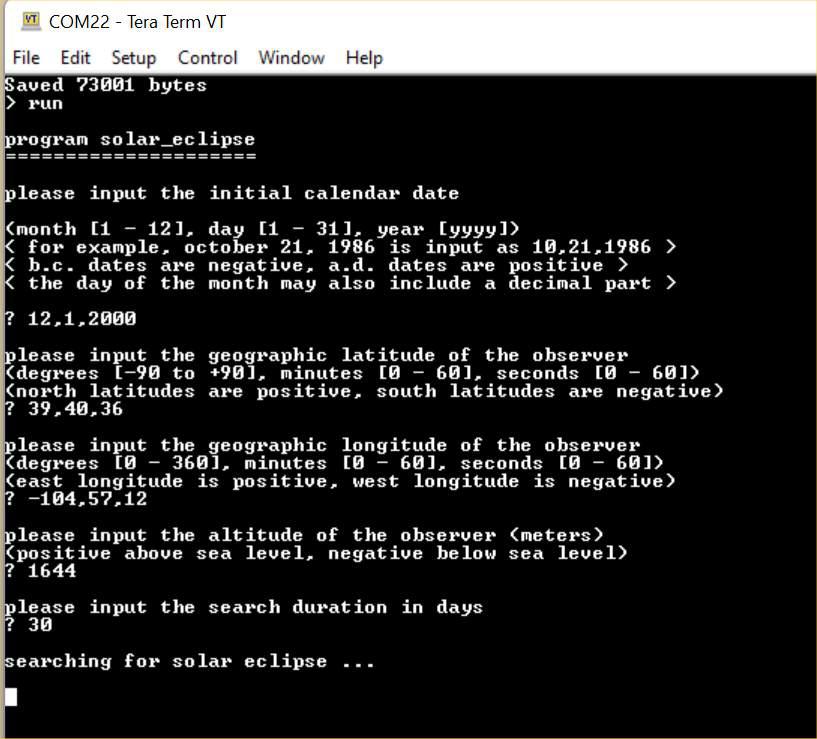

Posts: 12185
Posted: 06:14pm 29 Sep 2022
Worked perfectly when transferring/running 73000 byte file exactly as above (solar_eclipse) so you will need to try and find what you are doing that causes the problem in order for me to have a look
Edited 2022-09-30 04:17 by matherp

Posts: 12185
Posted: 06:23pm 29 Sep 2022
solar_eclipse.zip
