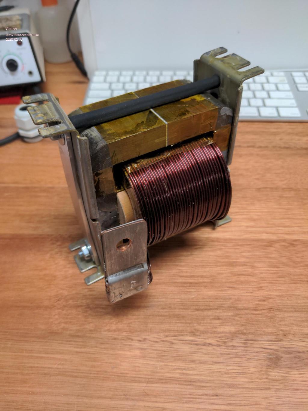

I have still been working away on the inverter. With the assistance of Murphy's Friend I now have a choke to connect up to the big transformer. It's wound with recycled Aerosharp wire and the C cores epoxied together. Other than this I have built up the control board and tested it on a simulator board.

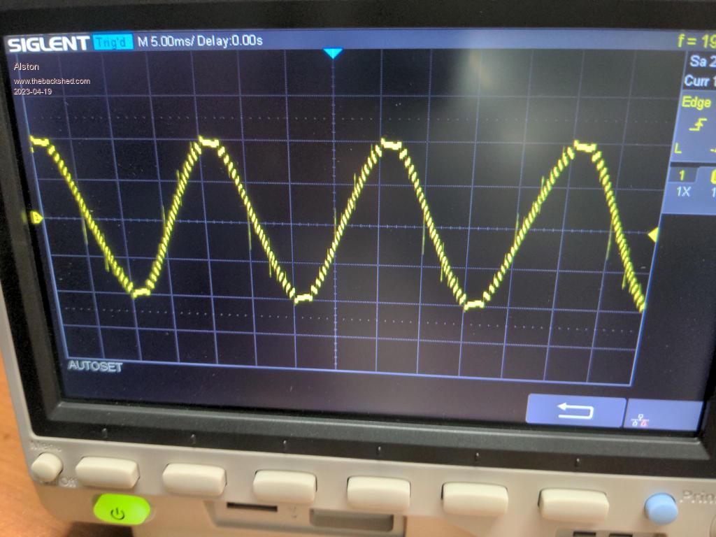

I am glad others on this forum get distracted by other projects so I don't feel so bad when I take a break from the Warpinverter. I have got stuck back into and after tentatively powering up each section and do lots of testing I fired it up tonight with everything hooked up. I didn't have the caps fitted so it's a bit noisy but a great milestone for me. I am not in a rush to get it finished and am just trying to enjoy the build.

Thanks Roger. The choke may or may not be needed, I have yet to actually test without it. If you have a look at this thread (24v inverter) https://www.thebackshed.com/forum/ViewTopic.php?TID=11481&P=2#136905 Mackofgrid discovered he was getting large spikes which fitting the choke solved. Klaus also has them fitted to his large and medium transformers.

Murphy's friend
Joined: 04/10/2019
Posts: 678
Posted: 04:33am 21 Apr 2023
The last thing you want to do when re winding toroidal cores is to waste hole space with gaps between windings.
There are *no* gaps between the original Aeropsharp windings, just a very thin foil layer which may or may not help (I included that but it was a lot of work).
Just make a decent choke, it's not rocket science with all the info shared on this forum supplying plenty of know how.
Just make sure you have all the electronics powered up and running *before* you slowly charge the big capacitors which will thus soft start the inverter.
I do *not* soft start mine with an AC load connected.

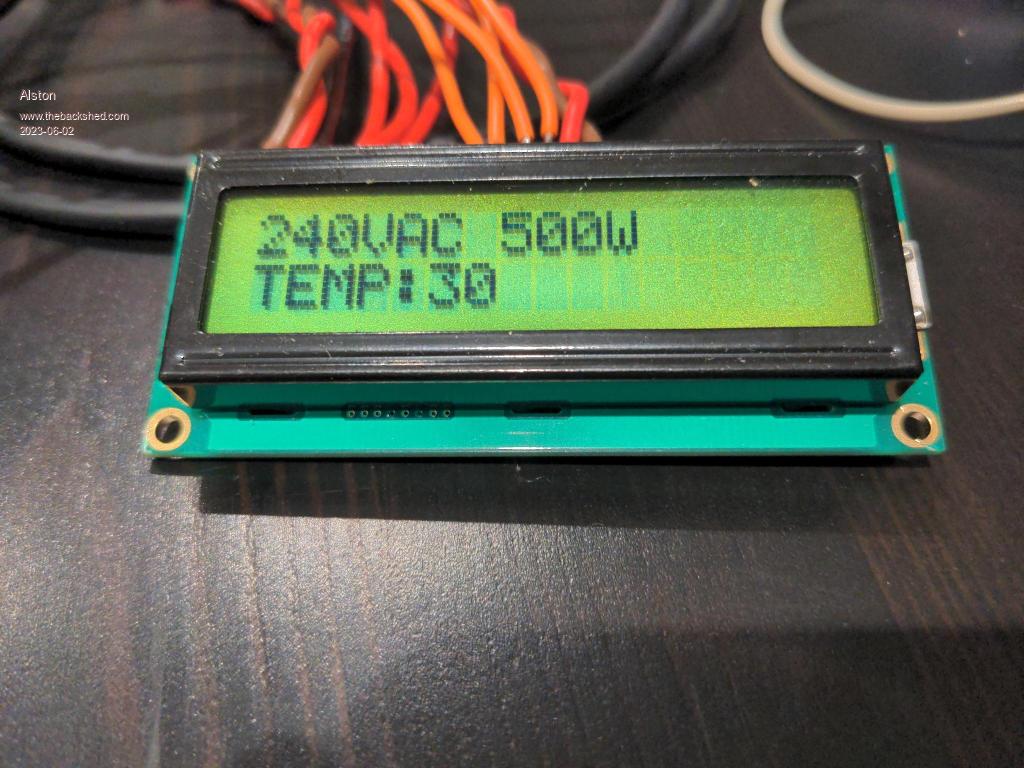

I am currently programming a microcontroller to handle the startup and shutdown procedures of my inverter. Hit start and it will auto pre-charge and so on. This will also handle temperature/fan control and over-current/under-voltage shutdown. I am just not sure what set points I should set. How hot should I expect the heatsink to get with a full 5Kw load and at what point should the fans kick in? I was also going to measure the temperature of the big transformer which I assume would take a really long time to heat up with that amount of copper, again what would be too hot?
Something I haven't wired in yet are an AC line filters. Should I and have others recycled the ones from the Aerosharps?

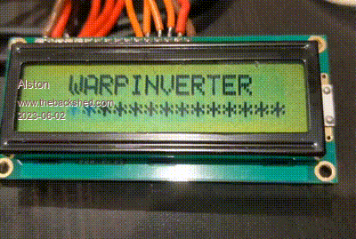

Alston
Joined: 04/04/2021
Posts: 63
Posted: 01:02pm 02 Jun 2023
Thank you Klaus, just what I needed. I have recycled the LCD from the Aerosharp and got it hooked up to my microcontroller so will be using that to display info.

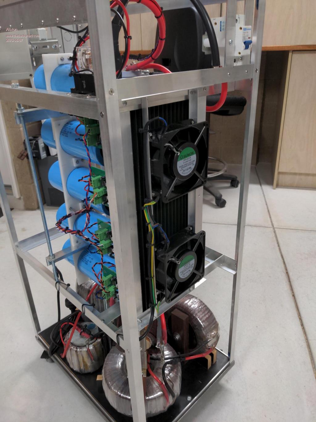

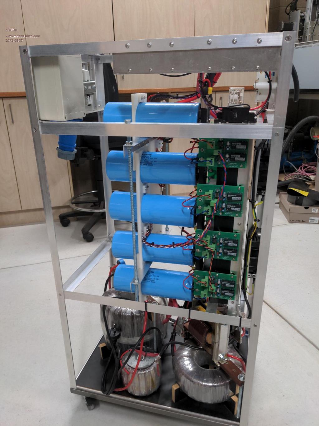

Alston
Joined: 04/04/2021
Posts: 63
Posted: 01:42pm 07 Jun 2023

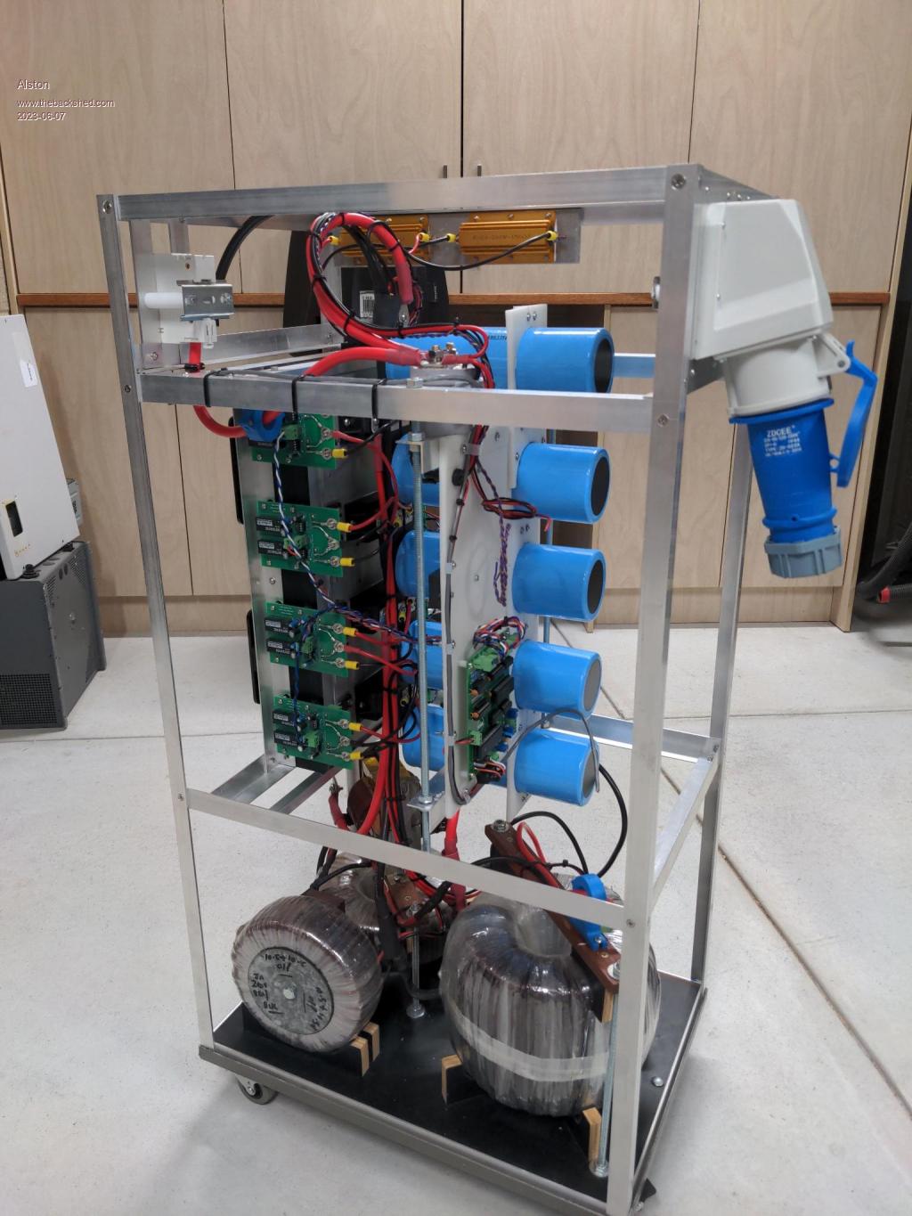

Got most of the wiring done now, yet to test it with the capacitors in place as I had to get the pre charge side of things sorted first. The space above the Warpinverter PCB will have the control PCB. I have a pre charge relay with it's NC contacted wired to a discharge resistor so when that is shut off the caps will discharge. Tony mentioned ages ago he was having failures with his pre charge resistor due to thermal shock but after going with a very oversized one he hasn't had that, hence the large 200watt ones you can see in my photos.

Wow, that looks so good. I thought for a minute that you'd put new short caps in  ...  but then realised it was the spacer/holder that made it look like that. Viewing pix on mobile is pretty hard, will have to inspect again on the PC.
What value resistance did you choose for the precharge and for the discharge resistors?
Edit:
Now I've had a closer look on my pc and am wondering what the small pcb is on the cap steady board (in the first photo)? I originally thought it was the control board but it looks different and you say you're going to fit that above.
What size DC switch are you using?

Murphy's friend
Joined: 04/10/2019
Posts: 678
Posted: 04:33am 08 Jun 2023
  rogerdw said
Edit:
It looks like the control board I designed, I gave Paul a blank board. I did not like the tiny computer generated tracks on Tony's control PCB, on mine its possible to unsolder things without wrecking the pads
Nice job Paul, you are getting there. You might consider that test circuit I posted a while ago (it's a modified version of the board I gave you). It lets you power it up with the capacitors and see if the lights flash correctly at each of the 4 drivers & mosfets.
After that is correct, it's only the transformer secondary phasing that needs sorting.

Yes that is Klaus's board which also included the hall effect sensor mod for output voltage control.
I have had it running without the caps in place and have the transformer phasing all sorted. Hopefully I get some time this weekend for testing. I also need to take some measurements at the test points on your board Klaus and get that setup correctly.
Roger the resistors are both 150ohms, mainly because I ordered a couple when I worked out my pre charging and that worked well for a good discharge value. Do you mean the DC breaker on the side or the contactor? I will have to check the breaker as I can't remember off the top of my head. The contactor is one of these Link

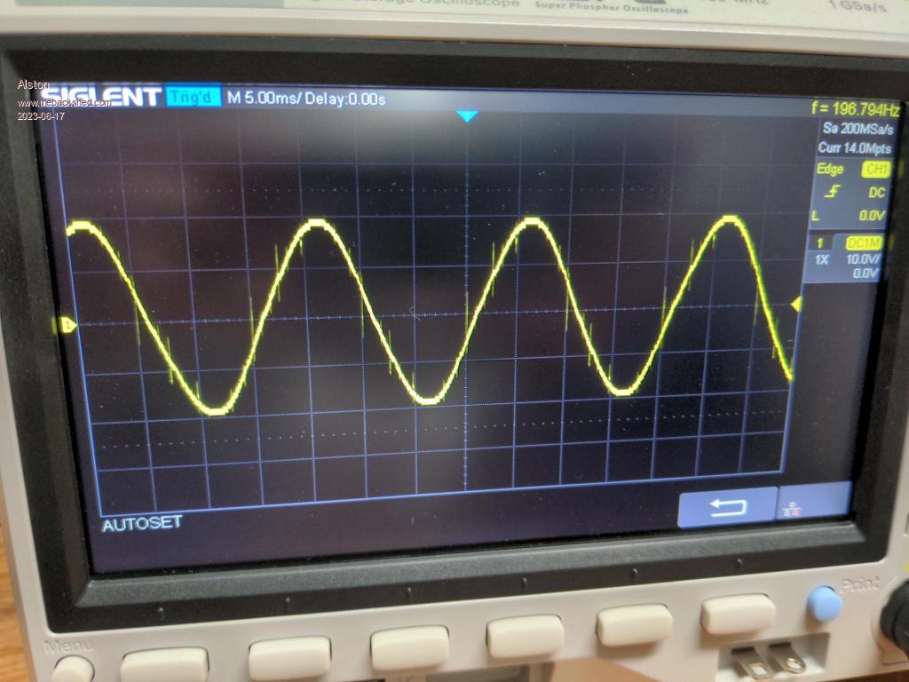

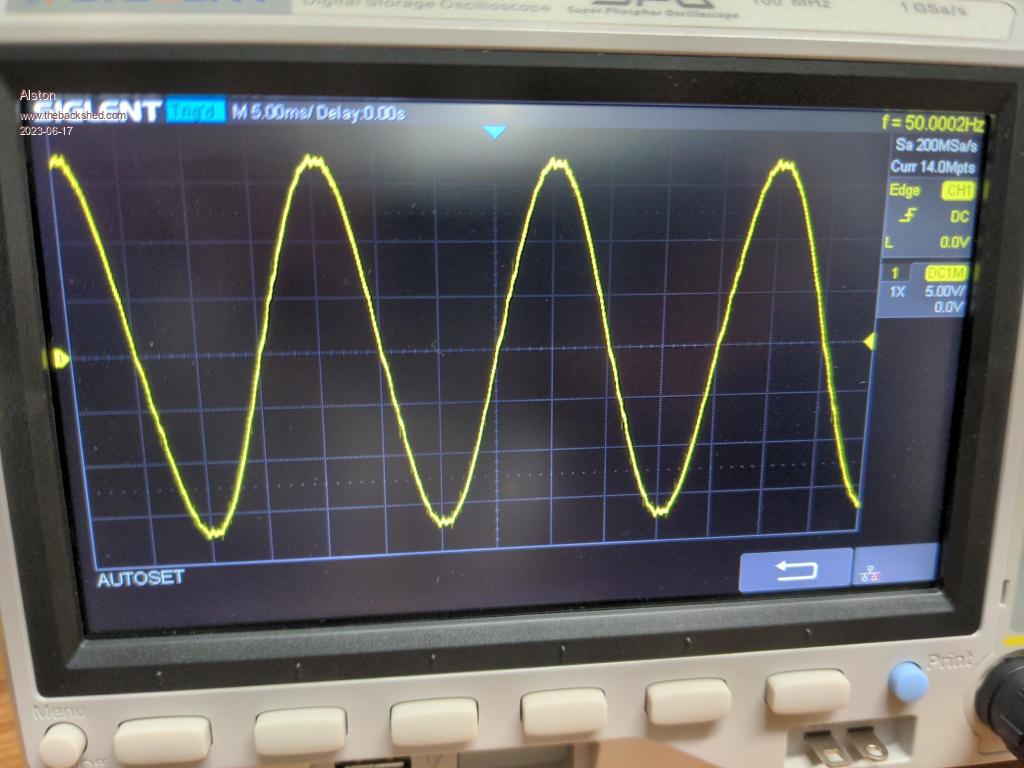

Posted: 09:21am 17 Jun 2023
So the inverter draws 23.5w idling, happy with that result! I was looking at the output and with no line filtering and the waveform has various spikes and after fitting one of the Aerosharp line filters it's much better. Klaus did you just fit 3 of these to yours or buy a more suitably sized filter?
Before line filter
After line filter

  Alston said  Klaus did you just fit 3 of these to yours or buy a more suitably sized filter?
Looking good Paul, I bought a 20 amp filter. You could try 3 x 7A first.
Check the AC voltage regulation when big loads are switched.
