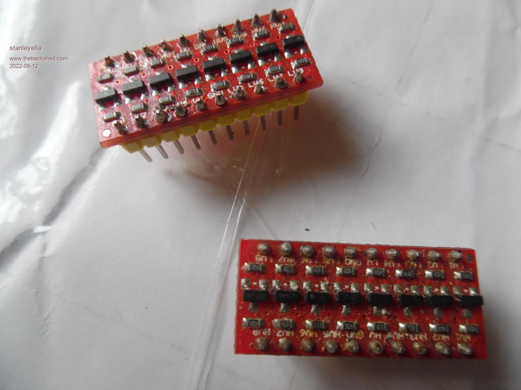

  phil99 said  "I may try using a separate SD adapter wired to the SPI and see what happens."
Which type of adapter are you using?
The ones with a level shifter IC and 3.3V reg. will often work on the Pico if they have their own SPI bus but work intermittently if at all on a shared bus. To protect the Pico it must be fed from 3.3v not 5v so the SD gets 3V at best. Losses in the level shifter don't help either.
For System SPI you want a simple pin-to-pin type.
I use these as other pic stuff I do is 5V logic, usually.
Bi-direction logic 3.3V logic to 5V logic or 5V logic to 3.3V logic.
Not needed for pico display. Pics can run at 3.3V, Arduino it slows clock speed.
