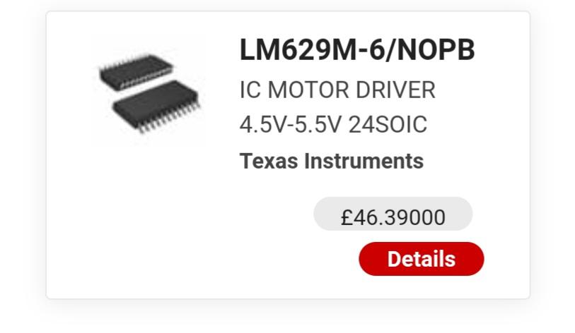

  JohnS said  So the P1 with FlexBasic would do it?
It's not cheap, though :(
Where are they manufactured? Need to take likely future availability into account...
In my case it's peanuts. A single P1 can easily out-perform four of what is commonly used:
I used to have six of these on a board to handle six axes. Even the old P1 is capable of double the motor command resolution (13bit vs 12bit) and there are still plenty of cogs to spare.
Another cog might be handling 4 full-duplex UARTs @115KBaud.
Another cog might be handling VGA.
Ten quid is nothing when you consider the on-board capabilities.
