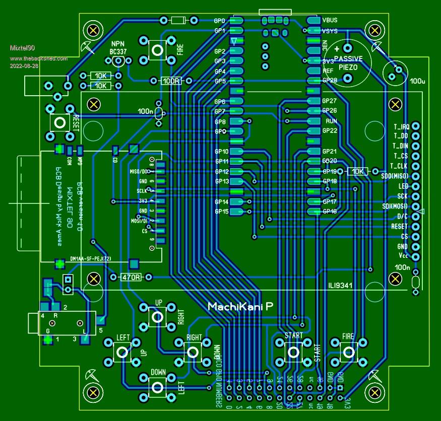

Hokay... If anyone wants to have a play on a custom PCB, here it is.
I've kept very closely to the original circuit apart from the audio side. I can't find any BOM and, since he appears to get different frequencies, I've assumed that it's a passive piezo sounder. Some of these seem to be magnetic rather than piezo and the Pico can't handle the current so I've introduced a transistor to handle the sounder current. I've also put a solder blob link as I assume most people will be using a stereo jack and will want the sound on both channels rather than just Left. If you are using a mono jack you'll have to cut the link.
All the original I/O is available, but I've kept the Pico GPIO numbers as we, on this forum anyway, will find them more sensible.
I've only got the same info on this as anyone else, so it's doubtful if I'll be able to help with any support that isn't a PCB mistake. :)

Mick , thank you for the design. All great work. Gonna order a couple or three , see where the price break is. Not sure it's something I will use a lot , but I like your board so will make one (or 2).    Jack.

If you order from JLCPCB yu can get five boards for not much (Lizby said about $6.38 but I'm not in the US). Very easy to order from them too. They fit into the "special offer" size of 100mm x 100mm.

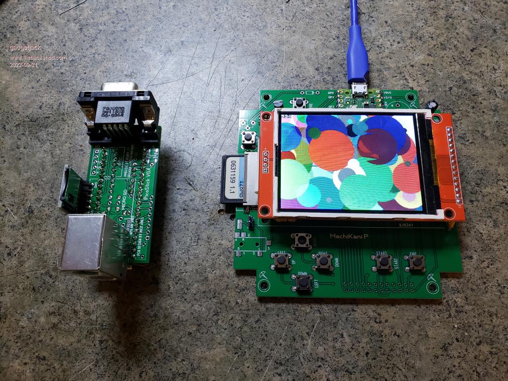

To Mick , I got one of each board built and tested. Working great! Thank you for the great designs.

Mick , yes I have ran all the samples that came with the basic package and converted the colored circle program from the basic here. It does ok , but not quite in the same league as pico-vga or cmm2. Still a neat toy on a very nice pc board.

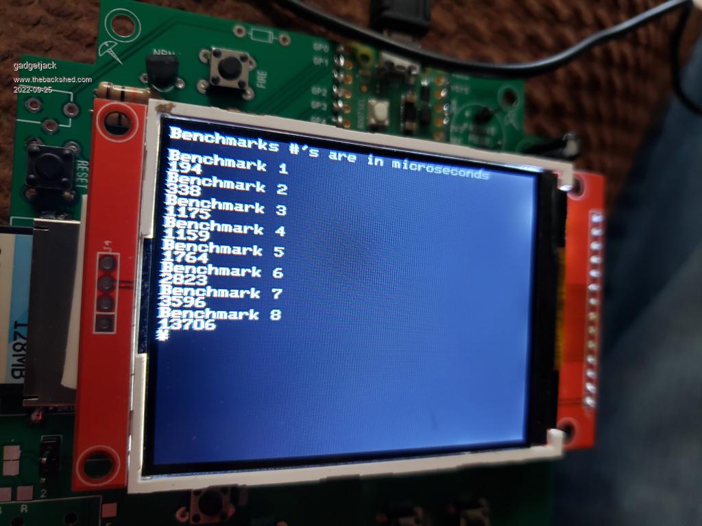

Mick , I tried my best to convert the benchmark tests to this little "compiler". Darned if I can figure out even the basic timer function. The user manual is very vague. None of the example programs use the timer so they are no help. Programming anything past a very basic block game is gonna be hard , so probably not a good game platform. I think I will stick to the cmm2 for any games. Still got a nice looking board for this "possible compiler". I tend to agree with you , more like a tokenizer from what i can see. Not as fast as I first thought.
Jack
Posts: 9329
Posted: 07:28am 24 Sep 2022
For the Type P system CORETIMER seems to be a 1MHz interrupt by default. You can't change it as it's synchronized to the clock.

Mick , thanks for the help with the timer. That was driving me nuts. I finally got the 8 benchmark tests to run. Have to say , kind of impressed. The picture shows the screen after run , and it is in microseconds. I like the idea of using  the extra boards for picomites ( even though i have 3 with lcd and 2 with vga output, so far).If you want the basic test I ran I can send it , was a bit long for this post with the picture in it.

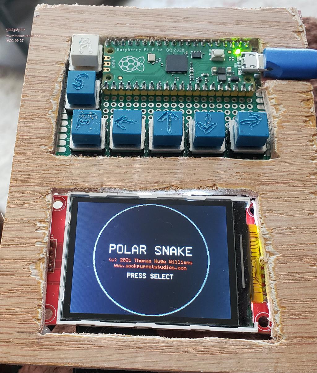

I took the hard wired prototype board and loaded mmbasic on it. I converted the snake game to use the buttons and it plays pretty well. So the extra boards I have can be used for games and stuff beside the little compiler basic. Thanks Mick.

Brilliant! :)  I particularly love the sophistication of the plywood enclosure, although the fine engraving detail on the buttons gives the system a certain je ne sais quoi. :)  The final touch of hot glue is merely gilding the lily, of course.
No problem, I'm glad the boards are ok. :) The design is supposed to fit into a Hammond 1593W case, but some messing about with pcb spacers and button extensions would be needed.

All left over parts from my last job. Kind of a pack rat for that stuff. I used the wood to keep from breaking all the wires between the display and the perf board. Ok , the burnt buttons was probably a little back woods engineering , but it was quick. Mick made a great board for me ,  and I have 4 more , but that prototype did work ok to try the design. Jack
