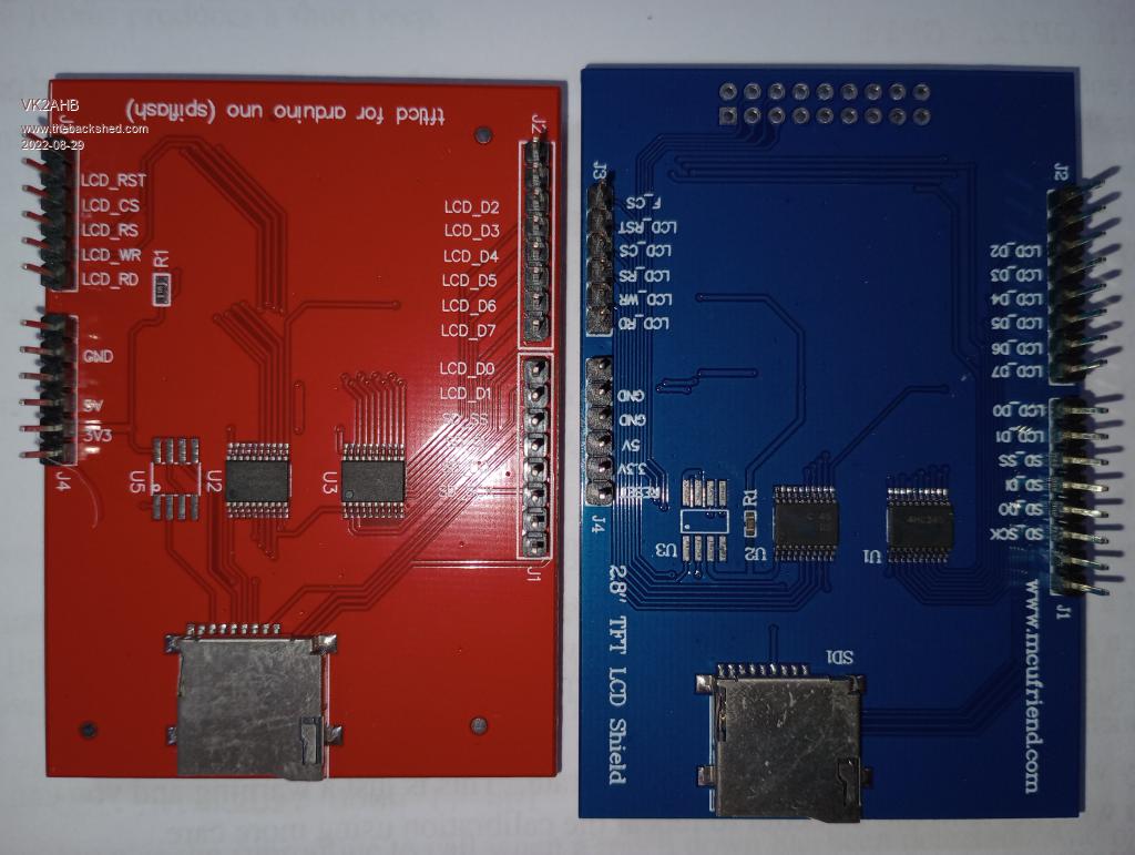

Another problem I have is the LCDs I'm using aren't labelled the same as on P47.
One is a MCUFriend (blue) , the other is tftlcd for arduino (spiflash) (orange).
Anyone using these?
Paul
Posts: 12185
Posted: 07:40am 28 Aug 2022
  Quote  One is a MCUFriend (blue) , the other is tftlcd for arduino (spiflash) (orange).
Pics? Then we can see if they are supported

Posted: 12:42am 29 Aug 2022
I upladed a photo, where did it go?
Paul
VK2AHB
Joined: 28/07/2022
Posts: 51
Posted: 12:45am 29 Aug 2022
I'll try again...
Posts: 12185
Posted: 06:56am 29 Aug 2022
Both these displays are wired parallel (not SPI) and are not supported on the PicoMite

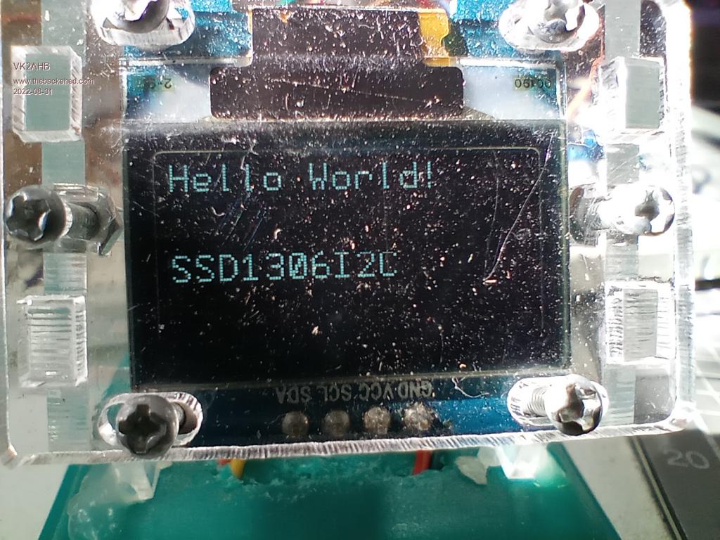

Posted: 12:09am 31 Aug 2022
Small Steps.

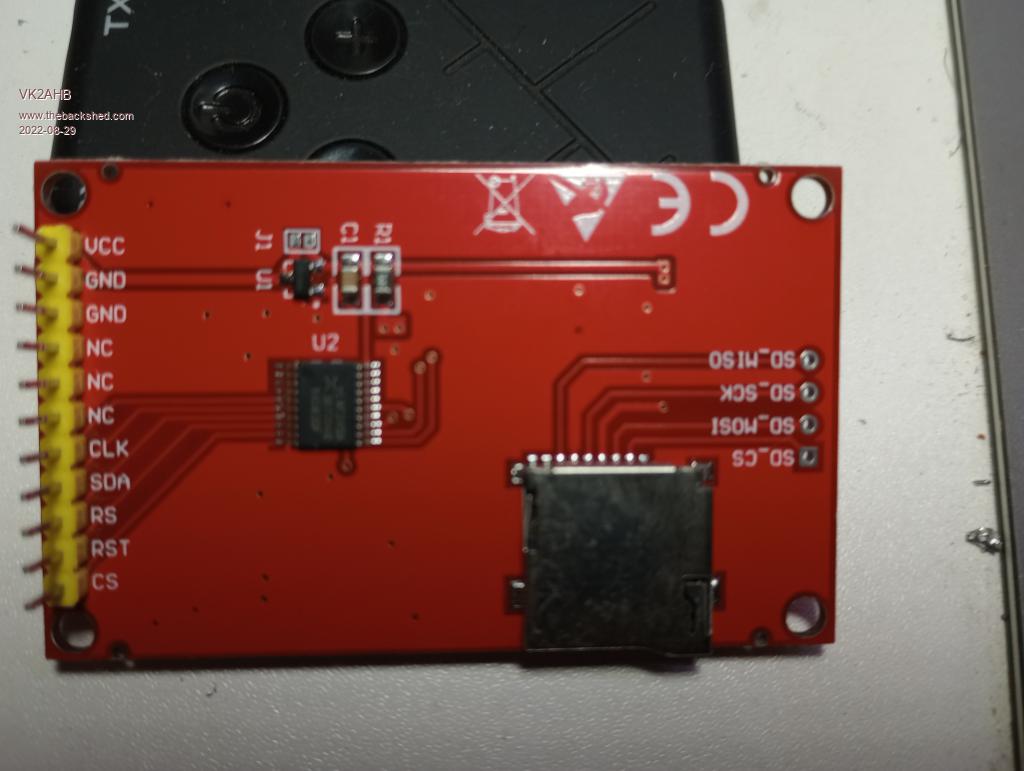

I tried connecting the ST7735 with CS, RST and RS but didn't work. I then hoped that I could configure the display as ST7735I2C but no luck.
I then dragged out the OLED display and confirmed that it was SSD1306I2C. It performed the Adafruit graphics test with the Arduino. So I plugged it in, configured it and got this!

B-b-but when I did that, it said SPI not configured. Looking at the SPI manual
I configured SPI2 with GP28, 27, 26. But then, what parameters to SPI OPEN?
And how do those pins relate to DC, RST and CS?
I really need some assistance in getting this going.
Sorry!
Paul
Posts: 12185
Posted: 07:13am 04 Sep 2022
  Quote  I really need some assistance in getting this going.
Follow the manual as though the display was a ILI9341 but substitute ST7735 in the OPTION LCDPANEL command - see the section "Example LCD Panel Configuration"
Posted: 07:16am 04 Sep 2022
What does OPTION LIST give you?
I suspect that you don't have OPTION SYSTEM SPI set.
You need to set:
OPTION SYSTEM SPI CLKpin, MOSIpin, MISOpin
OPTION SDCARD CS
OPTION LCDPANEL ST7735, OR, DC, RESET, CS
OPTION TOUCH IRQpin, CSpin
The system does the opening etc.

Posted: 10:11pm 04 Sep 2022
If I am looking at the correct image, your ST7735 is a 3 wire SPI display.
Connect SDA to MOSI and leave MISO unconnected.
You will be limited in some graphics capability because you can't read data from the ST7735 module.

Posted: 02:01am 05 Sep 2022
Hi Jim,
Thanks for that, but I am still in the dark :-)
With a new install of the firmware, I do
1. OPTION SDCARD GP13, GP10, GP12, GP12 ** This is instruction on the VGA board
2. Now what? OPTION SYSTEM SPI xx,yy,zz?  Can you give me actual numbers please?
3. OPTION LCDCARD RL, aa,bb,cc  Which is MOSI? The display has CS, RST, RS SDA, CLK.
I tried OPTION SYSTEM SPI GP2, GP3, GP0. is that right?  Flying blind here.
Then tried OPTION LCDCARD various TX and RX pins, told pins are reserved on startup.  Maybe the VGA version doing that??
Paul
Posted: 02:28am 05 Sep 2022
The VGA version of the picomite doesn't do LCD displays so forget anything you read there.
Start by clearing out any options you have set with
OPTION RESET
Then
where you tell the pico which pins you have chosen for CLK MOSI and MISO
Which pins you are using is up to you. There are a few choices.
The SD card, if used will share the SYSTEM SPI pins, you just have to tell the pico which additional pin you used for the CS.
OPTION SDCARD CS
Next it's the display:
OPTION LCDPANEL ILI9341, orientation, DCpin, RESETpin, CSpin
You choose which pins you use for DC, RESET and CS
Your panel doesn't have MISO available but it has to be specified under SYSTEM SPI. Connect SDA to MOSI and leave MISO unconnected.
There is also an optional backlight control pin which gets added to the OPTIONs
Its further down the manual under 'Backlight'
  Quote  ', backlight' can be added to the end of the configuration parameters
which specifies a pin to use to control the brightness of the backlight.
If your display does have the backlight pin, it may be 'inverted'
Once the display is configured try BACKLIGHT 50 to set it half way then try BACKLIGHT 90 or 10 to see which way increases brightness.
I don't think your module has a backlight control.
If your panel has touch, you will have to configure it as well:
