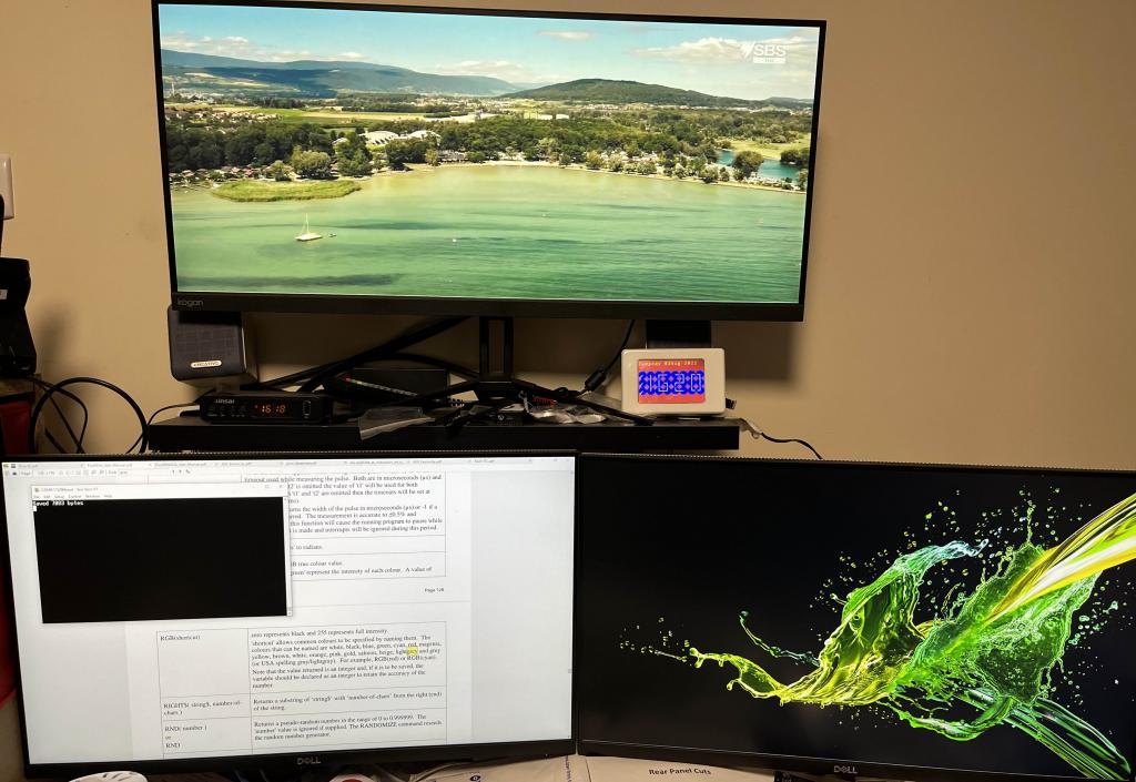

Here is a picture of near where its final resting place will be.

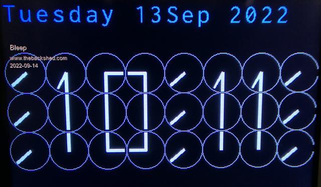

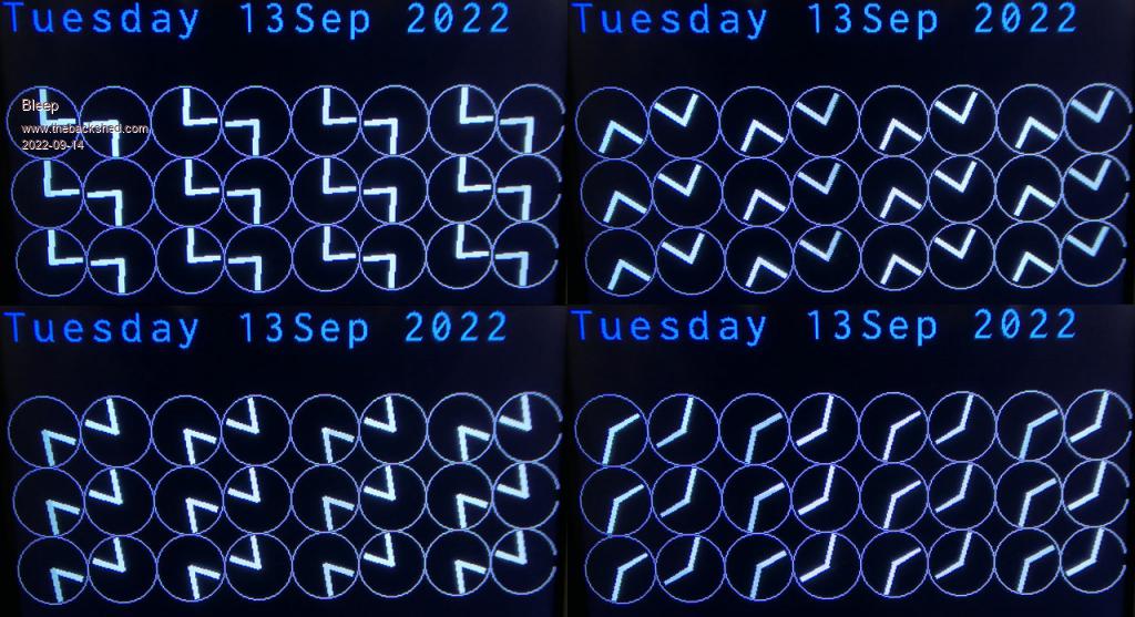

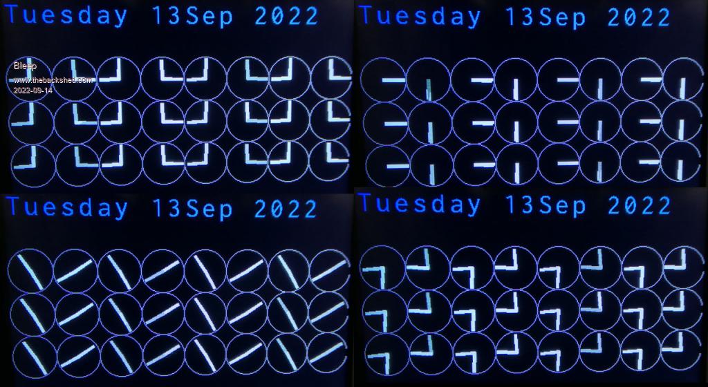

Posted: 12:51pm 14 Sep 2022
A few pictures for the new number layout and some of the various animations.
This shows the new layout when a '1' digit is being displayed.
Some shots of the clocks in mid animation.
Regards Kevin.
