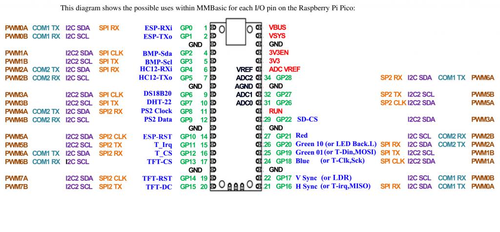

I changed the configuration for my setup as follows:
'MICKS CONFIGURATION
LCD_DC=MM.INFO(PINNO GP15)
LCD_RST=MM.INFO(PINNO GP14)
LCD_CS=MM.INFO(PINNO GP13)
SD_CS=MM.INFO(PINNO GP22)
T_CS=MM.INFO(PINNO GP12)
T_IRQ=MM.INFO(PINNO GP11)
MYSPI=1   '2 id using spi2 pins
SPITX=MM.INFO(PINNO GP19)
SPIRX=MM.INFO(PINNO GP16)
SPICLK=MM.INFO(PINNO GP18)
I have checked and triple checked I think I set all of the PINNO correctly. This is the list of the Pin Allocation on my PCB. Note My allocations are in Dark Blue
The Result with the ILI9488 returned a very similar result, the only difference was the TEMP values which were close but a few numbers off
I think the RESET/ID &H04 HEX should not return all 0 for all four positions
Is there some other setting I need to make in your code?

Hi Mick,
Looks like it talks to the TOUCH OK as it can read the temperature.
Did you have MISO from the display connected.
Your config seems to match your wiring.
I have added a couple more reads below, just put them after the read of the ID.
I would first concentrate of getting the ILI9341 to return some values other than 0 to fully prove your wiring. This display works? so just make sure it can be read i.e. MISO is OK. I suspect it wont successfully do a BLIT.
If you can get it to read then try the ILI9488/ILI9481

Hi All,
I buzzed out Miso and it is indeed connected through to Pico pin21 (GP16)
@Gerry,
I have added those 2 chunks of code and this is the output on my ILI9341 display (yes with MISO connected)

I think we have confirmed that MISO is connected and working we just need to wait for Peter to get a driver going if he can.
I do have a second display I guess I should tear its baggie open and try it.
I will shoot myself if that works.
