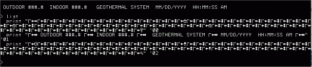

Suppose I want to print this with MMBasic for Windows:
? OUTDOOR ###.# ? INDOOR ###.# ?  GEOTHERMAL SYSTEM ? MM/DD/YYYY  HH:MM:SS AM ?
I load the program:
print "???????????????????????????????????????????????????????????????????????????????"
print "? OUTDOOR ###.# ? INDOOR ###.# ?  GEOTHERMAL SYSTEM ? MM/DD/YYYY  HH:MM:SS AM ?"
RUN, then LIST gives me this, with the characters over 127 stripped out:
I can get the box characters with this:  print chr$(201);: for i=1 to 76: print chr$(205);: next i: print chr$(187)
 print chr$(186);: for i=1 to 76: print " ";: next i: print chr$(186)
 print chr$(200);: for i=1 to 76: print chr$(205);: next i: print chr$(188)
Is there some code page or other magic I can use to make the straight print of the PC graphics characters within a quoted string work?

No: Characters over 128 are tokens so can't appear in a program

  matherp said  Characters over 128 are tokens so can't appear in a program
Ah--makes sense. Thank you. I knew there was some restriction for character values above 127, but had forgotten the reason (if I ever knew).

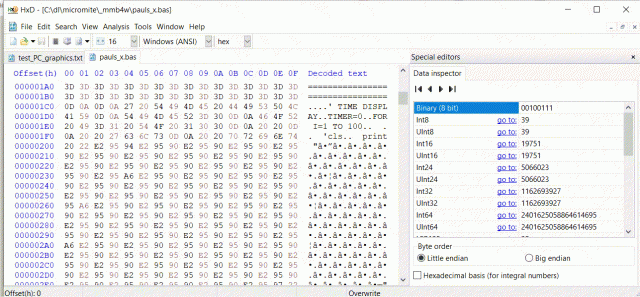

But I have a question for you (or anyone else). The files which Paul has sent me which show up as proper PC graphics drawing characters have those characters actually encoded as UTF-8 triplets, where the first 2 characters are 0xE295 and the third designates which E295 character is encoded. (Looking with the hex viewer HxD.)
How do I save this file so that the 3 characters are converted to the appropriate 1-character above-127 value?

  lizby said  How do I save this file so that the 3 characters are converted to the appropriate 1-character above-127 value?
Not something I've ever done, and also I don't recognise 0xE295 as being particularly magical from what I have done with UTF-8.
I suppose it may depend on exactly what code-page you mean by "PC graphics drawing characters".
Can this help: https://www.motobit.com/util/charset-codepage-conversion.asp ?
Could you attach an example file ?

That's why I want to convert from UTF to a straight 8-bits per character format. Then I can play further to see how to deal with it.
So, a file written by MMB4W with the graphics characters in it can be read back and printed and they print correctly:
So my question is, how can I write a UTF-8 encoded file so that it's just plain 8 bits per character?
Edited 2022-06-22 00:55 by lizby

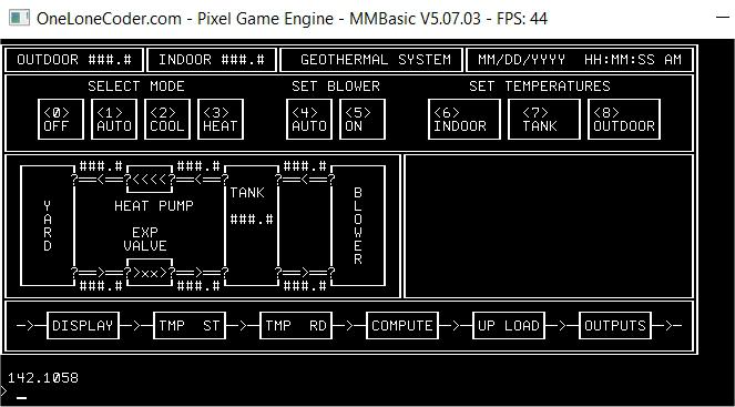

Now we're getting somewhere--thank you very much, Tom. That conversion site did the trick--convert UTF-8 to ibm852.
So UTF-8 text (if the forum doesn't do something to it)
converts to ibm852
ษอออออออออออออออหออออออออออออออหออออออออออออออออออออหอออออออออออออออออออออออออป
บ OUTDOOR ###.# บ INDOOR ###.# บ  GEOTHERMAL SYSTEM บ MM/DD/YYYY  HH:MM:SS AM บ
ฬอออออออออออออออสออออออออออออออสออออออออออออออออออออสอออออออออออออออออออออออออน
And if I read it in to MMB4W with "a$=INPUT$(255,#1): PRINT a$", I get this:
Again, thanks very much, Tom. I think this puts me on a path to further investigation.

  thwill said  You read in bytes from the file and feed them through a finite state machine that parses the 2,3 and 4 byte UTF-8 sequences . . .
But with the conversion to ibm852 (one-time), you don't need to do anything if you have a file to read. Easy-peasy:
(The 142 at the bottom says the program is clearing the screen and writing it 100 times in 142 milliseconds.)
