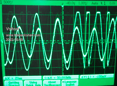

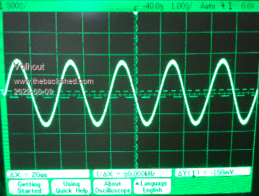

This first picture is a single tone (play sound 1,b,s,500). Each horizontal grid line on screen is 0.5V, so the amplitude of the sinewave is 3.2 x 0.5 = 1.6V.
When you add the second tone (play sound 2,b,s,550) the signal is added to the first. If you add up 2 sinewaves with different frequency there will be moments in time where the voltage is summed up, but in other moments the 2 cancel eachother out. (you can try on MMBasic by drawing a graph of 2 added sinewaves with different frequency)
In this graph you can see that the sum of both sinewaves has an amplitude of over 3V. And this is generated by the PWM on the output pin of the pico. This pin has only 0V and 3.3V levels. So it is at it's max.

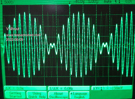

The next waveform is what happens if you add a 3'rd sine wave. (play sound 3,b,s,600) The signals sum up to 4.5V, and the pin can only drive 3.3V. What happens is that you get a numerical "wrap around" for +3.3V to 0V. You can clearly see that in the right side of this (zoomed in) waveform. At some point the signal is clipping at 3.3V, and at some point there is a wrap around to 0V. This is an immense distortion that sounds like chirps, with a repetition rate of few Hz. If you add a 4'th it is only getting worse.

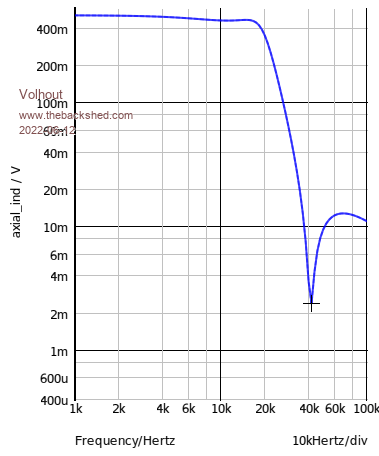

A better solution would be to layout a single 2e through hole capacitor, use 4.7nF, and solder a surface mount 1206 of 1.5nF at the bottom between the through hole solder pads. That would also allow for the (under investigation) 150 ohm driven filter that only uses a single capacitor.
This is the response...(I love it)
The issue with 150ohm is that the P-FET in the pico, and the N-FET in the pico have different impedances, there will be linear distortion. I have to check if that is at an acceptable number (I can calculate/simulate the number, but that doesn't say anything, I will listen to WAV played from the SD card to see if it is enjoyable).
P.S. get me a link to the RS part you plan to use. I'll run it though the simulation.
Edited 2022-06-12 18:02 by Volhout
Posts: 9329
Posted: 08:33am 12 Jun 2022
Wow... that's a lovely response! As near to perfect as anyone would need. :)
