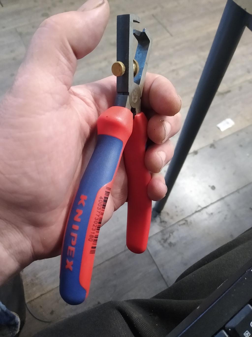

Posted: 07:42pm 08 Jun 2022
Hmmm, Ben Eater is recommending the wrong wire-stripper (Knipex Automatic) for this gauge of wire. I have the exact same device and love it but only for heavier gauges.
The above is far superior but you certainly don't need to pay Knipex prices
Edited 2022-06-09 05:45 by Tinine

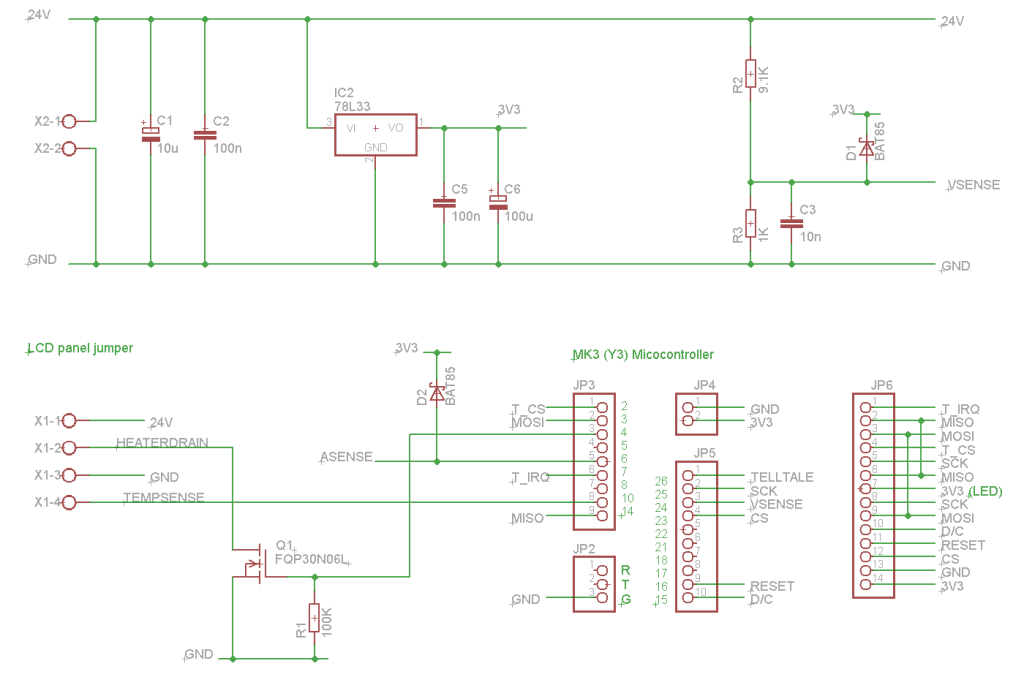

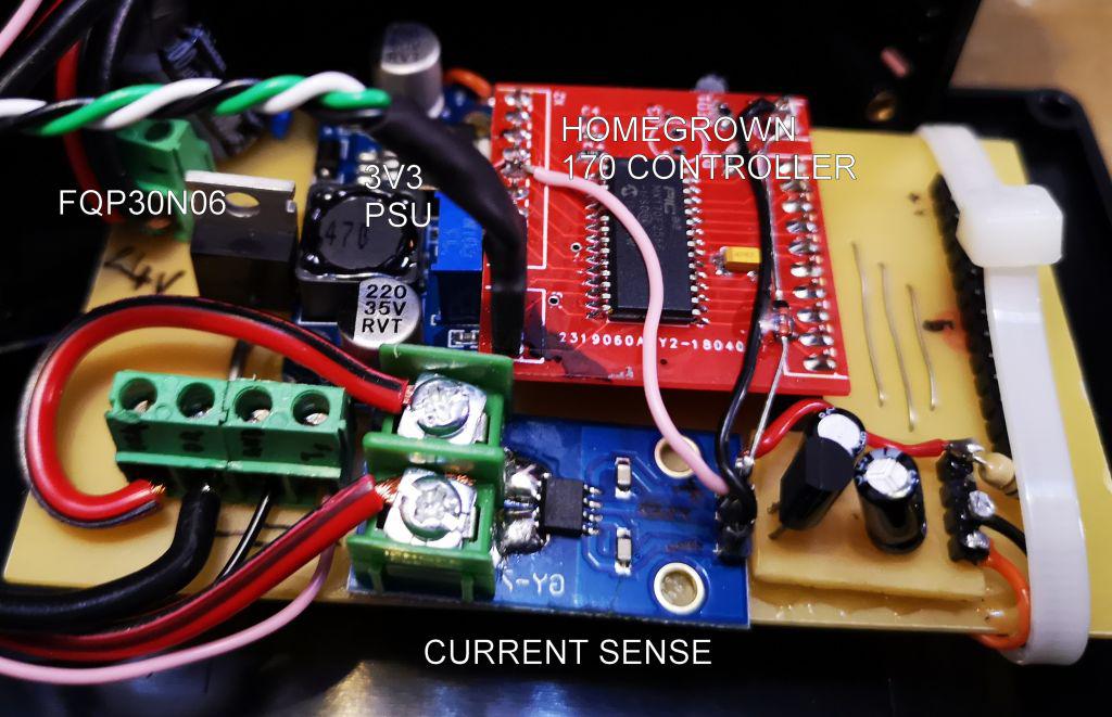

Posted: 08:16pm 09 Jun 2022
  Tinine said
Would love to replicate what the Cap'n has going
I have no schematic coz I just whipped it up on my bench. I will open it up and take photos (the horror! the horror!)
Posted: 08:52pm 09 Jun 2022
OK, I lied. I did do a schematic... no surprises:
and I just opened it up and took this photo - R1 is omitted as I suspected.
and I did this little vid of the thing in action (may still be processing on YT)
https://youtu.be/l5ljYgYmCIk
hope this helps
Edited 2022-06-10 06:53 by CaptainBoing
