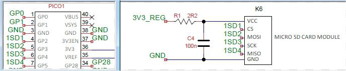

I'm confused about the setup for the SD card on Pico1. I would have thought that it would have been OPTION SDCARD 4,5,6,7 (SCK, MOSI, MISO, CS) but the circuit seems to indicate OPTION SDCARD 6,5,7,4. What should it be?
UPDATE: Ok, now I see printed on the bottom OPTION SDCard GP2,GP4,GP3,GP5, so OPTION SDCard 4,6,5,7 (and that works).

It seems to be
CS - GP2
SCK - GP6
MOSI - GP3
MISO - GP7
No matter what the circuit says. Sometimes it tells lies.  :)
I'm wondering if I put the wrong version of the circuit in the construction pack - or if I'm looking at the wrong SL6 file. The above have come from the SL6.
Note that it's the same for both Picos. This is a version 0.2 board I'm looking at.
Edited 2022-08-10 03:22 by Mixtel90

  Quote  OPTION SDCARD 4,5,6,7 (SCK, MOSI, MISO, CS)
SDcard is CS[, clk, mosi, miso]
Edited 2022-08-10 03:34 by matherp

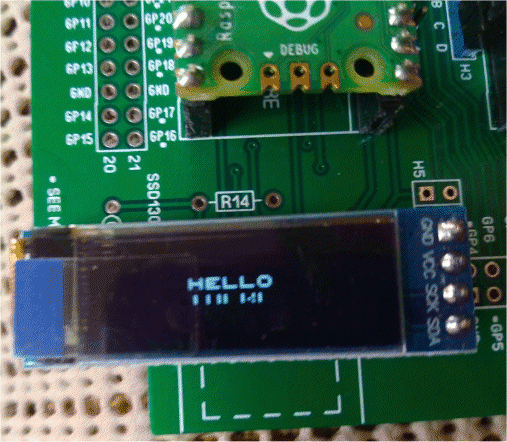

option system i2c gp16,gp17 followed by option lcdpanel ssd1306i2c,rl,2 also works, but there's some wierdness with the text--some of the pixels are not displaying.
> cls
> text mm.hres/2,mm.vres/2-15,"HELLO",cm,1
> text mm.hres/2,mm.vres/2,"THERE",cm,1

Is there a bit offset value to tweak for that display? IIRC there is on the one I used.

Correct display type for this display is SSD1306I2C32
Posted: 11:31am 10 Aug 2022
  matherp said  Correct display type for this display is SSD1306I2C32
Thanks--that did the trick.

Mick--what is the purpose of the 2R2 resistor at R1 (power to the SD card)? I didn't have a 2R2, and after looking at the circuit, I just inserted a Dupont wire with pins on each end, not soldered, and the SD card worked. What am I risking if I just put a link at R1?
Posts: 9329
Posted: 12:17pm 10 Aug 2022
It will often work fine with the 2R2 linked out. Often without the capacitor either. However, there have been issues with *some* combinations of firmware and some SD cards where writes (usually) had problems. Peter originally introduced the CR filter (on the CMM2) as a way to fix this. He used 10uF bypassed by 100nF with a 2R2 resistor. If your SD card works then fine. you don't need the resistor at least. :) It may be worth keeping a capacitor though as some cards can draw relatively high current sometimes.
