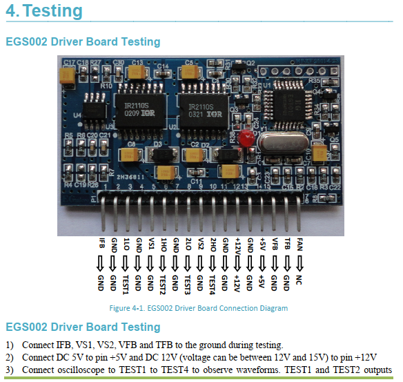

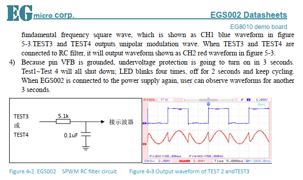

The low side and high side Gate drive for the 50Hz squarewave (fundamental)
are pins 3 and 6 respectively.
from the EG002 pdf:

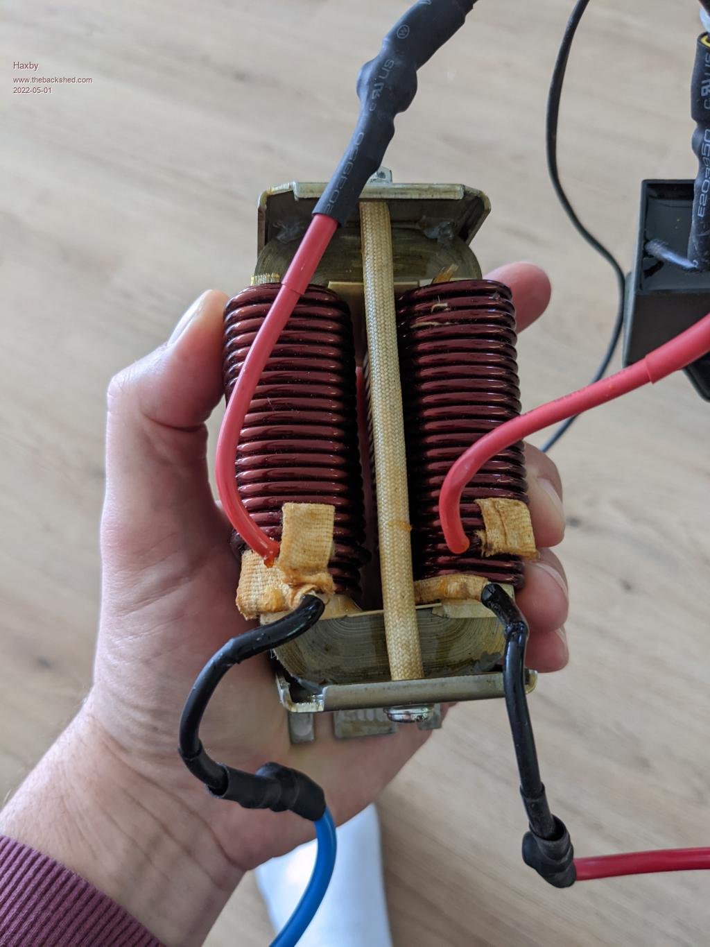

Somewhere in this forum, someone suggested a brilliant idea: one choke per MOSFET half bridge, with multiple chokes on one side of the transformer. This eliminates the issue of having to turn on multiple paralleled MOSFETs together at exactly the same time. I've looked but can't find the original thread. It might have been Mark or Klaus.
I'm wanting to experiment with this idea. I have an aerosharp choke that is labelled 3mH, 20A, and has two separate windings. I ASSUME that means each winding can handle 20A and each winding is 1.5mH. (is that right?)
If I drive each winding simultaneously with matching half bridges, will the single choke act as two separate chokes?
I'm thinking if so, I won't have to unwind it. I could just make the gap a bit bigger to decrease the inductance.
