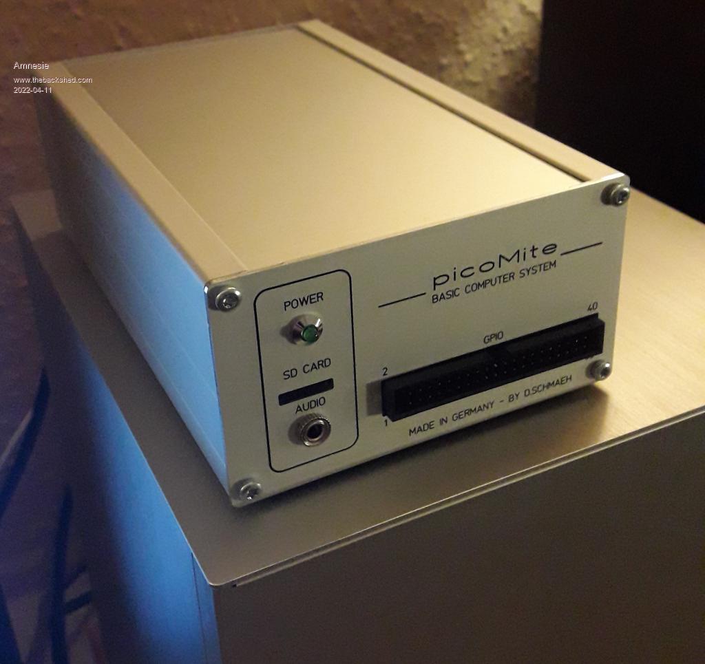

Yes I am planning a lot of projects in this way and CNC-milled some cases for this purpose and made a whole new set of PCBs. I LOVE the PICO :) Our laboratory at university got one, too ;)
Edited 2022-04-11 06:23 by Amnesie
Posted: 09:12pm 10 Apr 2022
Neat case. Glad to see the 2x20 connector. What's it look like inside?
