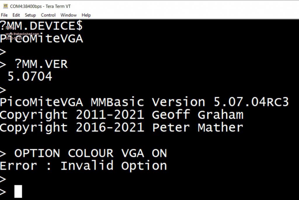

I have tried to colors on the VGA, but w/o success.
Tried with 2 different Picos with the same result.
/Fred

See the first post on the thread

OPTION COLOUR VGA ON|OFF replaced by OPTION DEFAULT MODE 2|1 solved my problems.
Thanks Peter!
/Fred
