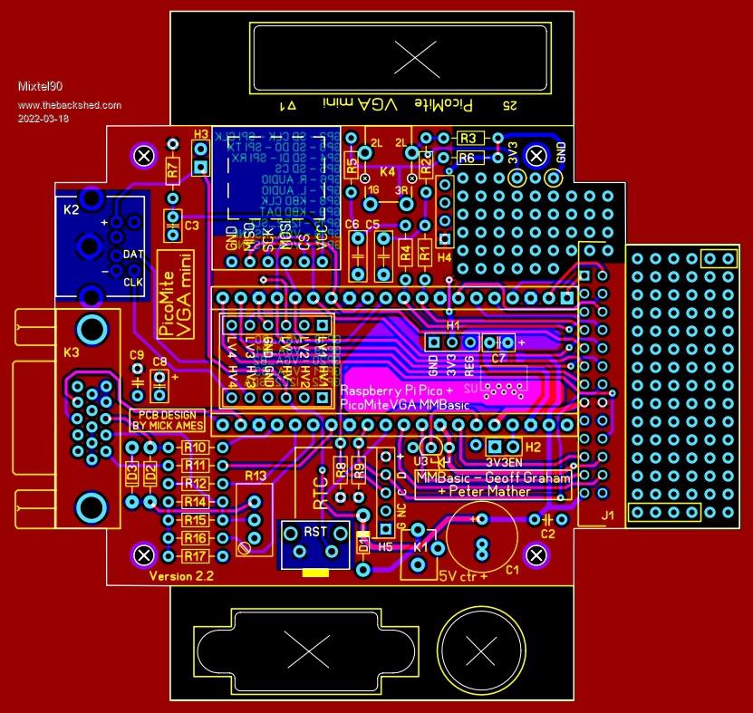

If what you want is a small (80x65mm) board to take a PicoMite VGA, then I already have a design - but it's the existing VGA system, not some enhanced version so sorry, no Doom. If you need more IO then just leave some of the other stuff off. :) You can do the same with Peter's (more expandable and a little larger) design.
PicoMiteVGA22_gerber.zip

Hmmm... wonders if there would be a case for putting the I2S audio chip on the above board. Would anyone support such a beast from MMBasic? I2S has the advantage of much better audio, but is completely different to either I2C or PWM.

I have none of the above boards at the moment, but I could probably get some made easily enough (China, of course!). Would you be interested? I have most of the components too so I could build one up. Not a Doom machine though - you'd need the suggested board for that.
Posted: 11:50am 18 Mar 2022
  Mixtel90 said  I have none of the above boards at the moment, but I could probably get some made easily enough (China, of course!). Would you be interested? I have most of the components too so I could build one up. Not a Doom machine though - you'd need the suggested board for that.
I've ordered one of those boards (out of curiosity really, I never got into Doom) but could do with one (2 if they're cheap enough) suitable for VGA PicoMite.
What sort of price would they be?

Depends on what you want. :)
The bare boards wouldn't be much, but components would obviously depend on what you wanted. Is anyone else interested?
I'll sort out the manual, which has a BOM in it.
The bare boards aren't cut - they just have cut lines drawn on the screen printing as they are unsuitable for panelizing unless I split then up into four different boards. That's not financially viable unless I'm doing a lot. I can (usually!) cut them reasonably accurately.
