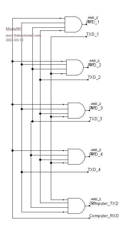

  Mixtel90 said  ... and you'd be back to wired OR. :)
For a network of n nodes every AND gate needs n inputs. \
n-1

Can be replaced by one resistor and 4 diodes.
A current source could be something like this.
Edited 2022-03-13 18:44 by Mixtel90

Heck, thanks for going to the trouble, Mick. I had the AND-gate thing all wrong in my head.

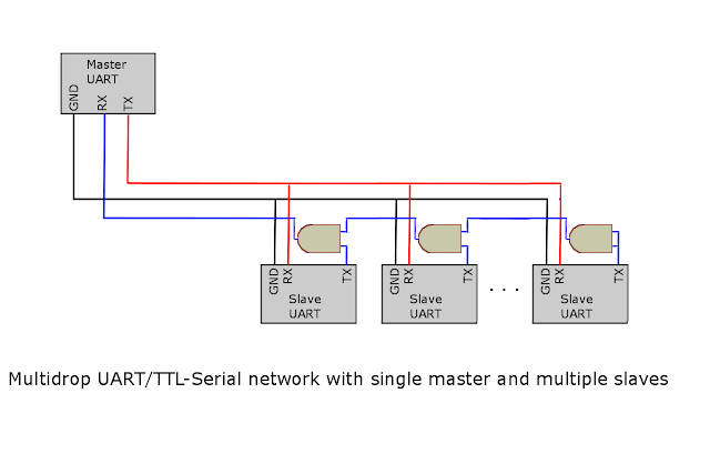

I usually use AND gates in this way:
ALLdataEE.com  EDU Promos
Posts: 6254
Posted: 06:42am 14 Mar 2022
  dMajo said  I usually use AND gates in this way:
That is the way to do it !
The interconnects require a 3 wire cable, so the same system as RS485 can be used. You have firm drivers (the 74HC08) for each line. And all nodes are identical (except address in software). If you want to take this to a bus over longer distance you might want to use smit trigger AND gates and add some low pass filter (RC) at the input to get rid of spikes.
De accumulated delay in all HC08's must be compensated in software (the "turn-around" time cannot be 0) but in general nodes running MMBasic will not be fast enough to suffer from it.

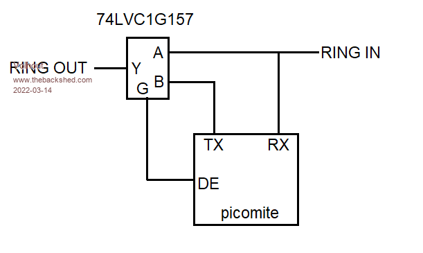

Another alternative has been brought up in the "Beckhoff" thread Tinine started. The UART out can be muxed with UART in under control of the mite. That way you create a ring, where only slaves that recognise their address feed into the ring. The advantage of that topology is that every output is only connected to ONE input. You can use a 74LVC1G157 as mux.
Edited 2022-03-14 17:01 by Volhout

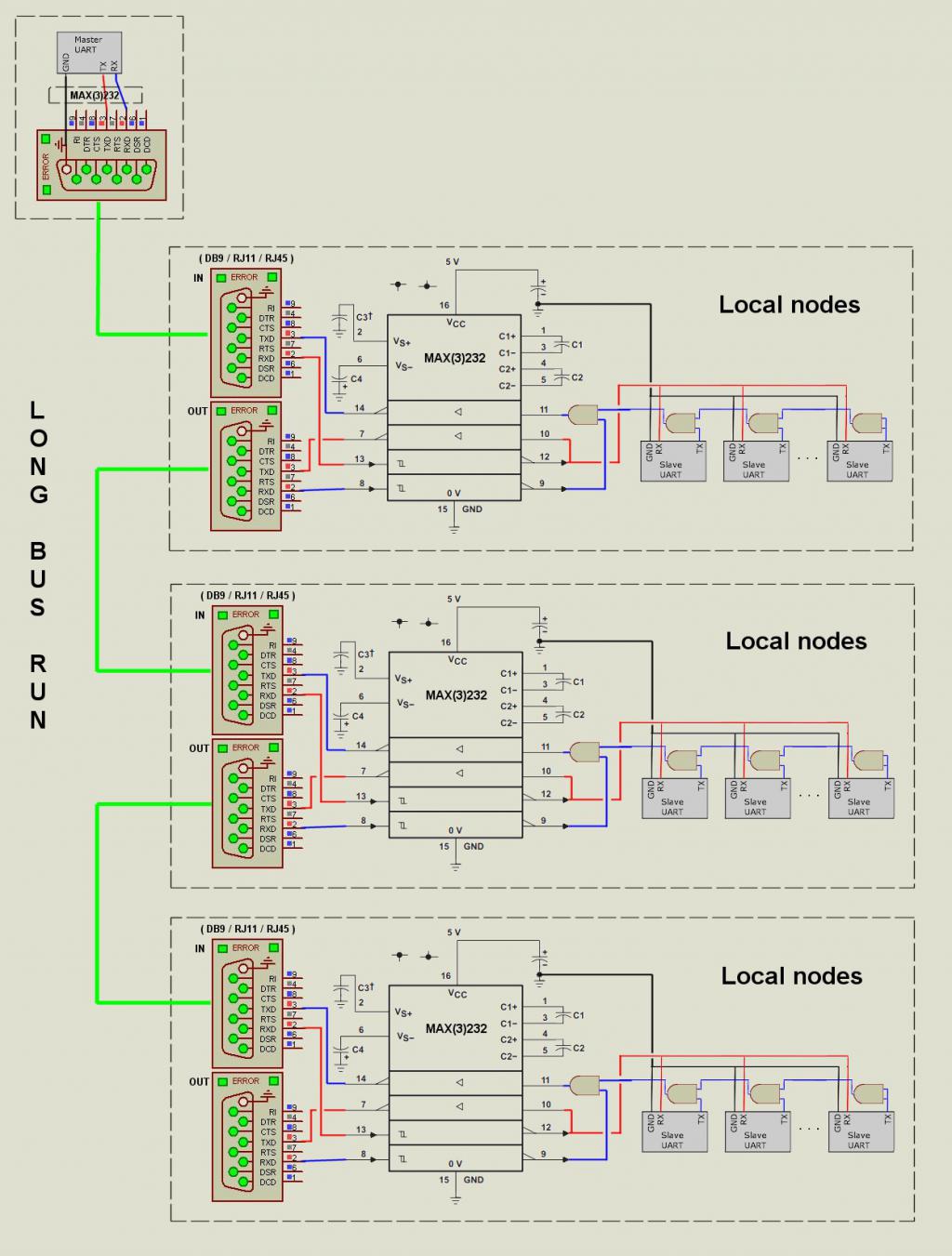

And if you need longer bus runs (10 to 25 meters (perhaps more depending on baudrate) between nodes, each green bus segment) you can use this configuration.
It uses RS232 levels between distant nodes and TTL levels between local (close) nodes.
Between each local block and the other the RS232 signal is regenerated. Take care for ground equipotential.
Sorry for the quickly made drawing using images from this thread.
Edited 2022-03-15 05:55 by dMajo
