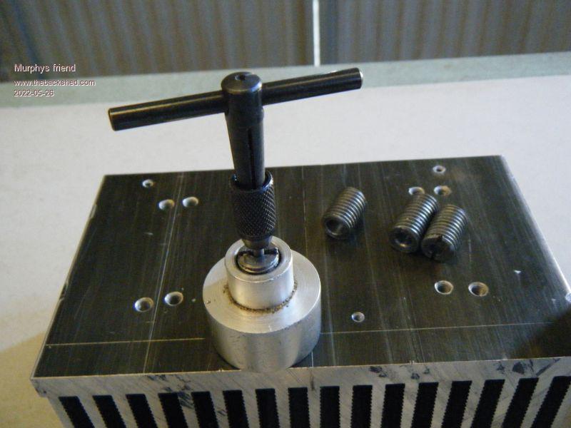

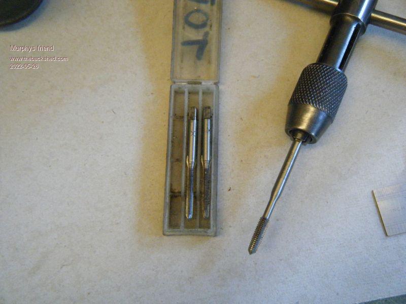

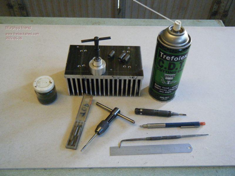

A few more tips Roger.
Google broken tap removal from alumunium and you'll find the alum method. The other method is spark discharge but that needs equipment. Both are *very* slow.
Try to minimise blind holes for tapping by locating them between the fins. I do have blind holes at the heat sink edges but they are M4 or M5.
If you are not full bottle about tapping heat sinks, it was discussed here some time ago or I can give you a rehash.
Drilling templates, I never bother unless I need a dozen or more identical parts.
Mark it accurately, center punch it accurately, drill a pilot hole for bigger holes and you get an accurate result.
Tap drill size: M3=2.5mm, M4= 3.3mm, M5=4.1mm, M6=5mm
You'll find using nuts between the heatsink fins is an exercise in frustration. You could use self tapping screws if you like things a bit agricultural. Would not recommend it for mosfet mounting.
I use half bridge modules for all 4 tx's. There are two half bridges, side by side, on each PCB, these can be linked to drive more mosfets.
So I have 6 identical half bridge power boards, 8 identical half bridge driver boards and 20 small (2 mosfet) carrier boards. All are 1oz copper.
Think about soldering copper bar to the PCB. This requires a *lot* of heat, possibly ruining the board. Better to tin the bar and bolt it on.
I use alu bar bolted on, cheaper and works just as well without having to 'tin' it.
New to PCB design? Well, there are many pitfalls . Suggest you send the simplest Gerber file first and learn from the mistakes that everybody makes too. These become fewer as you progress but never seem to go away .

Murphy's friend
Joined: 04/10/2019
Posts: 678
Posted: 02:54pm 25 May 2022
Nah, don't give up Roger, you are too deep in it already .
The last link above (at the bottom) is what my warpinverter looks like inside, note the way the mosfets mount for easy exchange - I did find that feature very handy later .
I used terminal blocks initially, as seen on some earlier pics. Not a good idea in the end, as the terminal does not survive a blow up very well.
With building 4 inverters in one box it helps to have a compact, easily serviceable design. One chap here tried to fit his in a full size locker , never heard how that went.
I'll take some pics of my tapping stuff tomorrow.

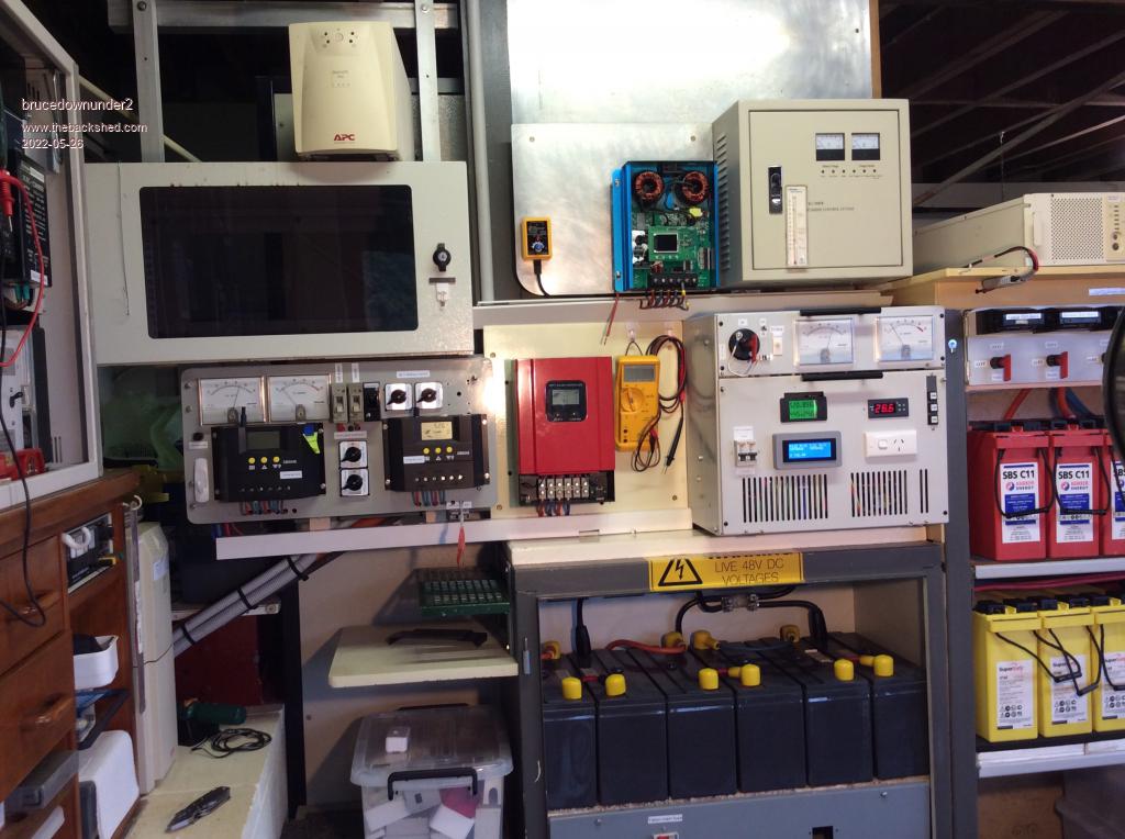

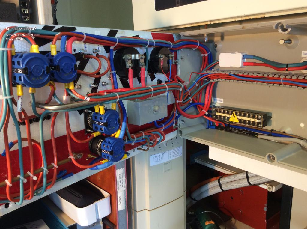

HI Roger.
 Thanks for any help you have assisted us "Fiddlers" with for a start.
 I built my compact inverter with the coil I had made years ago.  I built it with the idea of using the available space
I had available in an Ericsson charger cabinet ,off the scrap heap years ago.
 The main control panel shelf is mounted on two end angle rails that support and allow it to be slid out thefrontof the case ,I found this to be perfect for service and modifying cabling etc.
So, don't give up ,my friend, it's a good hobby and we appreciate good ideas through DIY'ers builds.
My thanks also go to my mate, Aaron , a forum expert in solving my problems.
I'm more apprective of friendship now as my cancer has caused me to surrender my drivers licence.  I never thought how valvuable driving mean't.  (I supper from fatigue through kidney failure, causing "Micro Sleeps".)

As mentioned above, here are some tips about tapping holes in a heat sink.
Its best to use a tap exclusively used for aluminium. If it previously tapped steel or worse, stainless steel, its no longer sharp enough and jams much easier, risking breakage.
Marking & drilling the hole precisely is very important as often the part fitting (PCB, Mosfet) has to line up. My PCB's are laid out on a 100 thou grid so I use a ruler with 20 thou markings - not metric!
First I use a clutch pencil to draw crossed lines where the hole has to be.
Then I use a scriber to pin prick the exact center.
After this a center punch aligns easier with the pin prick mark. I prefer those 'automatic' center punches as they only need one hand but the old fashioned one also works as long as the point is sharp.
The picture shows what I use.
The tap needs to be lubricated, for aluminium kero is recommended but I advise NOT to use that in blind holes. The reason being the kero washes the swarf down the hole and when the tap tip gets there it jams. So I use Trefolex with blind holes. The swarf sticks in the grooves then.
The little jar in the pic holds kero.
The tap wrenches shown are IMO better than the ones that usually come in a tap set as the shorter handles restrict the torque and reduce breakage.
In my experience a tap in aluminium most likely breaks when it is backed out so, if it jams, be patient and turn the wrench slightly back and forth until its free enough to remove.
For blind holes it may be better to use the tap set with 2 or 3 taps, applied in sequence. For thru holes less than 6mm deep the taper tap is my preference.
The tap guide shown is well worth while to have (mine was made from an old floor mounted door stop), it has inserts for different size tap shank diameters.
That tool guarantees a straight tapped thread .
For deeper threads I turn the wrench 2 or 3 times and then back it out completely to remove the swarf stuck in the grooves. Repeat until tapping is complete.
This sounds slow and tedious but boiling out a broken tap is 1000 times slower and ruins your whole day.
And its often not possible to drill and tap another hole next to the broken tap if something that cannot be changed fits there.
So, patience is the word when it comes to drilling & tapping heat sinks.

  brucedownunder2 said  HI Roger.
Thanks for the encouragement Bruce, I think I have enough momentum now to see it through  ...  plus I've spent enough on the bits and pieces that I really need to see a return on it all.
And I'm sorry to hear of your health issues and having to give up your licence, that must be hard to deal with. Thanks Aaron for helping Bruce out  ...  friends can make such a difference when we're having a hard time.
I hope I can get my wiring to look as neat as yours when I get to that stage too  ...
your layout has given me some ideas, along with those analogue meters.
Cheers,  Roger

  Murphy's friend said  As mentioned above, here are some tips about tapping holes in a heat sink.
Its best to use a tap exclusively used for aluminium. If it previously tapped steel or worse, stainless steel, its no longer sharp enough and jams much easier, risking breakage  ...
Thanks Klaus, some really useful hints there. You've almost convinced me to buy a couple new 3mm taps and have a go. My aluminium should be here next week so I'll be abe to get started on the cutting, drilling and tapping soon.
Now I just need to work on my patience.
I'll also attempt to make a couple jigs to help keep the tap square, that seems to be a big issue normally for me, trying to keep everything straight.
