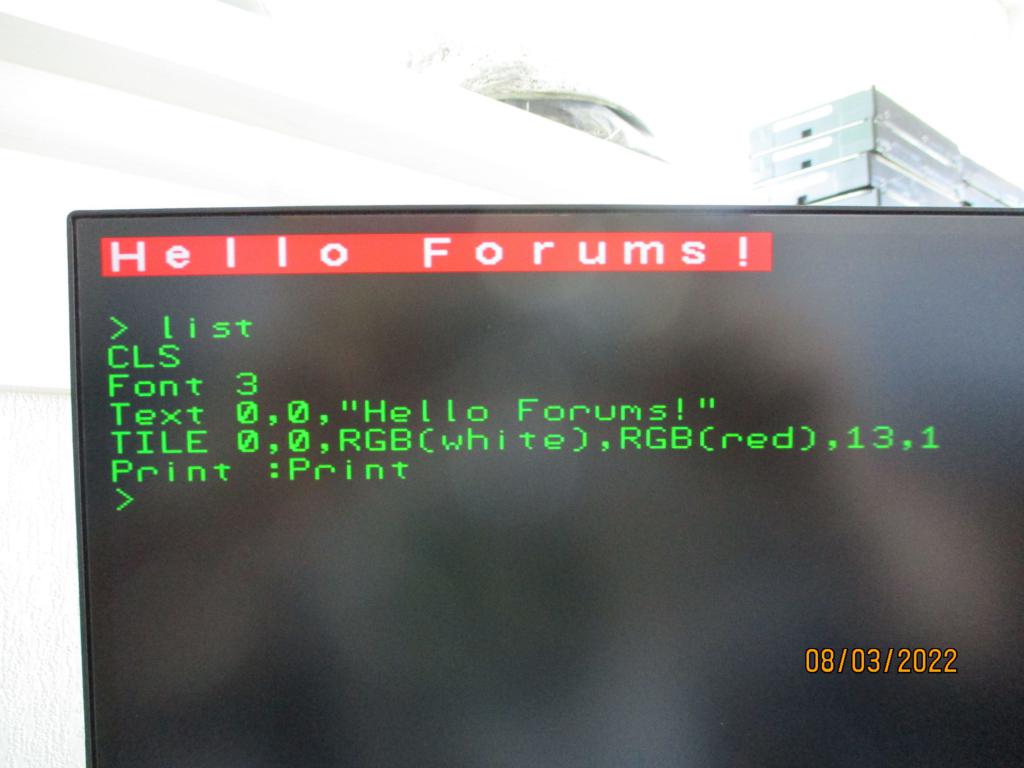

I think that is by design, Geoff, as with this new feature, the PM output IS still mono as far as the PIO and 2nd core are concerned.
Peter mentioned in one of his earlier posts, that the colour thing is being done in the driver, and that the 640x480 mode still thinks the screen is monochrome.
That's why that error pops up - to remind you that you are effectively still in monochrome mode.
To change the colour of the text, you first write the text to the screen(after setting the default foreground/background), and then use the TILE command to change the colour of the text/background at any one point on the screen.
When the TILE command co-ordinates are the same as the text you just wrote to the display, then the text colour changes at that point, but not via the TEXT command.
That's how I understand it, anyway.
EDIT - Like this:
Edited 2022-03-08 11:00 by Grogster
