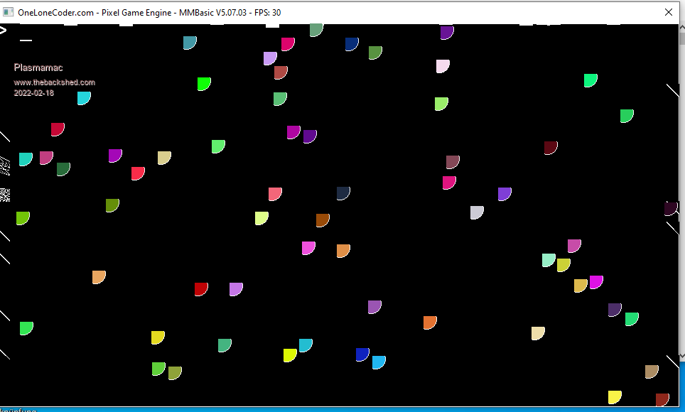

test your "atomsprite demo"
frame problems
if box disabled all looks ok
option explicit
option default none

  Quote  frame problems
Thanks for the report - found it and will fix in next version
