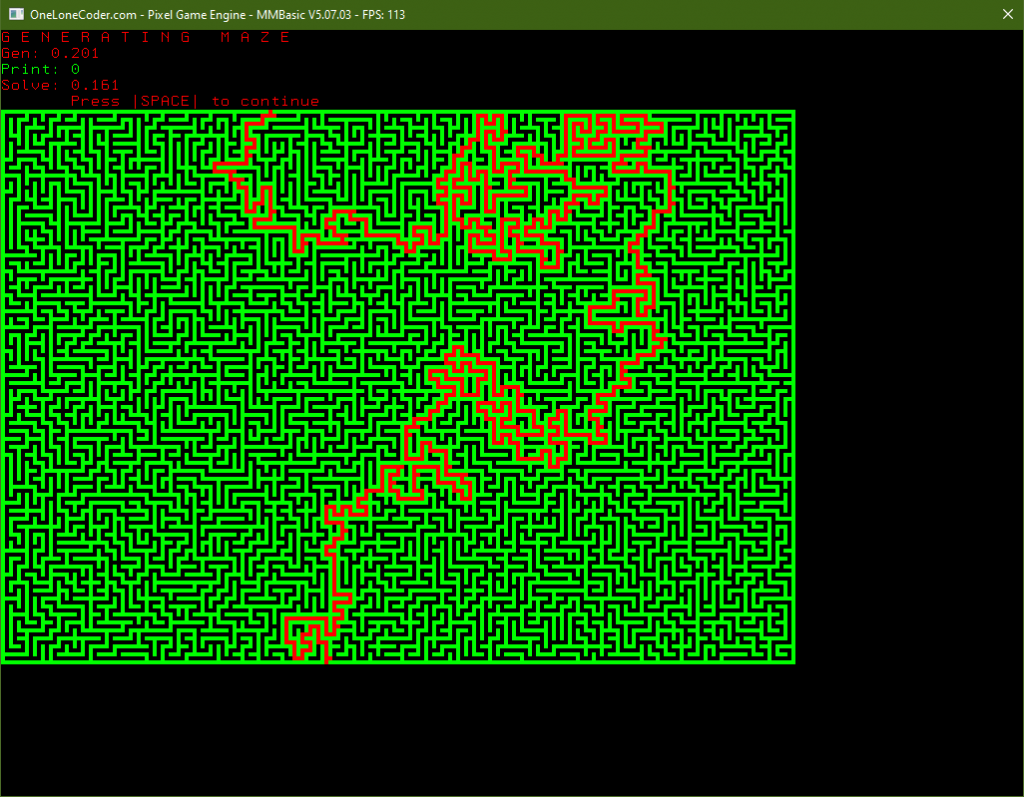

I'm impressed on you speed of coding and your results. I took Mazist and broke it down to the essentials of generating a maze, printing it to screen and the using the mouse solve routine - couldn't use the original Mazist as it uses commands unknown to Windows MMBasic such as TEXT, MATH SET, GUI CURSOR and MAP commands. Each routine was timed and then I ran the same program on my MM2 to see the difference. My PC is an old I5 and only scores 185934 grains on KnviD's Benchmark.
Maze size 99x69 nodes
MM2: Generation: 1.8-2.7 seconds
    Print: 0 seconds!
    Solution: 1.55-2.33 Seconds
PC:  Generation: 0.2-0.28 Seconds
    Print: 0 Seconds!
    Solution: 0.16-0.18 Seconds
Near enough to 10 times the performance for these routines. I'm looking forward to future developments.

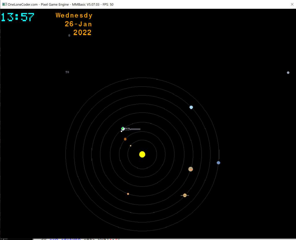

good job Pete
I give my graphical test program
Testgraf.zip
it seem that "Text" function is not activ
"Stars" function don't work correctly

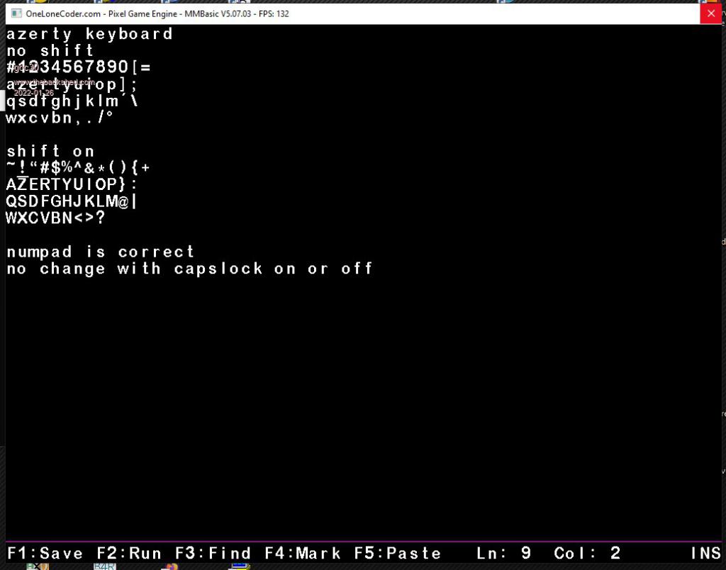

my azerty keyboard
each line is same as each keyboard key line

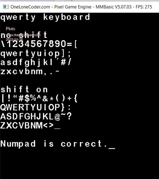

Peter, this is what i get with qwerty keyboard. Not sure in what format you need to have it.
