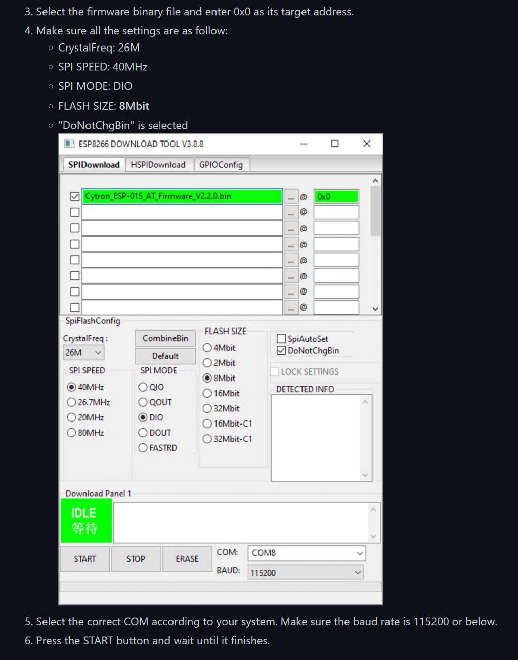

Peter
Have a look here *Custom Compiled ESP-AT Firmware Binaries*
  Quote  These are the AT command firmwares for ESP8266 compiled from Espressif ESP-AT Source Code.
The firmwares have two different sizes:
   Cytron_ESP-01S_AT_Firmware - For ESP8266 with 1MB flash size (eg: ESP-01), doesn't support OTA update.
   Cytron_ESP-12F_WROOM-02_AT_Firmware - For ESP8266 with flash size 2MB or above (eg: ESP-12E, ESP-12F, WROOM-02).
It has links for a simple ESP flash tool with instructions and there is only 1 binary to flash
This is the espress gitgub page with more information including the roadmap
These are the AT commands
***The next version of ESP-AT firmware (v2.4.0.0) is planned to be released in March 2022. At present, only ESP32-C3 series firmware is planned to be released, and ESP32-C3 firmware would support Bluetooth LE 5.0.***
This should do what everyone wants? and be easy enough to use?
And once it's flashed it can be updated over the air {if neeeded}

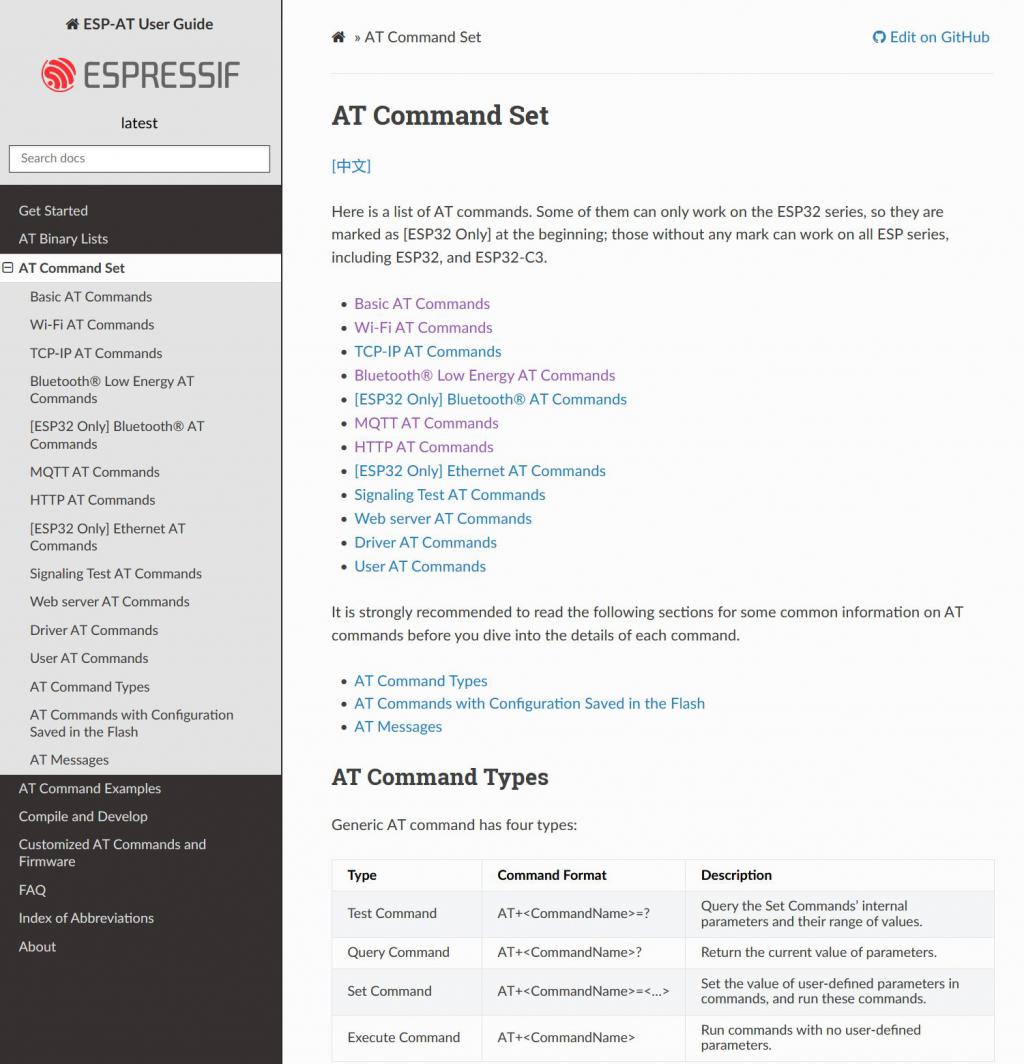

Full AT command set
This page has the official EspressIF binaries for the various ESP chips along with the flashing tool

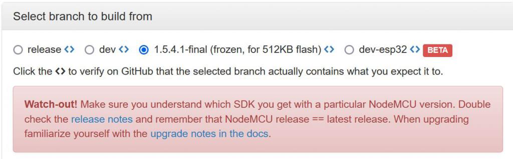

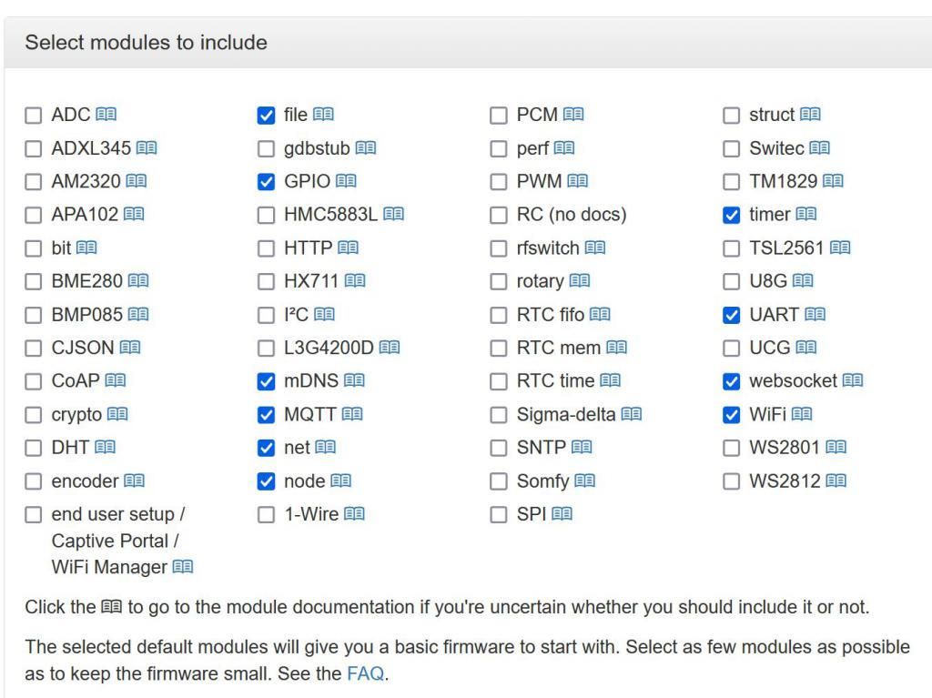

I totally understand, but for anyone interested I found this
Which tells you how to simply and easily make your own binary with only the actual modules you need using the NODEMCU page HERE
You simply select which branch you want to build your binary from, select and it builds it for you online.
The 512K branch is for the ESP8266-01 with memory of less than 1Mb (most of the early ones released)

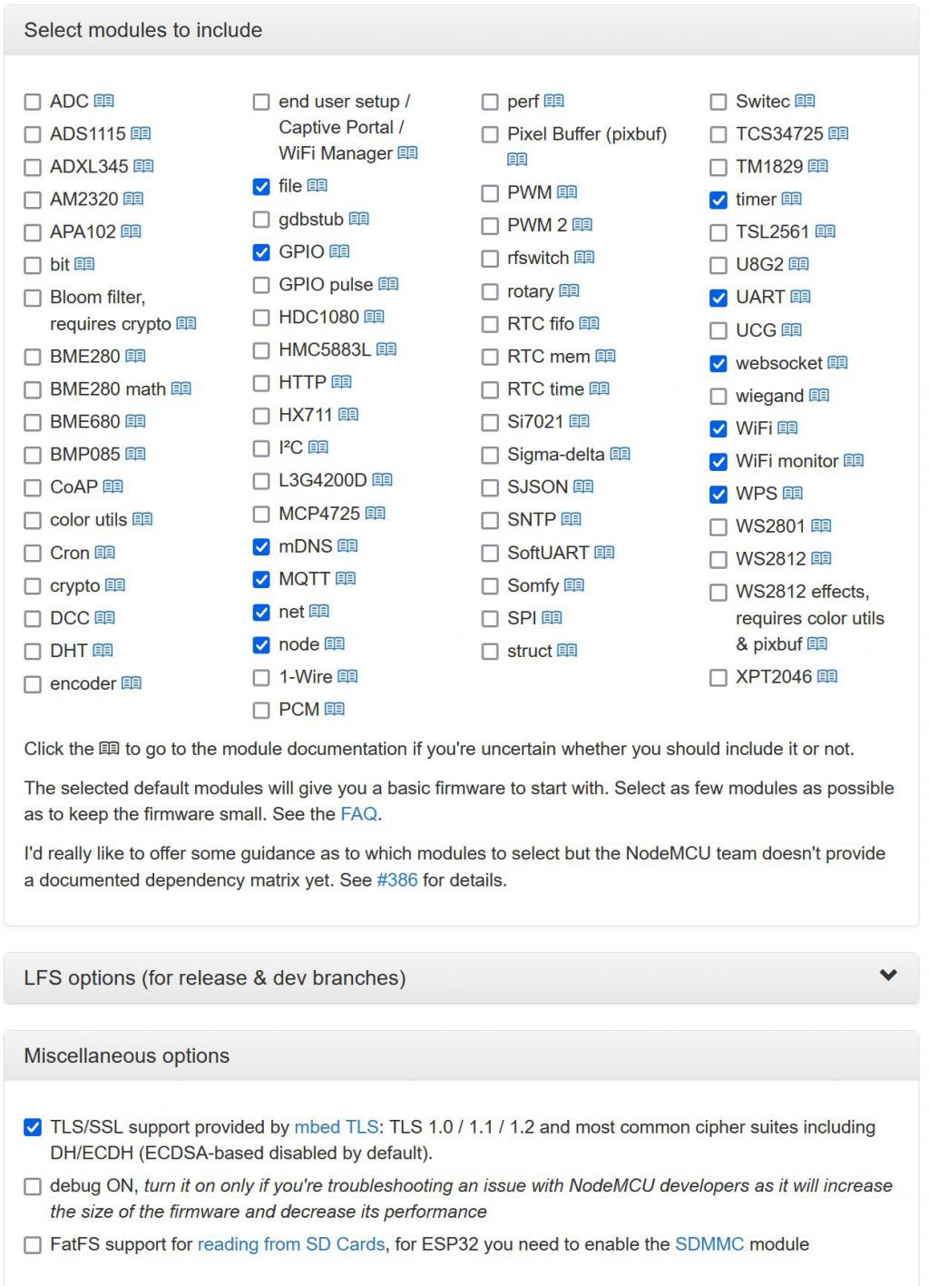

This is the full list of modules you can select, you just pick the modules you want
It might be of use to anyone that has or wants to use any of the ESP modules from 8266, 8285, esp32 wifi mqtt (still no idea what that is) or other things
This way you're using your own binary that has only the actual modules you want/need in it
The only issue is it doesn't use the AT command set but is NODEMCU
it seems easy to use but I can't say, it does however look like sending commands to it from any MM device would be really simple

Posted: 05:50pm 20 Jan 2022
  Quote  make your own binary with only the actual modules you need using the NODEMCU page HERE
I have built NodeMCU binaries a few times at various times using the online builder and never got it to work reliably despite trying different ESP8266 modules etc. Lots of crashes/reboots. Same hardware was rock solid using Arduino IDE so I gave up on NodeMCU. I think the NodeMCU firmware overhead was too much for a resource limited device like the 8266.
I was looking for a tiny ESP32 module with through hole header pins like the ESP01 but couldn't find one. Is there a ESP32 version of ESP01?

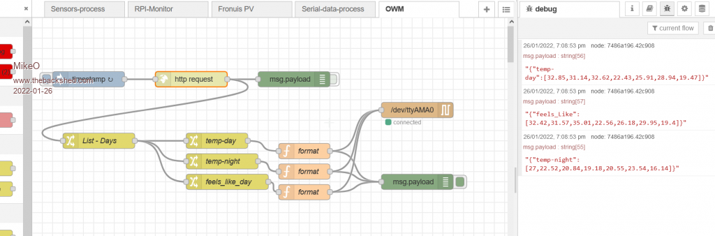

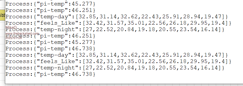

Been experimenting with my Raspberry Pi - Picomite combination. Raspberry Pi (could be a Pi Zero W)running Node-Red works extremely well parsing HTTP "Get" to APIs in this case OpenWeatherMap. This makes all types of Network/Internet comms possible (HTTP, MQTT, UDP ) etc. In this case I did a HTTP request to OWM as a 7 Day Forecast request and I have just selected a few nodes to send to the Pico. Here is screenshot of the "Flow" (Node-Red speak) and the received data on the Pico.
Edited 2022-01-26 18:33 by MikeO
Codenquilts
Posts: 9329
Posted: 08:53am 26 Jan 2022
That's so pretty - but completely beyond my comprehension. :)
I may have to go and lie down in a darkened room now...

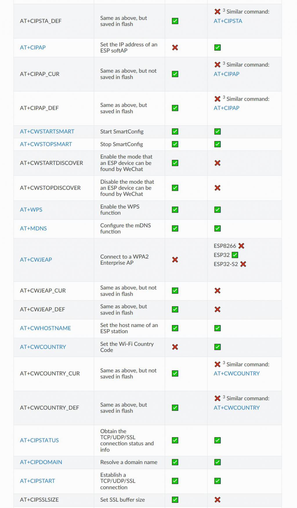

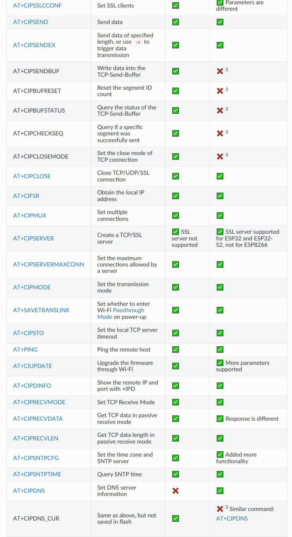

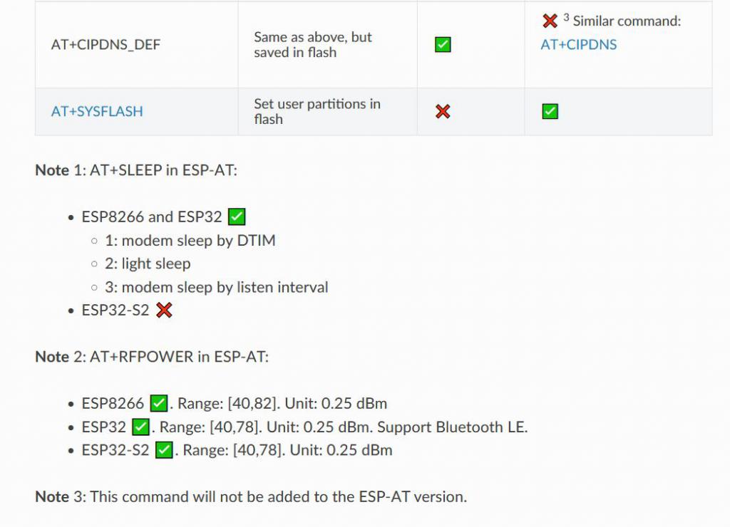

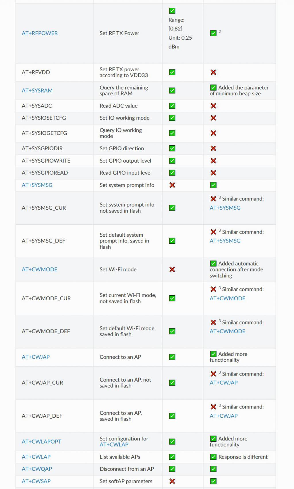

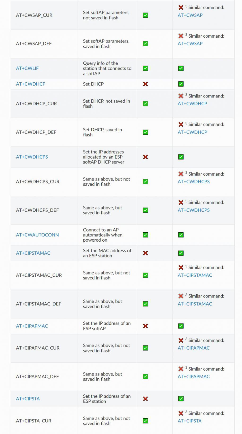

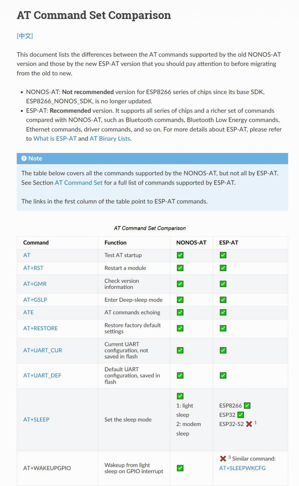

ESP8266 flashed with the AT command set
From what I can see it has the full AT command set installed
IF I can find an ESP8266 and a programmer I'll try flashing it with the firmware which can be downloaded here and see what commands actually are installed
This firmware is for the 1MB and doesn't support OTA
This image is for the larger ESP8266-12
I think I might have got rid of the programmer though so if anyone else has an ESP8266 and actually wants to try it?
For those with the 512K esp8266 here's a link to the last version of Espressif's 1.74 binary for that one
