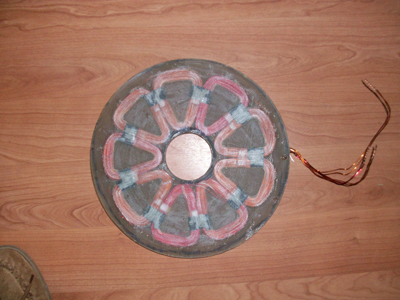

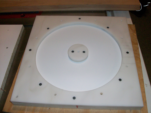

Followed Ed's directions and made my forst stator. It turned out very nice. I used a piece od corian for the mold and the top and bottom is made of 3/4 melamine. Next is the magnet plates. probably this weekend. Thanks to Ed.

That turned out looking good, very neat work. Keep us posted.

looking pretty good so far.
This looks like a 12 magnets per rotor 1"x2"x0.5" block design. This has 24 cu in magnet volume. It will be interesting to compare notes, as my new AxFx unit will have the same magnet volume, but with round disks, and 8 magnets per rotor with 24 cu in total magnet volume. I will have round coils as well, and only 6 coils. The wiring tails on my unit will come out in the centre. It is probably too late for you, but I will be moulding in flexible wiring tails to my new AxFx stator. What will the magnet rotor separation end up to be?

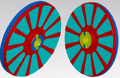

I'm not sure how far to put the magnets away from the coils, I was thinking between .02" and .03" on each side. I've included the CAM program picture for how the magnet plates look. The magnet plates are 8.25' amd the stator is 11" so there is 1 3/8" on each side to mount the stator to the mill frame. The magnets are the wedge type and I'm going to cut the face of the plate .02" or .03 deep to position them where they need to be. The hole through the plate is 24mm and I like the slot and tang to keep them aligned with each other. The programs are written, now I'm just waiting for the machine to open up so I can make them.
this is only the magnet side program, the other side will be turned down and set screws will be added. Also on the small diameter of one of these plates there will be drilled and tapped holes for assembly purposes to jack the plates into place (2000 lbs of pull is not easy to keep apart).
I'll post the real pictures of them as soon as I make them.

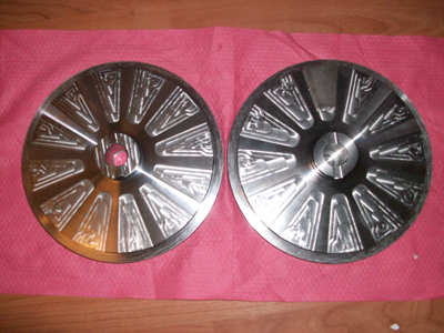

Posted: 10:57pm 08 Feb 2009
Ran the first side of the magplates today. After messing with the program I got them both done. The back side still needs to be turned down and drilled and tapped but this side is the harder side to get done. It is nice having the 4 axis dual spindle live tooling turning center at my disposal (it's the machine I run at work) and having the opportunity to use it when no one is around. The plate on the right side has 1 magnet in place. Now to finish it and assemble everything. There is .03" of clearance on both sides
Gary

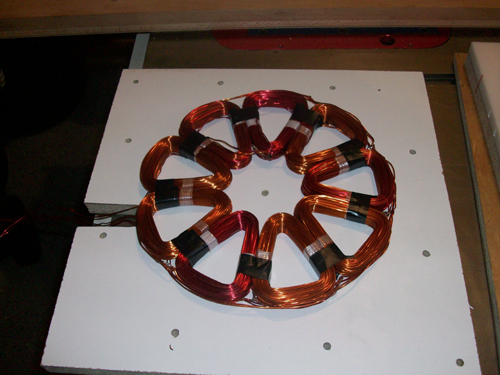

Posted: 01:25pm 14 Feb 2009
Here is the winding jigs I made to wind the 2 strands at a time for the coils.
The scary part to me is assembling the mag. plates. I know Ed says to put some 3/4 wood spacers between the coils and the last mag. plate you slide over the shaft.

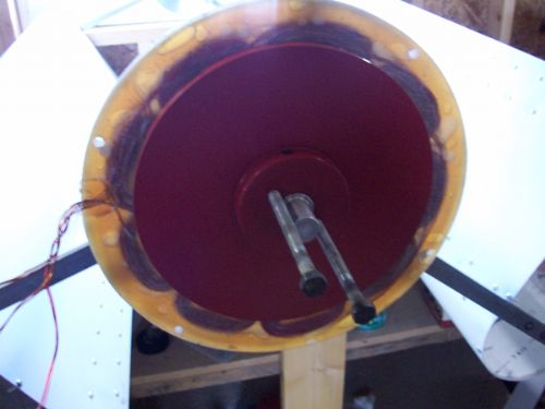

Posted: 03:38pm 01 Mar 2009

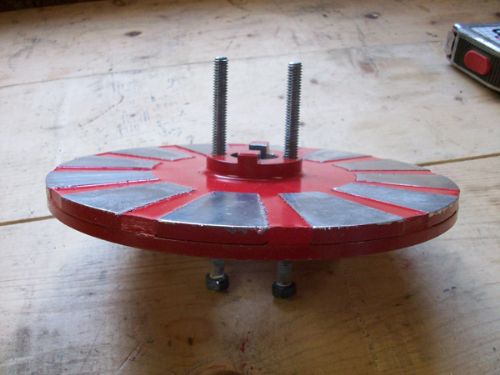

Here is a couple of pictures of the jacking system I integrated into the design of the magnet plates
with this system I can try different stators because I can very easily seperate the plates
Gary Johnston
