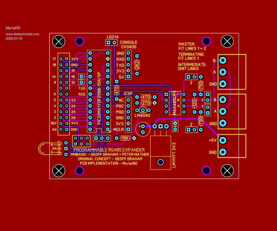

Here's a 16 IO version using hardware DE and pluggable terminals. There's space for a data loopthrough now, but not for the 5V. Of course, you aren't supposed to do multidrop usung loopthrough terminals as unplugging one node kills everything after it. :) These terminals make it easy to connect/disconnect as the actual terminal is outside the box. Note that the pins are 1mm sq and on 5mm centres so fixed terminals might also fit the board.
I don't like not having 5V on the same connector, but my usual supplier doesn't stock 4-pin horizontal sockets. It would work well with 2-pair cable with no screen needed. 3-pin really needs single-pair screened and you still need to provide external power.
I'm not bothered about the firmware for MODBUS - I won't be writing it. :)  I have had a bit of a read up on CRC generation and checking though and it looks a right pain in the backside, even if you've finally decided on which of the 500 incompatible versions you prefer. One of those things that was originally designed to be done in hardware, not software.

OOPS! DE should either be inverted (add a transistor) or have a pull-down resistor if it's being handled in software.
Edited 2022-01-10 18:41 by Mixtel90

Posts: 9329
Posted: 09:12pm 10 Jan 2022
I've done another pcb move round of the RS485 version.
Terminals are a 2-pole for 5V & GND and 3-pole for A, B & GND. It should be possible to fit either fixed or pluggable terminals. Looping through the pluggable terminals would allow disconnection without breaking the chain. Alternatively a lead to a DB9 plug could plug into a loop-connected terminal box & power supply.
I've also rearranged the terminating resistor links so they are accessible externally if required or can be kept internal.
I've had a thought on the MODBUS address and come up with this: Initially all devices have the same address. To commission, connect a single unit and write a value (the address) to a dummy analogue port. The firmware should recognise this port and store the value in an address register. On power up it should compare the address register with the default value and, if it is different, use the register as the address. It could also be written so that the IO won't work when using the default address, so devices have to be commissioned before they can work. I'm not sure how you could reset a commissioned device to it's default address if you didn't know it's address. That would probably have to be done via the console.
