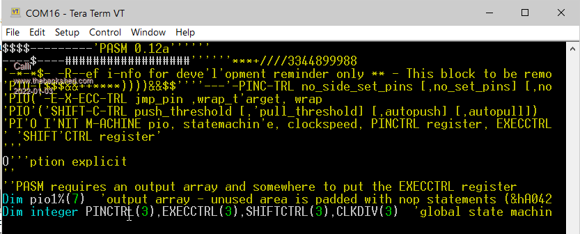

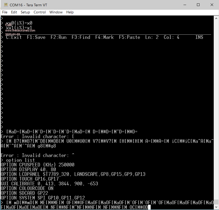

Posted: 11:32am 03 Jan 2022
V5.07.03RC5
I just found that using the mouse wheel or clicking in the Tera-Term window will produce strange random characters in Editor and console.
I did experiment with Option Console LCDPANEL. But it stays after reset.
After "Reset Console" it works on console, but as soon as I enter the editor it comes back.
Test on 5.07.01b2 shows no problems!
Cheers,
Carsten

  Quote  I just found that using the mouse wheel or clicking in the Tera-Term window will produce strange random characters in Editor and console.
The editor allows you to position the cursor using the mouse when using teraterm. This is the only function supported. For some reason other mouse commands are comming though and as they are not understood generate rubbish. This functionality is standard across all the Micromites. I think the problem may have been caused when I supported some alternative escape sequences to keep the Linux brigade happy (I hate Linux) since they don't have a proper terminal program like teraterm. I'll see if I can diagnose the problem. I may have to disable the mouse positioning to fix.
Posted: 02:28pm 03 Jan 2022
http://geoffg.net/Downloads/picomite/PicoMite_Beta.zip
PicoMite/PicoMiteVGA
V5.07.03RC6
Fixes bug in GUI BITMAP when using monochrome displays
Fixes bug in handling of mouse escape sequences in the editor introduced in 5.07.03b1

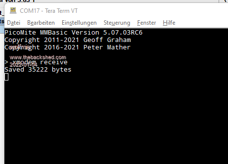

after xmodem receive pico hangs up completly.
i have to clear flash and flash RC6 again.
Edited 2022-01-04 02:12 by wolfme
Posted: 04:16pm 03 Jan 2022
  Quote  after xmodem receive pico hangs up completly.
Just tried it with a 72K file and it worked perfectly. Possibly something odd in your file. If you have an SDcard connected try XMODEM r "filename" then LOAD "filename". Do you have autorun set?

wolfme
Joined: 26/10/2021
Posts: 43
Posted: 05:05pm 03 Jan 2022
No options set, no devices attached. Only pico, nothing else.
I tried the new zip, but no success.
Upload worked with RC1
