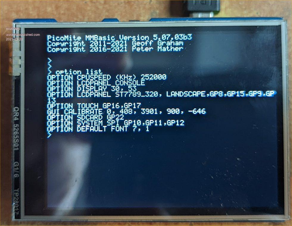

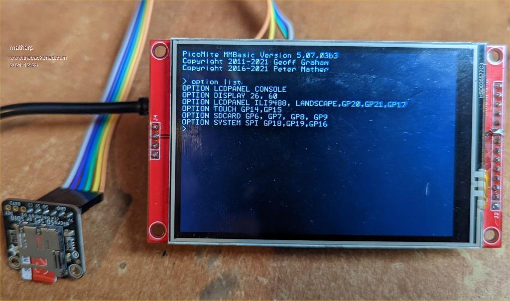

Posted: 02:22pm 27 Dec 2021
http://geoffg.net/Downloads/picomite/PicoMite_Beta.zip
PicoMite and PicoMite VGA
V5.07.03b3
When first loaded this version will force a complete flash wipe removing all options, saved variables, and any programs stored in flash
This takes a few seconds after loading the firmware
BACKUP ANYTHING IMPORTANT FIRST.
Structural change so there is now a single codeset for PicoMite and PicoMite VGA Edition with a single DEFINE selecting the relevant code where required. Full updated source available on Github . Note to whoever requested it. Harmonising the source made it sensible to allow console mode on the PicoMite as well as the VGA Edition. So you have PS2 keyboard and LCD console but see warnings below.
Fixes bug in BACKLIGHT 0
Maximum CPU Speed now 252MHz
Reading from the framebuffer now available and bug fixed on ILI9341, ST7789_320 and ILI9488 (For ILI9488 this works only if MISO pin connected in which case touch and SDcard will not work but touch CS pin must still be pulled high)
This enables the following on these displays:
PIXEL(x,y) function
SAVE IMAGE command
Transparent text
BLIT
OPTION LCDPANEL CONSOLE [font] [,foregroundcolour] [,backgroundcolour] [,backlight]
OPTION LCDPANEL NOCONSOLE
Syntax is identical to MM+
NB: as these displays are SPI connected some things work very slowly.
Edit is usable.
AUTOSAVE, LIST and PRINT are very slow if the text forces the screen to scroll
PRINT @(x, y [,mode])
OPTION LEGACY ON/OFF is a temporary option to be used in a program. It affects the following commands
COLOUR - uses colours 0-7, see original colour Maximite manual
PIXEL - see original colour Maximite manual
LINE - see original colour Maximite manual
CIRCLE - see original colour Maximite manual
OPTION DEFAULT FONT removed from VGA version. Use OPTION LCDPANEL CONSOLE.
CONSOLE can now be disabled (OPTION LCDPANEL NOCONSOLE) on VGA version. This allows a program to write diagnostics to the USB/Serial console without affecting the VGA screen display
NB: for VGA Edition OPTION SYSTEM SPI is not implemented. To enable an SDcard use:
OPTION SDCARD CSpin, CLKpin, MOSIpin, MISOpin. This allows complete flexibility over the pins chosen which do not need to be valid SPI pins
This syntax is also useful for the ILI9488 display when MISO is connected to allow SDcard use with this display by connecting the SDcard to different pins from the display
Edited 2021-12-28 00:23 by matherp

Posted: 06:18pm 27 Dec 2021
Hi all Guru's
it is very nice to see what and which data is displayed on the ILI9488. But is there for a newbie like me the information too, how to come to such representations, e.g. circuit diagram, program or procedure? I am a little bit overwhelmed by all these new features.
I would find it nicely, if the guru's would have the newbies in the mind, too.
Sorry for my rebellion.
Greets
Wolfgang
Posted: 06:28pm 27 Dec 2021
The wiring for the ILI9488 is exactly the same as the ILI9341 in the manual. Then you merely need to substitute the pins you use in the list of options shown in the picture and the display will act as a console device.
Note: as has been discussed many times, there is a H/W bug in the ILI9488 controller chip which means it doesn't release the MISO pin even when it is not chip selected. This means that the SPI bus can't be shared with the touch controller or an SDDcard.
Some people don't connect the display MISO pin in which case touch and the SDcard will work but then you can't read the display framebuffer so BLIT, transparent text and console mode can't work.
Basically this is a flawed display. The ILI9341 and the Waveshare 2.8" ST7789 display both work without issue and share the SPI bus properly.
I think the console mode on these small SPI displays is pretty much useless but it has been requested repeatedly and in harmonising the code with the VGA variant it was easier to include than exclude.
Note also, Waveshare also sell a 3.5" ILI9488 based display. This is wired without MISO  so can never be used as a console display but does work nicely with touch and SD support

Regarding the MISO. Wasn't there an option the use a resistor in series with the pin to allow it to work?
