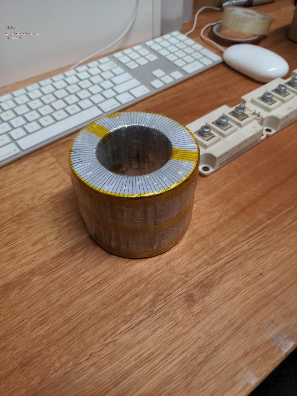

Thanks for the calculation Tony! I met with Klaus yesterday and had a look at his amazing Warpinverter and he gave me lots of tips on winding. He suggested going as up to 1.7mm for hand winding. That is 2.27mm2 so good for 9 amps. I could wind 3 layers for the primary which would get me to 27 amps, is that close enough since at 40v I would need 28amps (not that the battery will get down that far)?
I went through my box of transformers which are all in the 300VA range. I stripped one down today and it's core is OD=102mm,ID=60mm and a height of 40mm. Since I have multiple of these already I thought I could double stack the cores for transformer 3 which would give me 16.9cm2 core cross section area. So 107 primary turns and 67 secondary turns. I could get away with 1 layer of 1.7mm for the primary although that would give me just under the 9.3 amps I was aiming for.
Using 1 of these cores for transformer 4 I would need 643 primary turns and 134 secondary. The existing winding is 0.8mm wire so only good for about 2 amps, should I go up to 1mm since I would need 3.1amps at 40v? Fitting in 3 layers of 134 turns of 1.7mm won't work as I will run out of room. What if I double stack this core as well? Gets me down to 322 primary and 67 secondary which will give me more room to work with?

  Quote  I stripped one down today and it's core is OD=102mm,ID=60mm and a height of 40mm. Since I have multiple of these already I thought I could double stack the cores for transformer 3 which would give me 16.9cm2 core cross section area. So 107 primary turns and 67 secondary turns. I could get away with 1 layer of 1.7mm for the primary although that would give me just under the 9.3 amps I was aiming for.
That all looks spot on.
Transformer 4
Yes, the cores are not that large, and double stacking reduces the turns count by half which makes it a lot easier to wind. Its still a lot of turns to put on though !

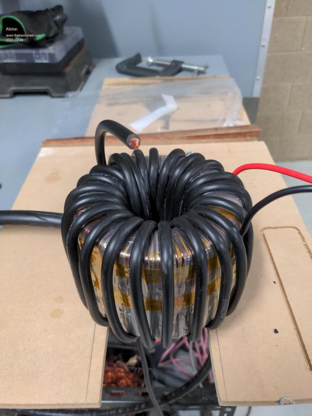

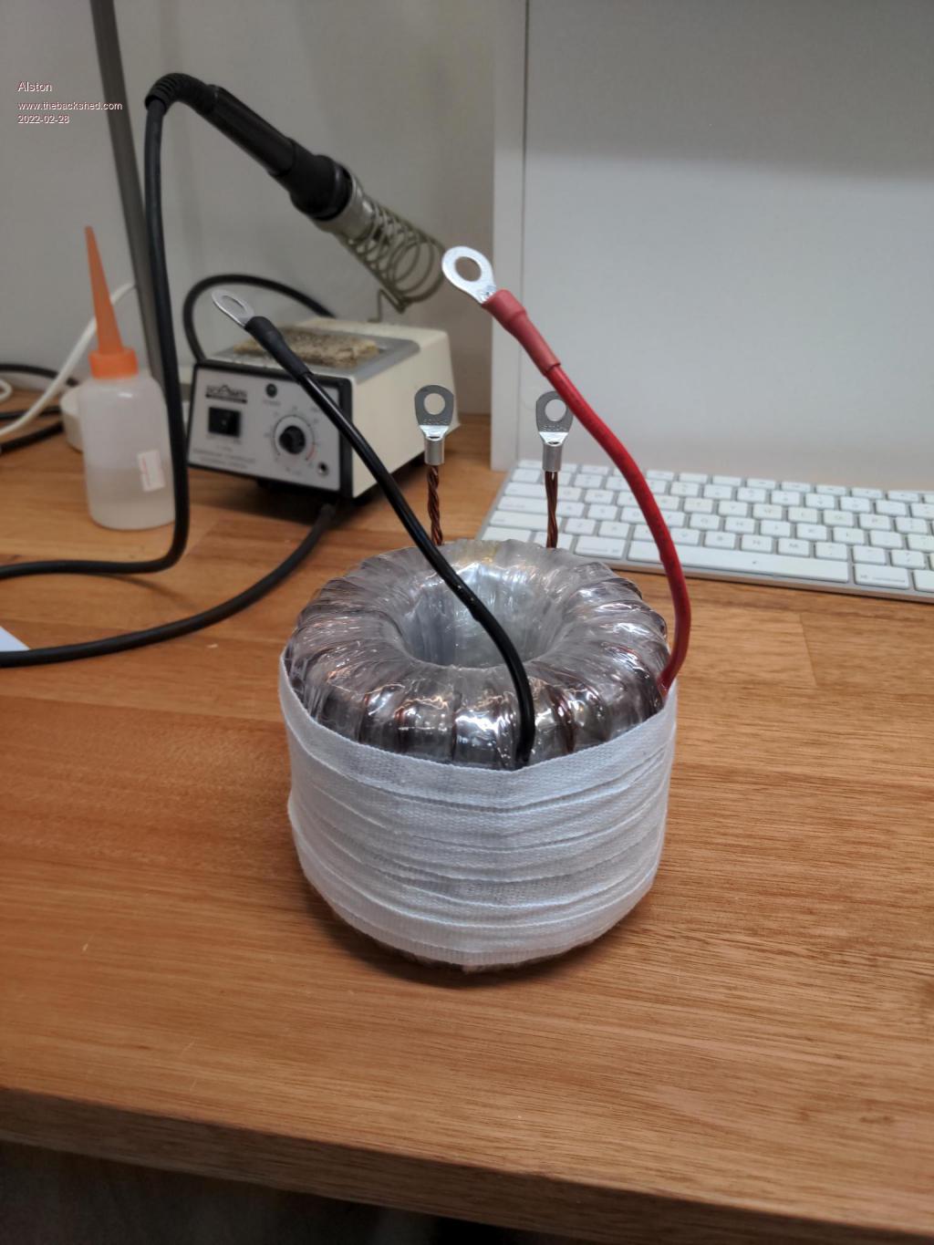

Well after having a paid project come up I am back to winding transformers. I have finished transformer 4 aside from coating the fabric tape on the outside with epoxy. To start with I printed out templates for my primary windings and stuck those on the ends which made life much easier. Although Klaus warned me about the difficulties with using standard high current cable for the secondary I still had to try it myself to see how calculations and the real world don't line up. I was able to use all of the 1.3mm wire that I unwound and twisted it like Klaus to make my secondary which worked nicely.

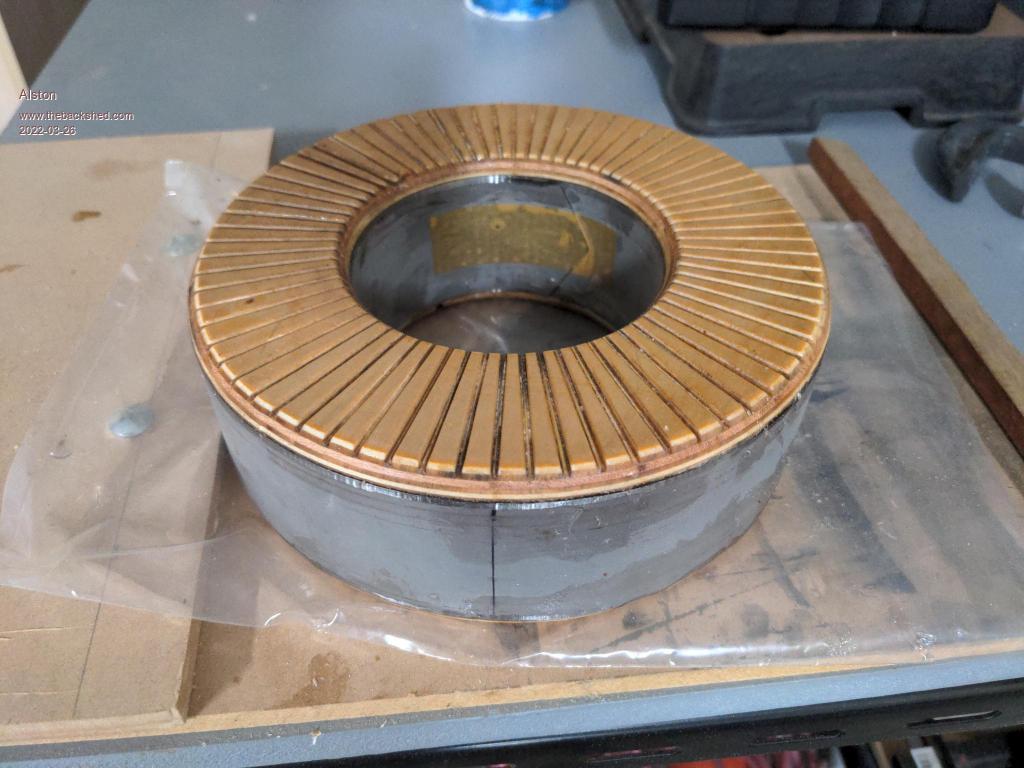

After looking at Roger's recent post with his incredibly wound transformers I was given an idea to use my CNC machine to cut the template onto the plywood endcaps. I have made the end cap for transformer number 2 which I will now start winding. I really need to find out where Klaus got his better quality plywood from as the stuff Bunnings has is junk, it doesn't machine very cleanly.

Hi Alston, looks great.
Plywood comes in better quality at a price. Marine grade ply would probably be better, but it is more expensive.
Other than that using some fibreglass sheet ( used in large electric motor winding and former manufacture) would be even better.
I don't know how hot your transformer core would get, I have thermostats in my inverters that turn on the fan if the transformer outer gets above 40 degrees C.
How hot the core gets is another matter.
Good luck. As far as insulated cable for the primary goes, I would mine with what I had which was some left over 6mm Solar Panel cable. I used 6 cables in parallel for my 24 volt 8010 based inverter and it is working great.

Agreed, that looks awesome. Having the slots cut all the way across is perfect and I'm sure is even better than just grooving the edges like I did  ...  should keep the wire perfectly alighned.
I always worried about on what face to angle across to the next slot  ...  but I don't think it really matters whether it is on one of the ends or on the inside or outside.
Having the first layer well laid out makes such a difference to the following layers and I feel that really is the secret to a neat transformer.
I had wondered about 3D printing the end caps, but was worried about the print melting and perhaps decomposing to some degree. I've seen some horrible gooey messes when various materials start to break down with heat, age and chemicals  ...  so I dropped that idea altogether.
My plywood came from Bunnings too, but because I only filed little grooves into the corners/edges, it wasn't much of a worry. I did end up painting them with the epoxy resin that I used to glue it all together with, so it has some protection  ...  and ended up nicely sealed and smooth.
I assume you are planning on fitting some insulation around the core and inside it too?

Well I have put the first layer of windings on and the slots definitely help alot. I still don't seem to be able to get it as perfect as yours Roger! I also coated mine in epoxy as per Klaus's instructions. I have fitted insulation on the inside and outside of the core, the photo above was take just after the epoxy dried.

  Alston said   I also coated mine in epoxy as per Klaus's instructions. I have fitted insulation on the inside and outside of the core, the photo above was take just after the epoxy dried.
That's good, I was wondering what type you might use, or whether you might just use epoxy.
