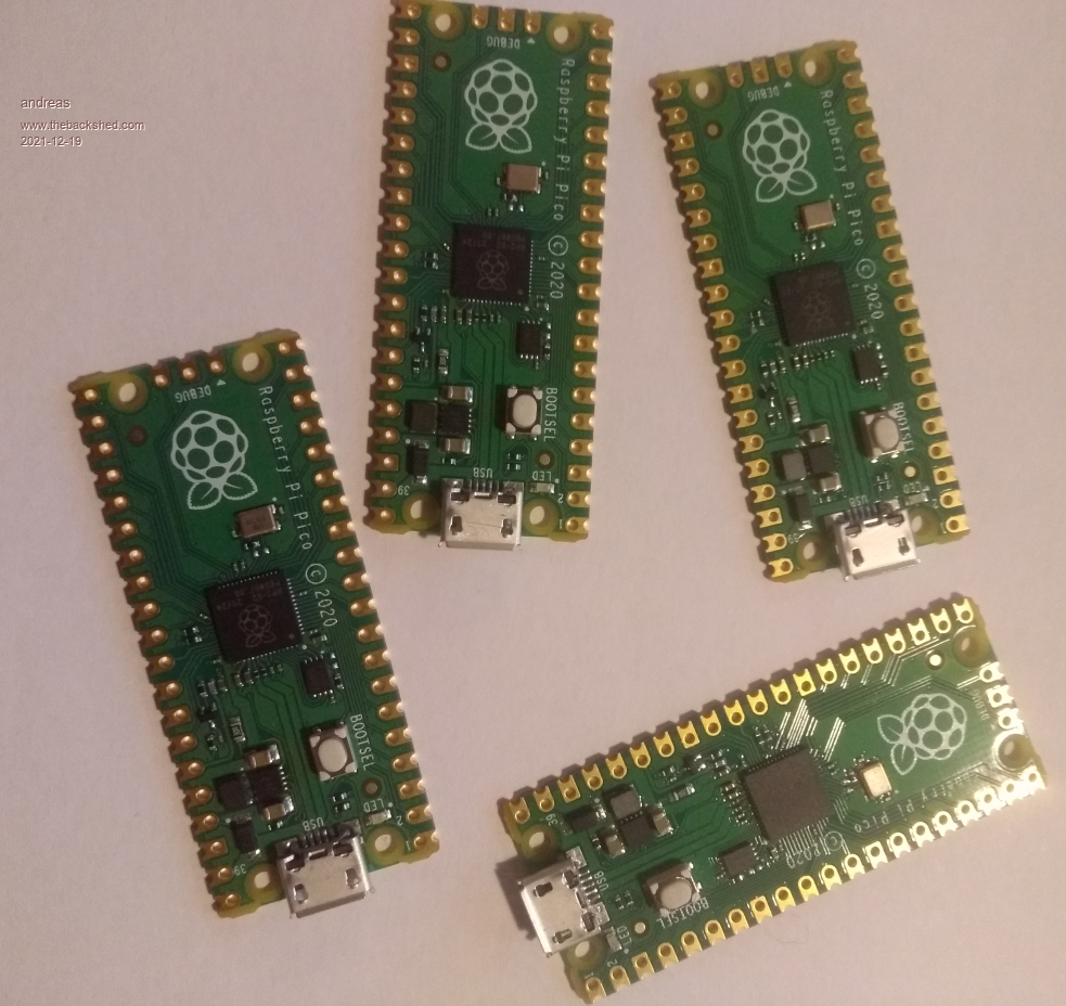

Now I have tested 5 different Picos, all processed the same way:
1. Cleared the flash: Clear_flash.uf2
2. Installed Picomite: PicoMiteV5.07.02b1.uf2
3. Started minicom 2.7.1 (my host = debian linux)
4. Started: XMODEM RECEIVE on the pico and pressed Ctrl A+S to start a transfer
5. Selected: Upload xmodem
6. Selected the "running mean.bas" and started it after transfer to the pico
The results are here   :

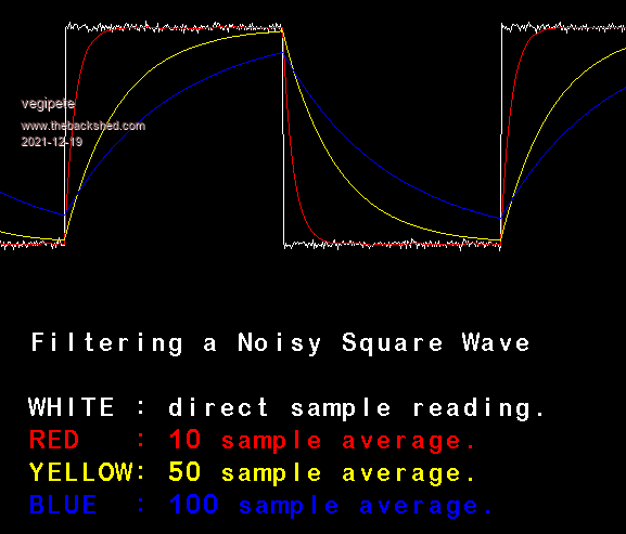

Posted: 01:55am 19 Dec 2021
Since everyone likes pictures, here's a version for the CMM2, filtering a noisy square wave.
' Filter Test for CMM2
' written by Vegipete
' Uses running mean algorithm presented by Andreas

text 50,400,"Filtering a Noisy Square Wave",,3
text 50,460,"WHITE : direct sample reading.",,3,,rgb(WHITE)
text 50,490,"RED   : 10 sample average.",,3,,rgb(RED)
text 50,520,"YELLOW: 50 sample average.",,3,,rgb(YELLOW)
text 50,550,"BLUE  : 100 sample average.",,3,,rgb(BLUE)

 reading = RandGauss(32) * 40 + square
 ' calculate new averages
 inc average_10,  (reading - average_10 ) / 10
 inc average_50,  (reading - average_50 ) / 50
 inc average_100, (reading - average_100) / 100
 blit 1,50,0,50,MM.HRES-1,300  ' roll to the left
 line MM.HRES-1,0,MM.HRES-1,MM.VRES-1,1,rgb(BLACK)  ' clear
 ' plot graph
 line 798,old_reading,799,reading,1,rgb(WHITE) : old_reading = reading
 line 798,old_ave_10, 799,average_10,1,rgb(RED) : old_ave_10 = average_10
 line 798,old_ave_50, 799,average_50,1,rgb(YELLOW) : old_ave_50 = average_50
 line 798,old_ave_100,799,average_100,1,rgb(BLUE) : old_ave_100 = average_100
 inc count  ' generate square wave
 if count > 200 then
   count = 0
   square = 100 + (square = 100) * 200
 endif
loop
function RandGauss(samples as integer) as float
 local i,s
 for i = 1 to max(samples,4)
   inc s,rnd
 next i
 RandGauss = s / max(samples,4)
end function
Posted: 07:51am 19 Dec 2021

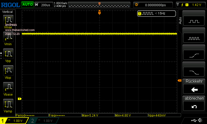

Hello,
thank you for all the good tips!
Today I looked at VBUS the power from the USB cable comming from the PC which powers the pico. Peter told me that "You would see a change in temperature of over 4C for a small 1% change in reference voltage".
I can see that the VBUS is not only changing by 1% but by 8.8% (440mV). The hihgest voltage is 5.24V and the lowest 4.80V. This explains all the problems I have with pin(temp) if it is based on this power supply.
Lesson learned: A computer is not a good voltage reference when doing measurements!
So the solution seems to be to get a reliable, stable power source (possibly by battery?), before doing any measuremnts.
-andreas

VBUS is the 5v supply from the USB. The reference voltage for the ADC is taken from the 3V3 line, fed from the SMPS. Because of the SMPS variation on VBUS or VSYS makes very little difference to the ADC reference.
Schematic
There is some filtering via C13 but variation on 3V3 still gets through. Have a look at the signal on VREF.
andreas
Joined: 07/12/2020
Posts: 226
Posted: 02:10pm 20 Dec 2021
  Mixtel90 said  VBUS is the 5v supply from the USB. The reference voltage for the ADC is taken from the 3V3 line, fed from the SMPS. Because of the SMPS variation on VBUS or VSYS makes very little difference to the ADC reference.
Schematic
Do you mean pin 35?
  Quote  ADC_VREF is the ADC power supply (and reference) voltage, and is generated on Pico by filtering the 3.3V supply. This pin can be used with an external reference if better ADC performance is required.
I suppose this is a test point or output, but not an input for an external poser supply, correct? Or does "an be used with an external reference" mean that I put in some external power supply?
Btw. my external power supply has a "ripple" of some 80-120 mV (mostly 80 mV).
But I have some MCP1700 3.3V power regulators here, which I could use together with an 10uF elko to create a 3.3V reference.
-andreas
